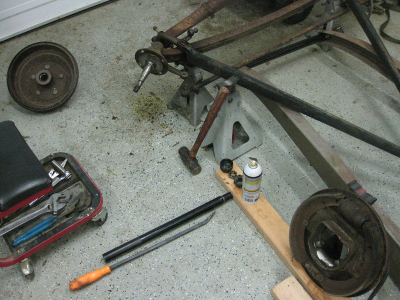

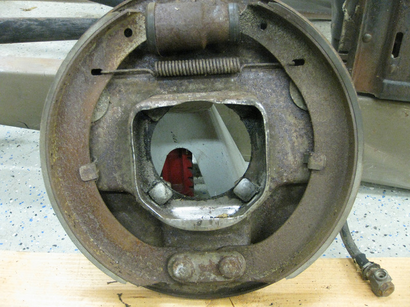

    Hey y'all,
    Got a little bit of an update. Tonight I decided to tear into the '40 front end I picked up. First thing I noticed is that I will need new kingpin bushings since there's noticeable play. When I have Okie Joe bend me an axle, I'll ask him about this. I also plan to have him bend my spindle arms to match the 4" drop. Yeah, I could do it, but it's cheap enough and I understand he does a very thorough job.
    Anyway, here's some pics as I tore down the axle/brakes. Overall, things looked pretty decent, but I'm no drum brake expert so if you see anything out of the ordinary, let me know.
    I wasn't sure how to get the spindle and kingpin separated, but now I know I need to get this wedge bolt out and then hammer the kingpin out from underneath.
    And how it looks as of tonight. :) I'll try to get the rest torn down over the weekend.
    I'll get the drums turned (as little as necessary), get new shoes, pick up new bearings (although these do look pretty good), pick up some new hardware, and begin re-assembly after I get the new axle. I still need to pick up a wishbone splitting kit and get going on that.
