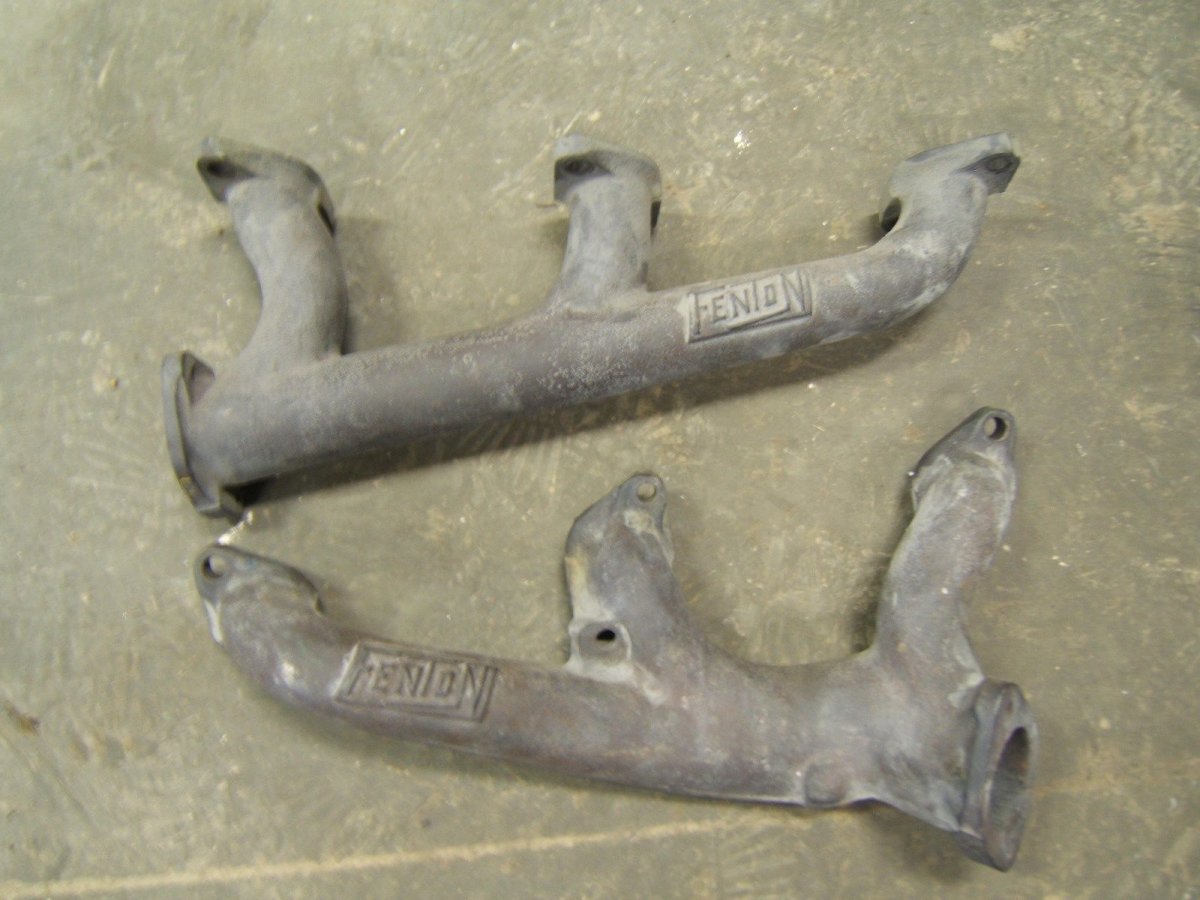

    Question fellas, Have 53 like in the avatar, looking to install power steering i have from a 53 parts car any issues or interference with fenton headers and starter location on drivers side? any info would be great.
  17. don't believe that the starter will play a big role in the ps install. Don't know about the Fentons though. Perhaps a pic of t he ds fenton would help. Where does the generator attach in the ps application on the donor car. I thought in 53 they all were moved to the exhaust manifold.

    Here is a pic of fenton headers and clearence view
