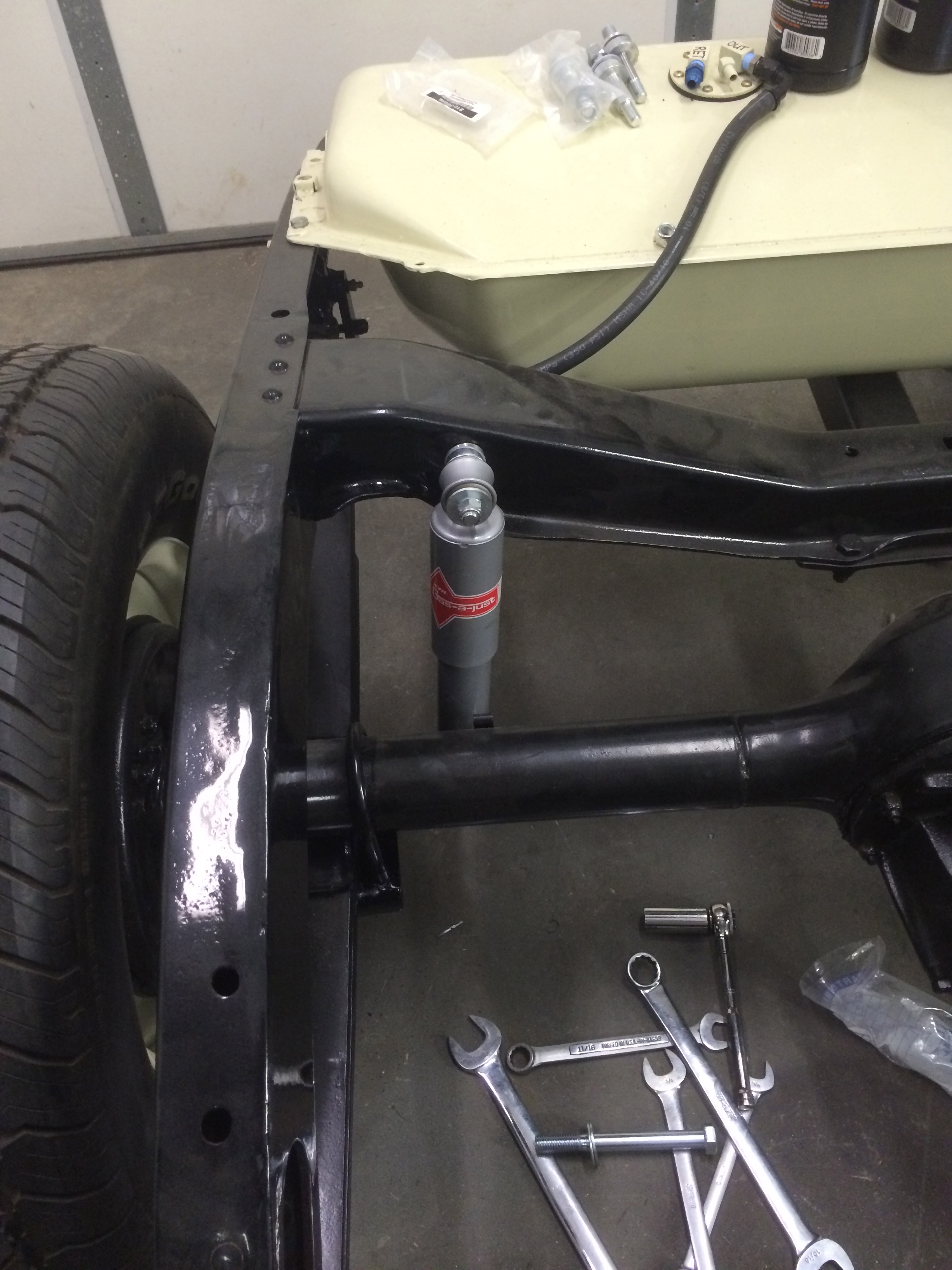

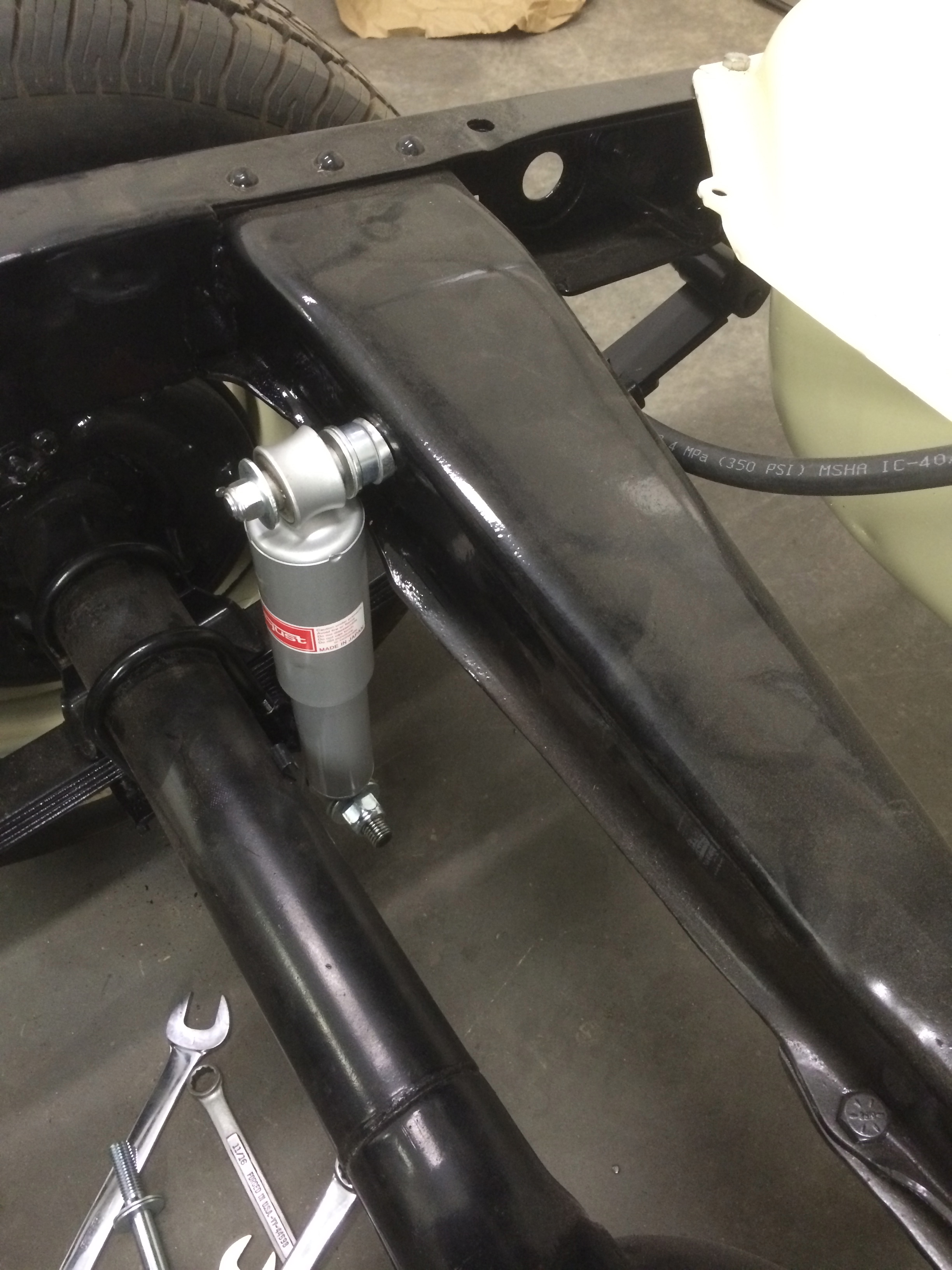

    if you ever find yourself needing a slightly shorter shock cross reference Monroe part # 5752. roughly 8.5 compressed and 12.75 extended. they cross for 50s barndoor vw bus, 50s willys, and a bunch of other stuff. i run the monroe version on my vw's. good shocks, cheap, and either in stock or next day at most any flaps.......
