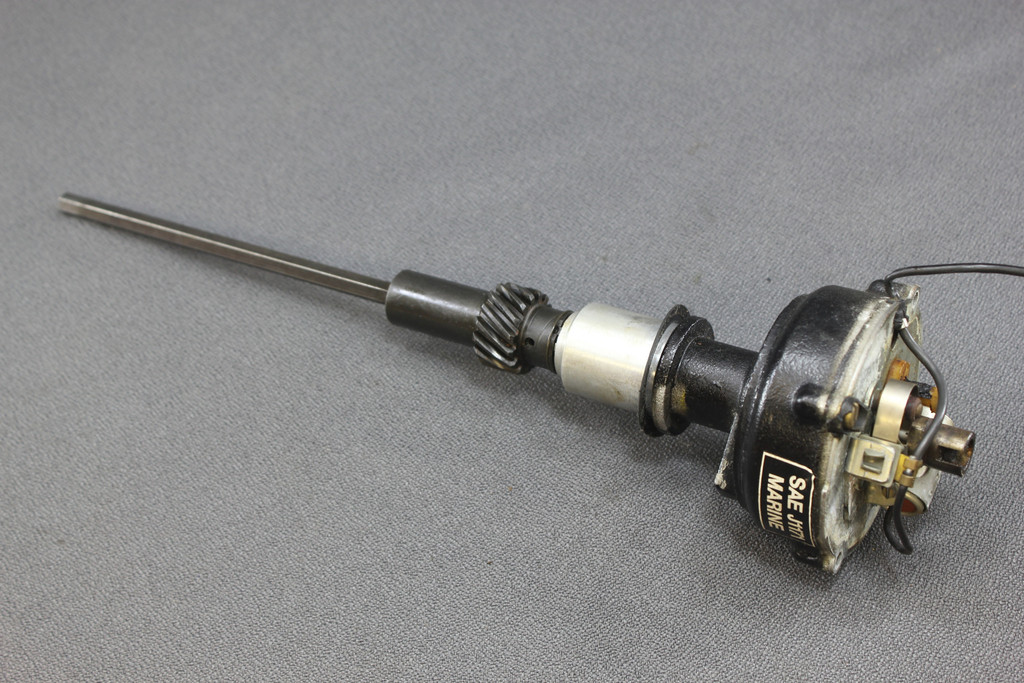

    Below are a couple of photos from the net. One is the 3.7, the other is a Chevy V8 HEI. You can see there is a shoulder on the top of the 470 gear but not on the V8. The bottom shoulder appears longer on the 3.7 gear also.
    If I have a roller cam ground the distributor gear will need to be changed to match the hardness of the cam. The new cam and old gear will not like each other and both will be destroyed.
    I am trying to get my build figured out. Each solution creates another problem. I am very concerned about the original distributor. I can convert it to an electronic unit, but I don't think it will have enough power to light a big load of alcohol. I can hook it to an MSD box to provide more power, but then the problem becomes cross-firing in the small cap. The end result for ignition may have to be a distributorless ignition. That creates an external oil pump issue, but allows me to run a cam without a cam gear which is easier and less expensive to have built.

    I am in the planning stages of using one of these engines in a track roadster/street rod. My first inclination is to have a roller cam (probably hydraulic). I would likely use a 4 cylinder HEI driven from the front of the cam. A dry sump takes care of the oiling. Surely the most expensive route, but in the end maybe not.
    Not having a distributor gear really opens the cam options. Just about any machinist can rough out a billet. Then pay the cam guy for the lobe work.
    BTW Beck, I think you might find a closer match to a Ford distributor. They used that hex drive a long time and I bet that Mercury adapted theirs form a Ford. It might even be a Ford!

    I believe our distributor is the same as the Chevy II 4 cylinder with an adapter to adjust the length. The pump hex drive is Ford. I hoped the distributor gear was something from one of the two. If the gear is a special Mercruiser part it would require more machining making it non-cost effective for roller cam usage. Your front drive setup would be a cheaper option at that point. Driving from the front of the cam removes the need for matching the camshaft gear materials.
