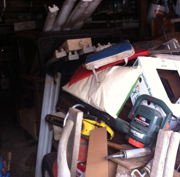

    All of my friends and anyone following me on IG knows that I bought a deuce sedan last Thanksgiving. It was kind of an impulse buy as it was the first chance I ever had to buy a 32 at a price that was within my budget; and I've wanted one of these things a loooong time. For now I'm calling this car the covered wagon deuce because its the last "uncut" tudor, when I chop it I'll have to change the name.
    It took me a year to finish my last project and shuffle stuff around sufficiently to get the tudor into the 16 by 17 foot garage-mahal that I've got nestled in the city. Well its in there now and work has begun. This is going to be a long term project that will be on again off again as time and money allow. I already have one car on the road and feel more urgency to do this car right than to do it quickly. The plan for now is fender-less, 3' chop, full hood, nice rake with wire wheels. the drive train isn't set in stone as I have a couple options but they are all overhead valve with stick transmission options.

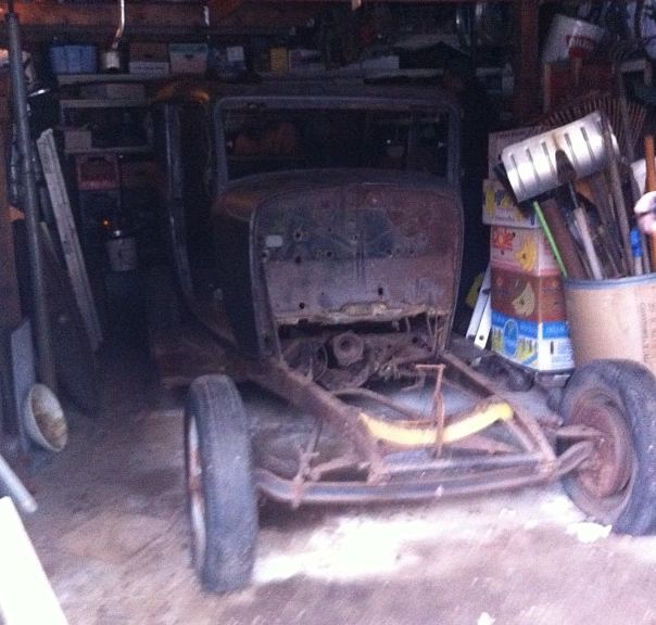

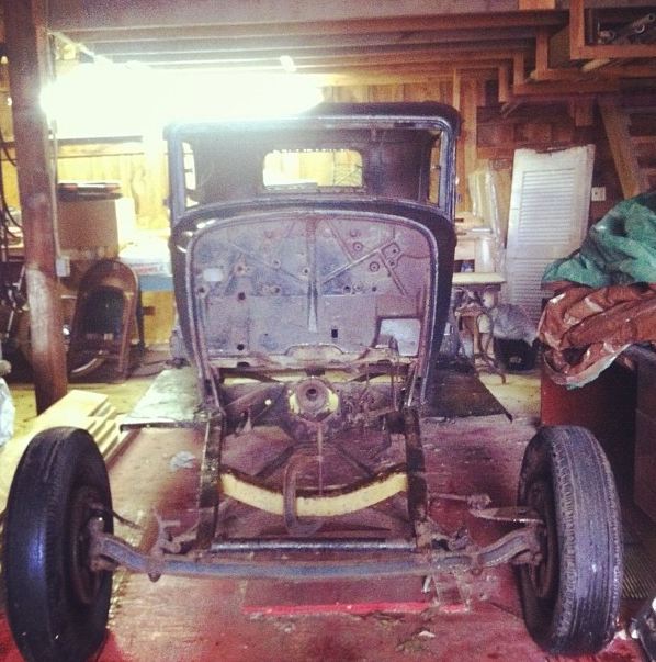

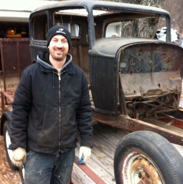

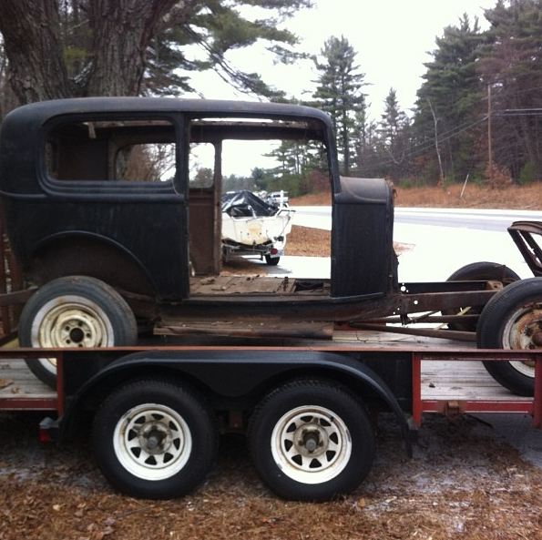

    Here's a few shots from when I picked it up.
    The sign that it was for sale.
    What you saw when you opened the door
    After 30 minutes of digging
    On the trailer
    Dirty but victorious
    Back into hot rod purgatory.

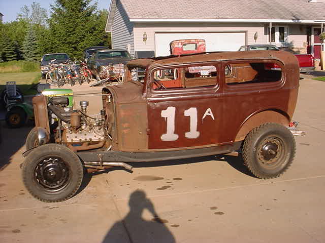

    Haha! I've got plenty of work to do before I visit the Moel. I'll build it and put some shake down miles on it before I cut it.
    This is a picture I look at sometimes as I debate the cut no cut options.

    I'm hoping you do get it driving before you ever think about chopping it. I'm not a restorer, but I've had my fill of heavily chopped '32's. They look great, but they're a pain in the neck. My next one will be unchopped.

    CHOP IT FIRST.....it'll get the juices flowing.....rather than having a grandma car with a tall roof.
  25. Although I'm one of the least qualified to comment on driving heavily chopped hot rods, I think that there can be a happy medium between chopped and comfortable. They don't all need 5" taken out of them to look good in my opinion. 3" and some sensible seating should make for a great usable ride. Hopefully I will know sooner rather than later.

    I've been amazed lately at the amount of people who advocate for not chopping a hot rod, to me theres really no question, I'm not one for top hats so its getting cut, probably 4 inches but I may show some restraint and do 3 1/2.

    I like it...That a pretty nice body, and I like both unchopped and chopped, if you're going to cut it I'd go 4".
