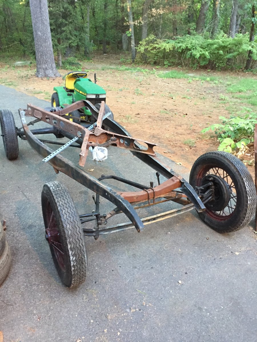

    image.jpeg image.jpeg I spent most of today trimming and fitting the X member and installing the so-cal dropped front crossmember.

    Lots of pieces and parts to stitch together.

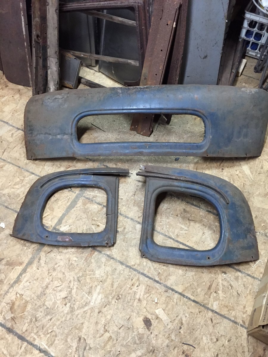

    Here's the doors I picked up, they're 4 door sedan fronts, decent shape with dings and dents but still very decent. Hinges were already robbed, luckily I had a crappy pair of donor doors that had some nice hinges still on them.
    I made some 1/4" plates, drilled and tapped them and hung the doors. You can see the slot I made on the upper A pillar, that's where the 1/4" threaded plate was slid in for the upper hinge.

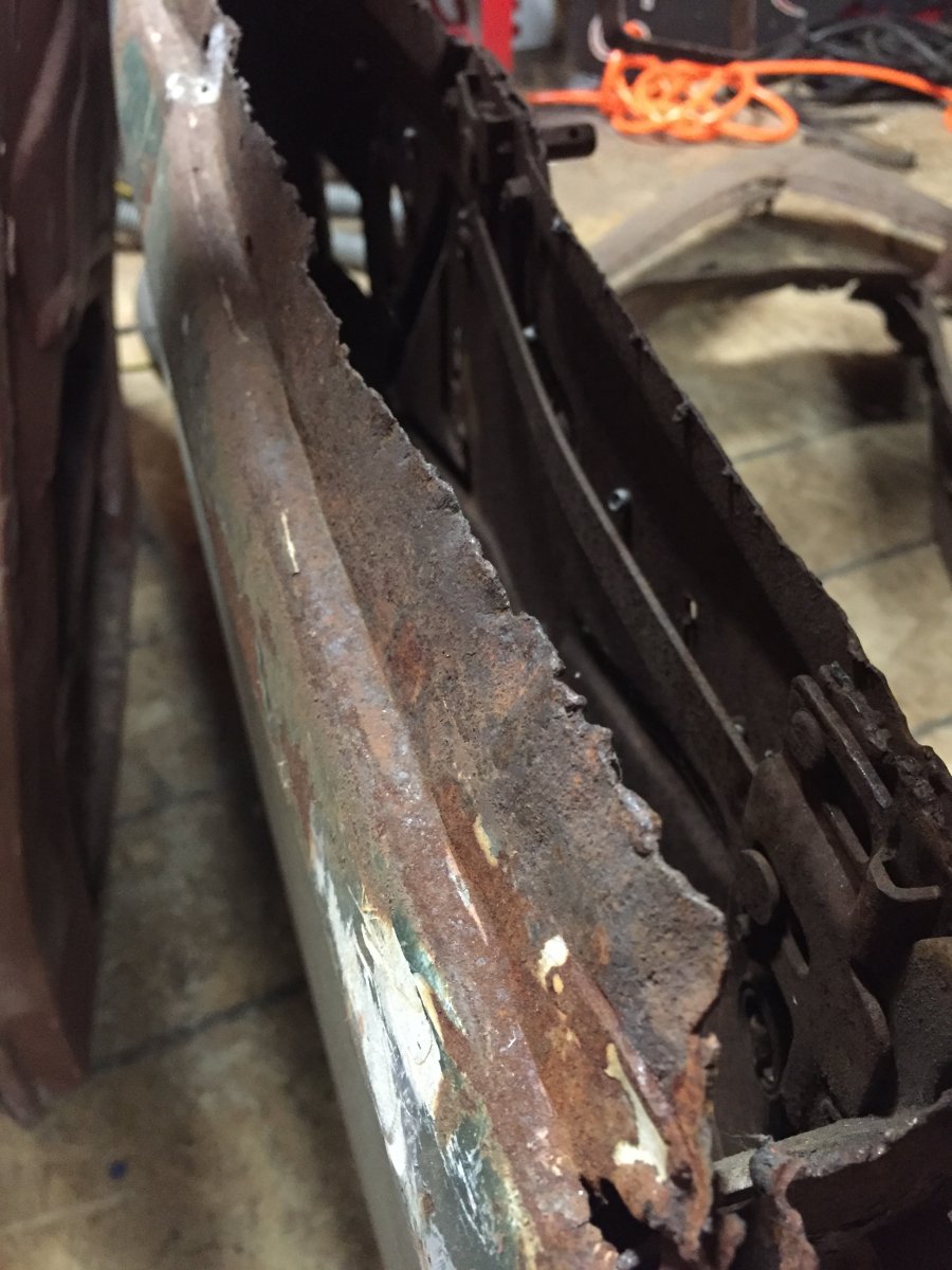

    Ugh.
  24. F&J
    Joined: Apr 5, 2007
    Posts: 13,222
    F&J
    That's why "nobody wanted it" he, he.

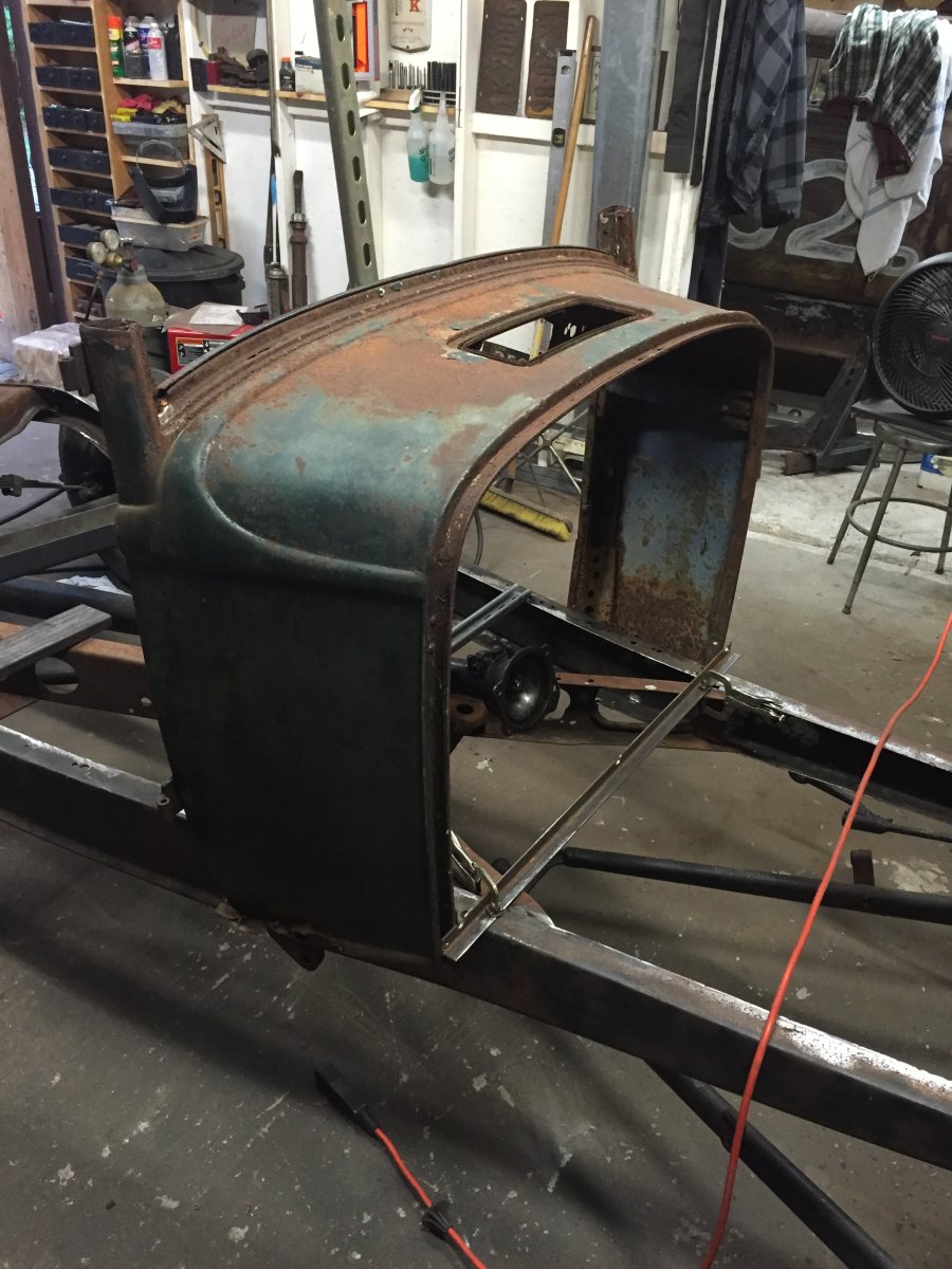

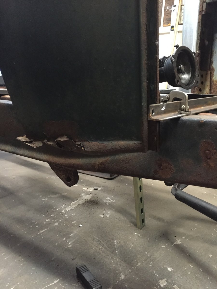

    Spent a few hours in the shop this morning. Made some cowl feet and re hung the doors. I just placed the roached quarters on the frame to get a visual.
