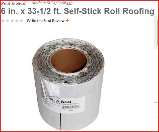

    I used this from Home Depot
    Model T1 likes this.

    Another vote for Peel N Seal, $100 for 100 sq ft.

    peel and seal has the advantage of a backing. I have used all three products mentioned and find peel and seal easier to use because you can cut and test fit it. Frost King unrolls and exposes the adhesive so it's harder to use. The closed foam material needs to be taped down to keep it in place. Look for it in Home Depot of Lowes in the roofing department.

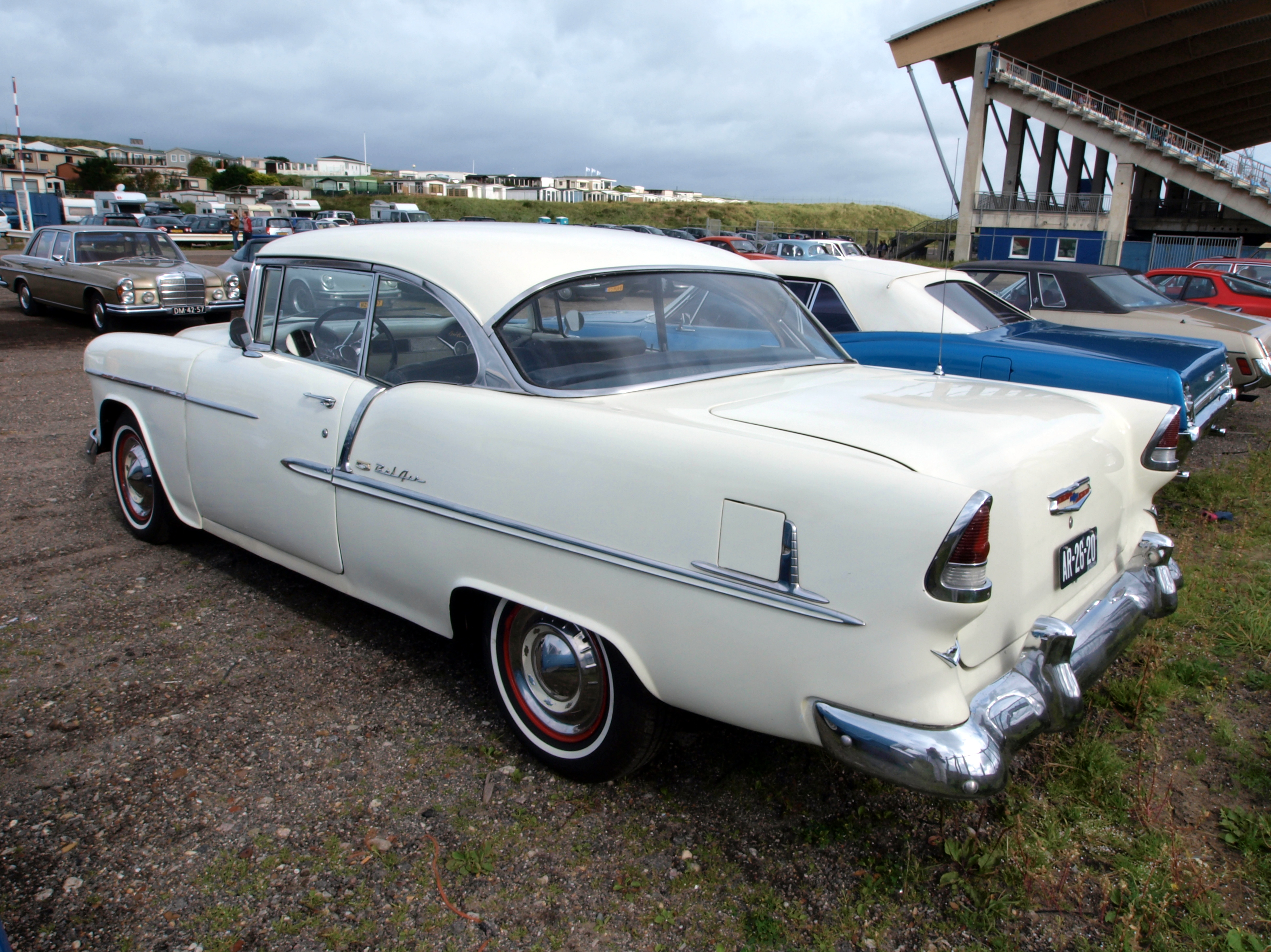

  25. For those of you that mounted your master cylinder under the floor along with your battery, it would
    be easy to get to it if you incorporated a gas door like this 55 Chevy's (or any flat door will work, plus their spring loaded) in the floor pan and then you could spray or stick your sound and heat insulation down, then put a piece of Velcro on the gas door and attach a piece of carpeting to the Velcro and cover with a floor mat. It might work without the Velcro just experiment.
    I suggested it to a friend of mine who owns a '51 Chevy so he could access the master cylinder.
    It worked out great, It's just a thought.
