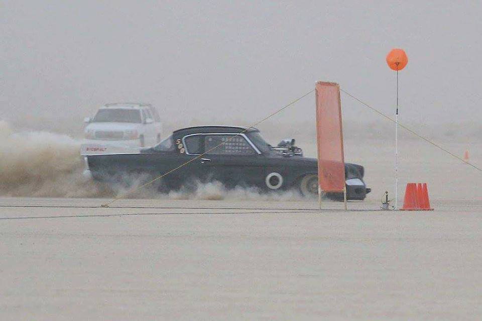

    Joined: Nov 15, 2016
    Posts: 63
    RRichFox
  19. Flipper
    Joined: May 10, 2003
    Posts: 3,395
    Flipper
    from Kentucky
    That has been a reoccurring thought for me too. As a matter of fact, the original plan was to build a stude for the Ohio mile. By the time I found something to build, they made the decision to not race there anymore. .....but the studebaker fire was lit, so now it is going to be a street car. I'm trying real hard to keep it capable of doing long trips (Bonneville, beach, or whatever) and get more gas mileage than the 13 mpg my flatbed gets .....WITHOUT INSTALLING A LS
