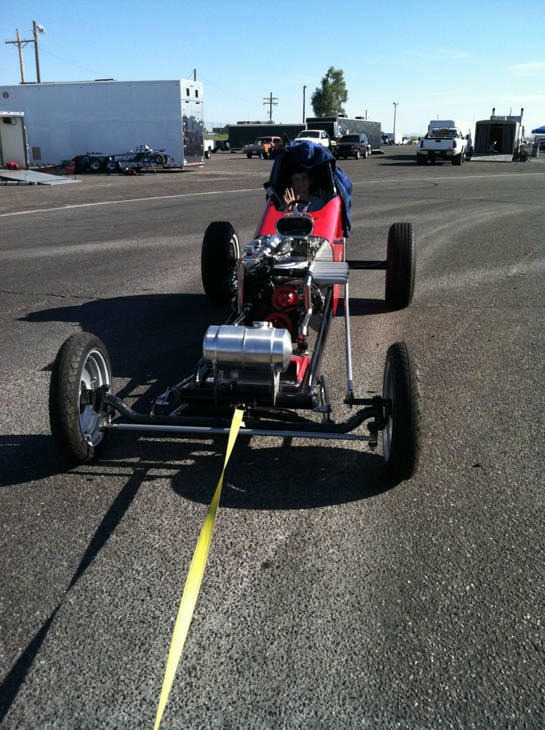

    Next time we will be taking them out we will fatten them up a little fined a real stall converter .and try again the motor pulls real hard once we get it off the line so I think we are on the right path .... Here's a pic of my boy pulling car back after the last pass ... Other pics and maybe a gopro video to come ImageUploadedByH.A.M.B.1390762501.125017.jpg

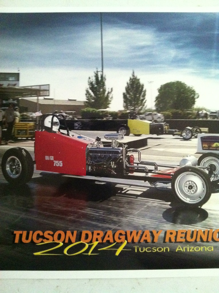

    ImageUploadedByH.A.M.B.1400543242.951030.jpg ImageUploadedByH.A.M.B.1400543274.735642.jpg . Had a blast this week end thanks to many people Here's a few pics

    I don't know were to start. The two Reunion pictures with the cars at the start & finish are great. You guys are bracket racing the heck out of the two rides. I am surprised that you can run those tires at 12# without any problems, I thought 15-16# was as low as they should be run even with 1400-1500# rail.
    I would say that those 6 cylinder converters are working just fine. You may have to tune the dragsters for a 2200-2300 rpm leave. A 2600-3000 leave may be real hard with these tires and the weight of both cars. I am sure 100+ temp and 144+ track temp is not ideal conditions for a "no spin pass".
    Glad you had a great time, but taking back your own hardware :cool: You guys are showing that these SDRA dragsters can be a great low dollar bracket car that can go rounds, well done.:D
