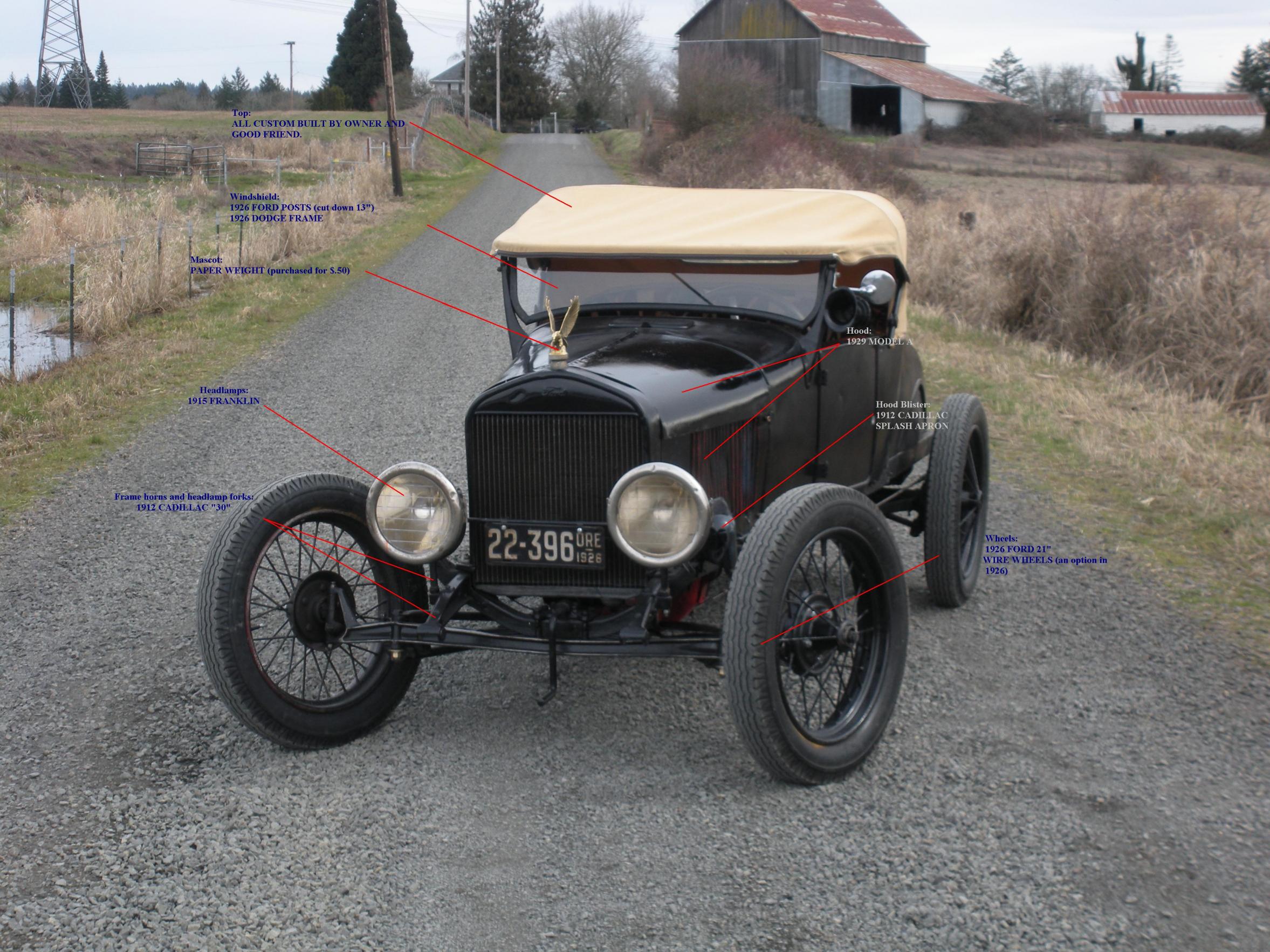

    I must thank you again for all of the wounderful feedback on my roadster!
    For those of you who are pleading for a breakdown of the parts used on the car, I must oblige.
    Here is a quick rundown:

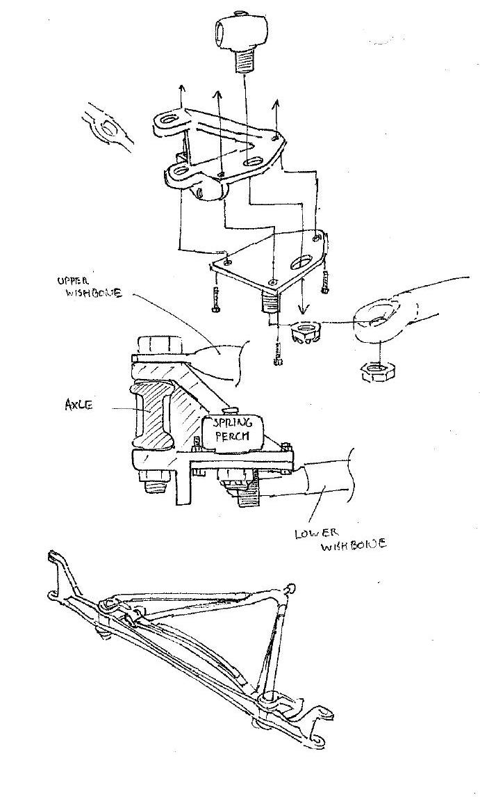

    Mr ModelT - Great car and thanks for the last photo showing key parts - it's very helpful. When you have the time, could you please do something similar (or a drawing) showing how you used the underslung brackets to lower the front. How did you tweak the steering to deal with the stretch? I'm assuming that you're using using stock T springs front and back and that the rear was lowered just be switching the axle housings left to right.

    Jon and fellow H.A.M.Bers,
    I have just the thing. Someone else asked for a diagram of the suspension setup on the car, so I whipped up a few quick drawings.
    The front suspension was lowered using the old “<?xml:namespace prefix = st1 ns = "urn:schemas-microsoft-com[​IMG]<ST1:pLaurel</ST1:p</st1:City>” underslung brackets.
    The rear was lowered the same amount (almost on accident) by splitting the rear axle housing and switching sides (right on the left and left on the right). This put the spring perches on the bottom and with a set of hand made extended shackles got the finished stance.

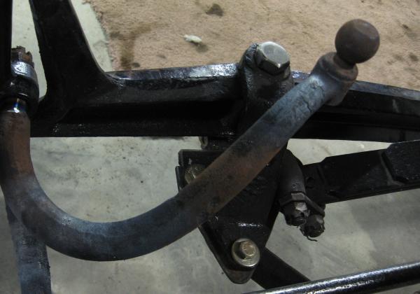

    ...The steering did not pose a problem because I did not use a stock T steering assembly, as it was not stout enough. I found a complete steering colomn assembly from a 1922 or 23 Willy-Knight sedan that ended up being plenty long enough. I had wanted a steering setup like the bigger cars of the Teens and early '20s with the throttle and timing controls in the middle of the wheel rather than below it like a T, A or early Dodge.
    The Willys-Knight setup was perfect.
    It did however, require me to change the steering from "cross-steer" to "push-pull"....thats where most of the little Dodge, Buick, and Cadillac steering stuff comes in.
