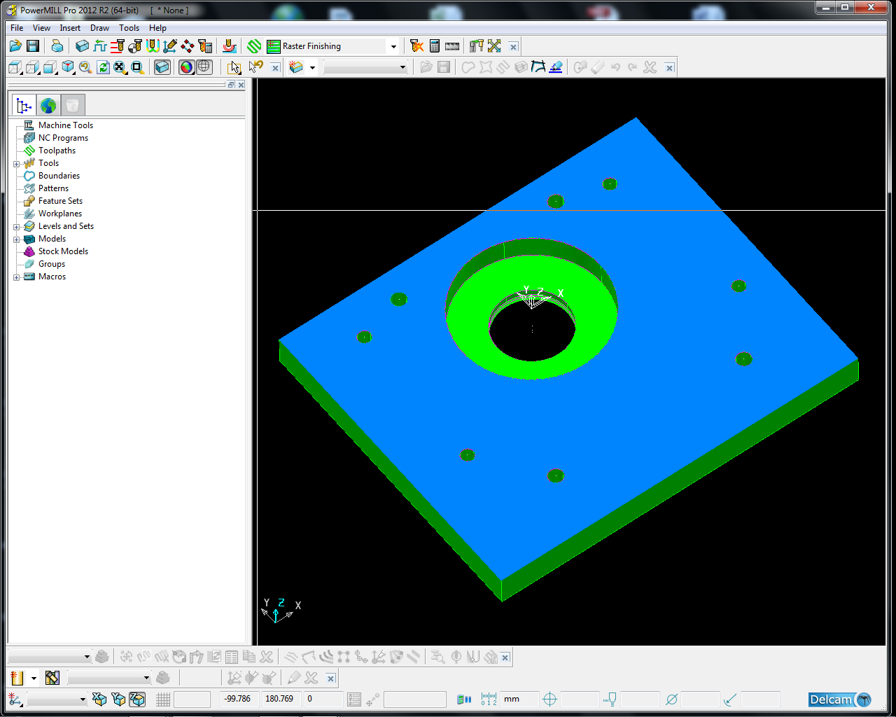

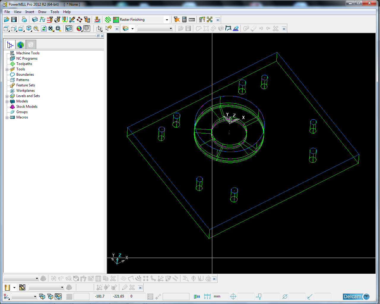

    Hey Guys this is my first thread so bare with me. After much research on the HAMB and a bottle of aspirin I made an adapter plate that bolts up to the stock flathead bellhousing. Here are some pictures.
    This is the 3d Model I surfaced at work. it has the stock flathead tranny bolt pattern which is counterbored into the plate. The T5 pattern is threaded into the plate. The tranny's small .25" lip thats around the input shaft inserts into the large counterbore. The large diameter boss then inserts into the ford bell housing.

    BRENT

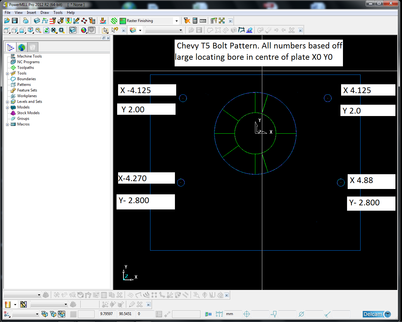

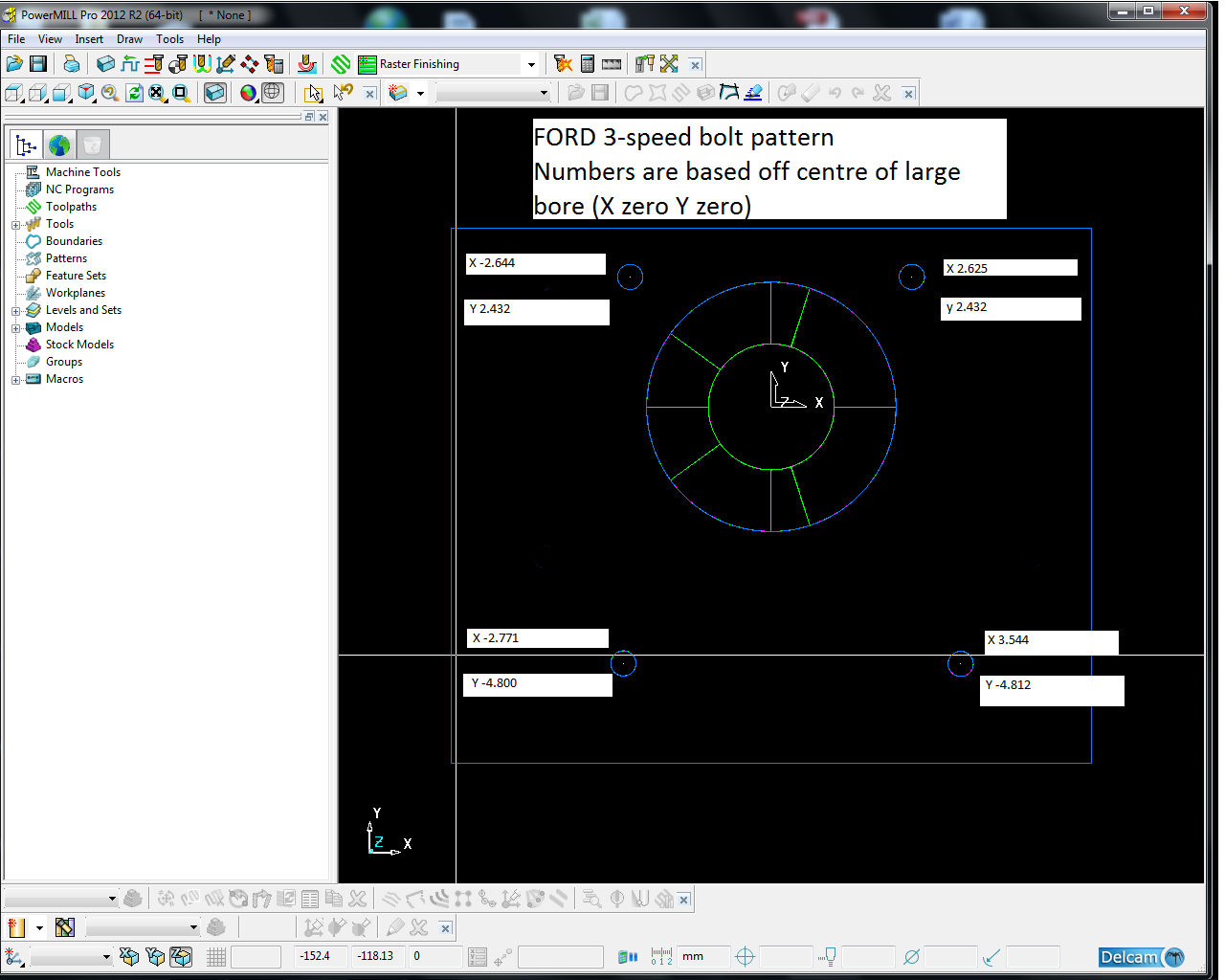

    I was asked if I could post the dimensions of the adapter plate. But before I do I just want to be clear that I physically picked up and indicated each transmissions bolt pattern and made my numbers off of my true locations. Does this mean yours will be the same? I'm not sure. The T5 numbers seem to be more nominal and suggest it was built in a time where they were able to employ modern machining practices probably using cartesian coordinates (X and Y locations).
    The Ford tranny however seems to be not so nominal as I can only guess it was manufactured in a not so precise manner so you may want to check your numbers.
  19. BRENT
    Joined: Jun 22, 2005
    Posts: 252
    BRENT
  20. BRENT
    Posts: 252
    BRENT
    This is the plate shaded up its the same pic as the top picture but just shaded up.
  21. BRENT
    Posts: 252
    BRENT
    Here is the Ford Bolt Pattern
  22. BRENT
    Posts: 252
    BRENT
    Here is the Chevy T5 bolt pattern
  23. BRENT
    Posts: 252
    BRENT
    Hope this helps, I'm still learning the new HAMB so my pic are not to big but
    I think you can get the idea of what I did.
