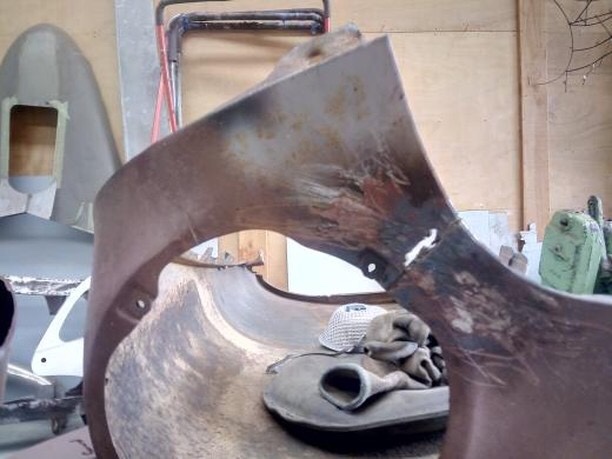

    Taken a week out of work to go and help on my coupe. Decided to remove the rear quarters and clean out and blast the area behind.cut around behind the seams as I'm keeping those. Front fenders and rear quarters off to get blasted and epoxy finished before assembly and refit.[​IMG][​IMG][​IMG][​IMG][​IMG][​IMG]

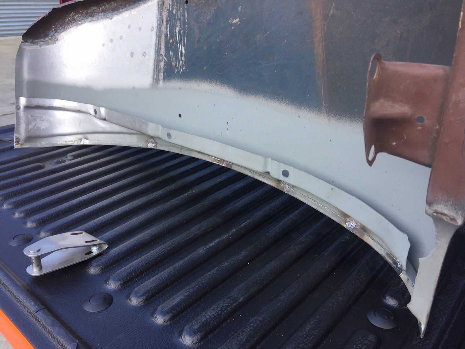

    Fenders rear area blasted then painted before reassembly of the internal frames[​IMG][​IMG][​IMG][​IMG][​IMG]

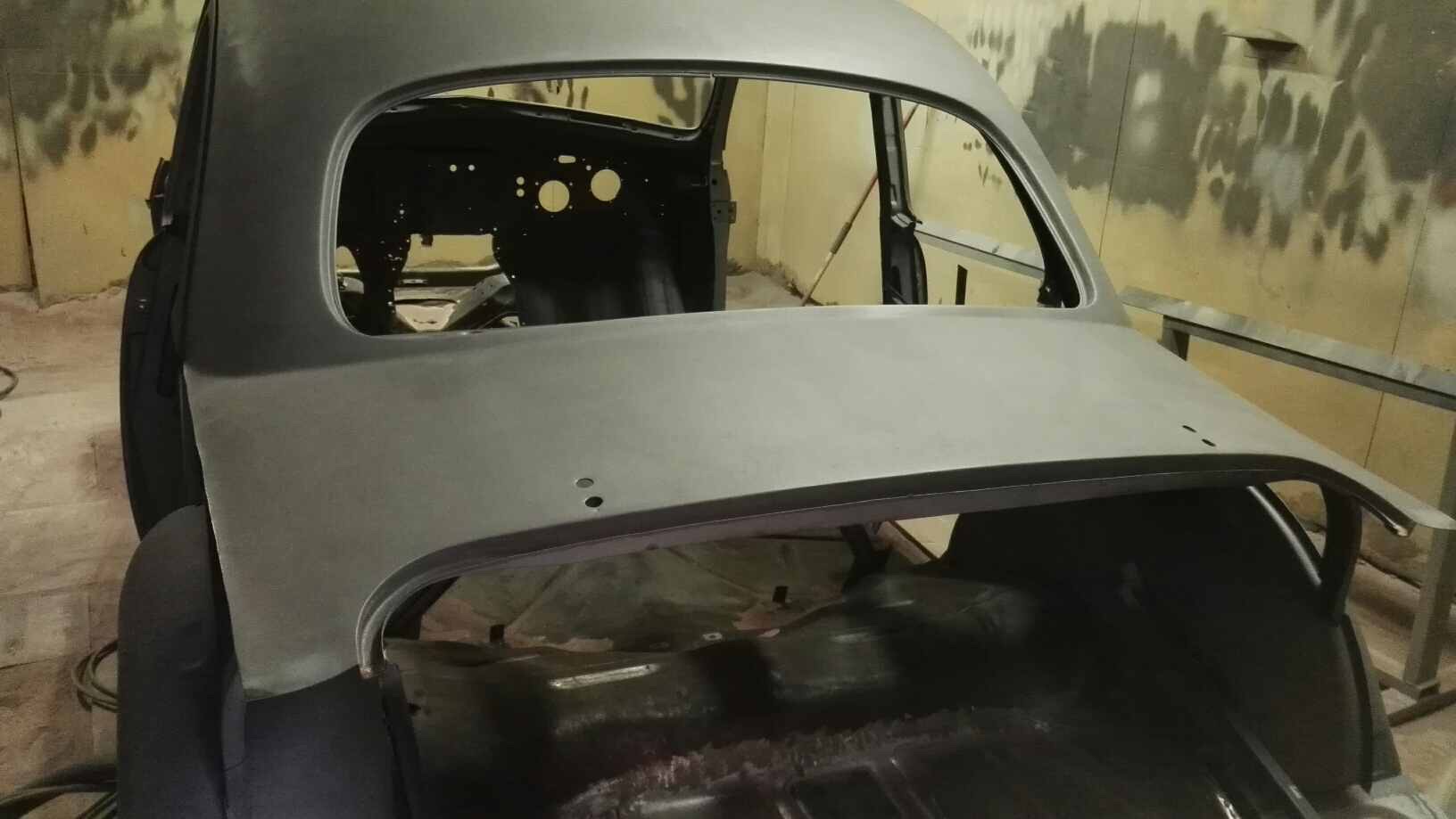

    And after many many years it's off for abrasive blasting and epoxy primer.
    The quarters will then be stitched back onto the body along with the rear panels.

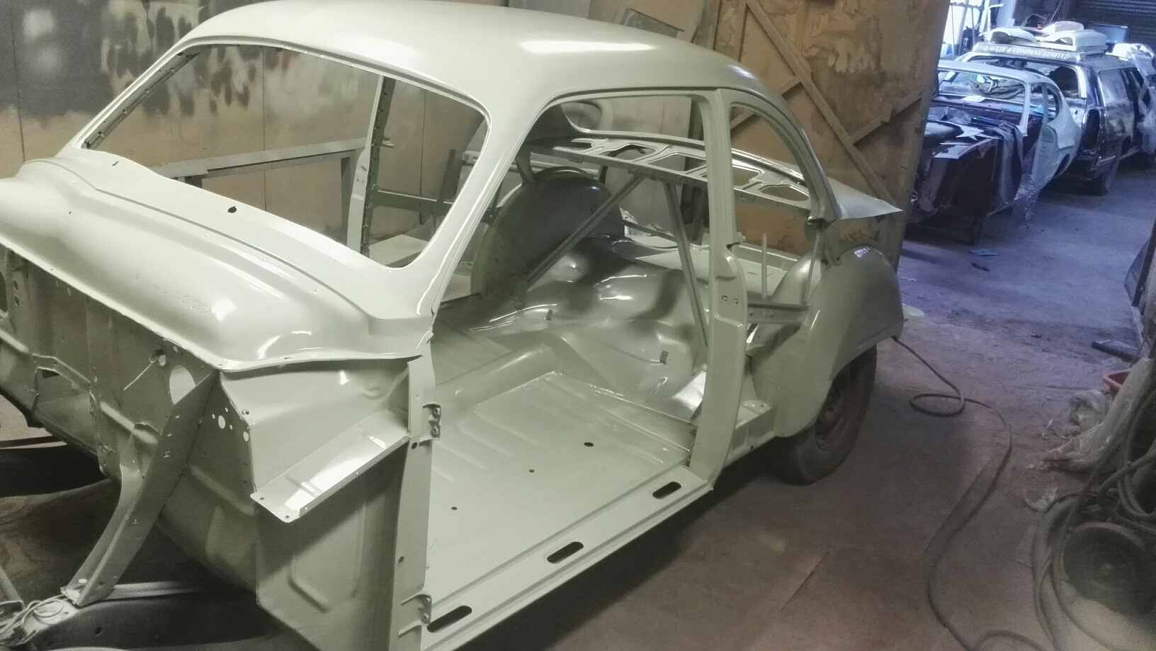

    And finally after 13 years it's seeing some primer. I'm certainly not going to miss sanding back the bare metal and coating with keyphos every six months [​IMG] [​IMG][​IMG][​IMG][​IMG][​IMG]

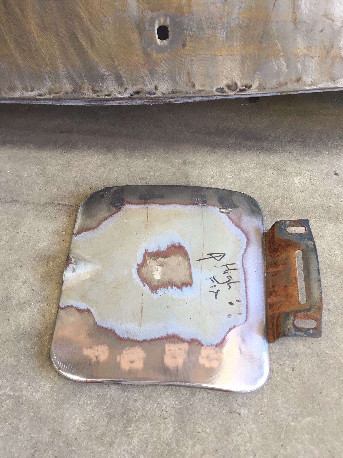

    The door corners have been radius'd and the rear quarters are off for blasting before being refit. I decided to also radius the fuel filler flap as it was a feature of the 'factory custom' Ford. Looking forward to seeing how it looks in primer.[​IMG][​IMG][​IMG]
