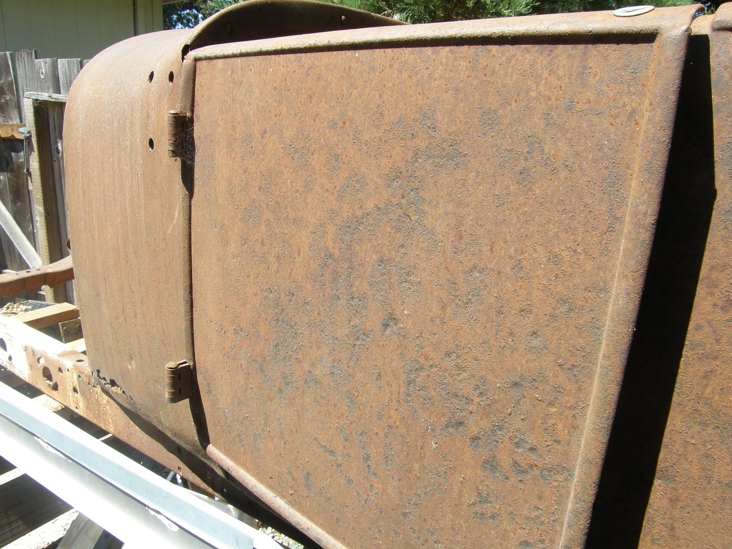

    I'm well aware of dipping, blasting, electrolysis and molasses. Dipping is way too expensive. Blasting can be expensive or messy if I do it myself. That leaves electrolysis and molasses.
    My roadster body has been sitting outside (in a tree) for the last 50 years.
    It has pitted rust. Not quite rot, but getting there. Will either of the last 2 methods clean it up? If so, how long does each panel need to sit in the solutions? Maybe I can combine one of those methods and light blasting? Any thoughts on the subject are greatly appreciated!

    It seems like you have a perfectly sound and even coating of rust. It's like a poster child for POR.
    Why not knock off any loose rust with a wire brush and spray with POR? The POR can be topcoated and then you are good to go with no chance of messing up that fine old tin.

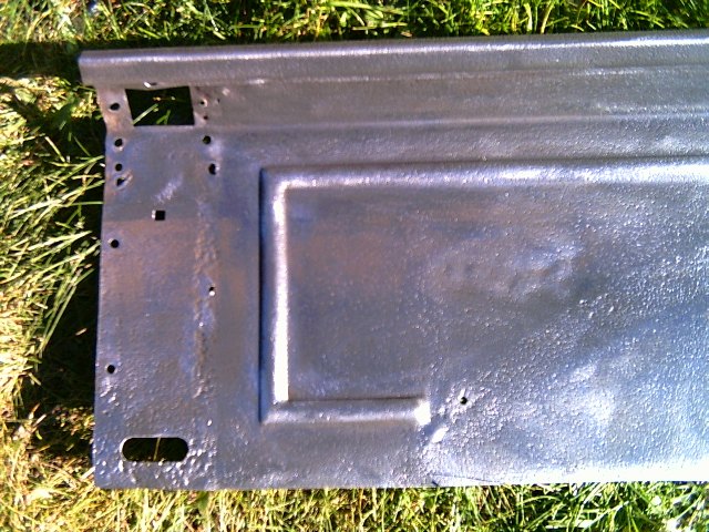

    Electrolysis at work:

    My opinion from the picture is, "not quite rot' is an optimistic point of view. In places, that sheetmetal has lost more than half of it's original thickness. After blasting there will be holes in lots of places. Don't blast it, wire bursh the loose off, POR it and drive it, it'll last forever . http://www.por15.com/
