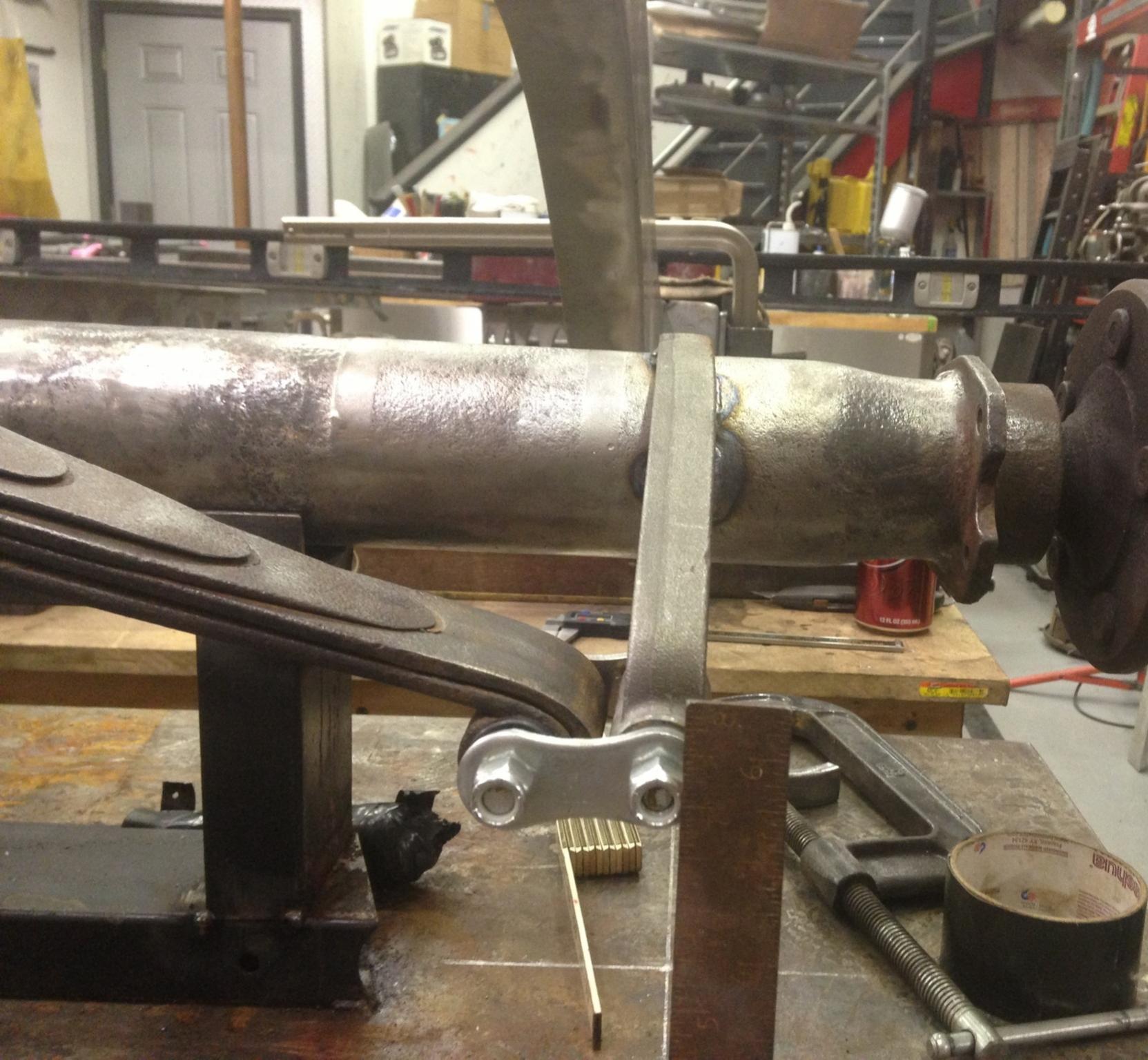

  1. It's pretty much a given any more that every part you get needs modified before it works. It become part of the deal anymore. But this just ticked me off so bad its not funny. You see, there's advertising, there's creative license and then there's straight out steaming piles of fucking bullshit. This place will never get another nickel of mine & that's too bad. They have some nice stuff and established since 1946 but I don't need to pay for aggravation, I get that for free!!!
    I open my 2.25" rear shackels and this where it goes down hill.
    The bushings measure 0.78 on the OD that's supposed to be 0.75 - no biggie , sand them down a little. The shackle pin from shoulder to fixed plate measures 2.375 ? and the bushings measure 2.375 OS shoulders but inside shoulders measure 2.125- something is screwy. No biggie maybe ill just extend the shoulder a little bit so it all works.
    Then we have the forged rear hangers. The bushing holes measure 0.74. Just try to shove the 0.78 bushing in there. Ha ha, so just need to hone the hole to 0.75. But the holes are also not centered in the forging. How much ? Both hangers bushing holes offset to left the Enough that the spring rubs on the hanger on one side but plenty of room on the other.
    So now I've had it with my modifications and call the vender to ask about this crap. We don't get past the issues of bushing shoulders. 20 mins I listen to bullshit that ends with "it's the same stuff as posies. I don't know what to tell you." I then called posies and we went over their 2.25 shackles. Pin is 2.5 bushing shoulder is 0.125 and inside shoulders is 2.25. I asked him what he has that has 2.38 pin with 2.125 between shoulders and he said there's nothing that I know of.
    Now back to the original vender with a recap of that conversation. His only suggestion was to not tighten the nut up and only reassurance he gave was that they have sold these for years. By now I'm really pissed & want off the phone. Call posies and order the correct shackles. Figure ill continue with my mock up adventure and change them out later. Ok back on schedual, sort of.
    Get the spring mounted on the hangers and all seemed right for a moment. I noticed the hangers looked bowed. I double checked my lines and sure as shit the center bowed and my lines were now off. Well what the hell? Ok take tension off the spring and it moves back.
    Here's how the hangers are advertised :
    Product Description
    Forged Rear Buggy Spring Hangers: These forged steel ⅞” thick rear spring hanger brackets feature I-beam construction, 3" dia. holes for tubular/stamped housings. Note: Do to I-beam design; angle support gussets are no longer necessary.
    Well look at the pics, and you tell me.
    I also have a video that shows this POS move as the spring gets unloaded - pm your email if you want to see it walk back.
    That bolt should be centered on the square.

  2. Here it is with the spring unloaded.
    The square tube has the spring tension.

    In the real world, would the weight of the car on the spring spread them back out and put the shackles at 45 degree's?
  8. seb fontana
    Joined: Sep 1, 2005
    Posts: 8,495
    seb fontana
    from ct
    Not meaning to throw fuel to the fire but assuming the hangers are welded in place that there is no deflection in the axle housing ? The shackles however would make me want to stick something somewheres...Having to correct stuff is bullshit; just consider that you have the ability to see shit for shit and figure when its a no work situation..Many people don't and slam crap together... ..

    No matter which mounts you end up using, some triangulation would be a good idea. There is no way that any mount will not deflect some amount without some sort of gusset.

    If I hadn't seen it with my own eyes, I wouldn't have believed it.You wouldn't think a piece of forged 3/4 steel, that short, could possibly move that much. Where on earth are the Chinese getting their steel?

    Here's the rub on the gussets. But first ,,,
    Welding on tubes
    Welding all the way around a pipe along its circumference tends to leave the tube straight. Welding a gusset (or anything) perpendicular to the circumference tends to pull the tube to the weld and a partial circumference weld will pull the tube as well.
    Housings are welded and straightened everyday, but why ask for the extra work of straightening if a hanger that doesn't need a gusset is available.
