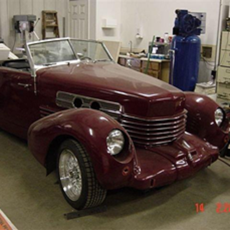

    -1904985679189FA8CE.png My avatar is a 'real' Cord, but is a photo I picked up on the net. The photo in this post is my Cord replica, 289 Ford powered.
