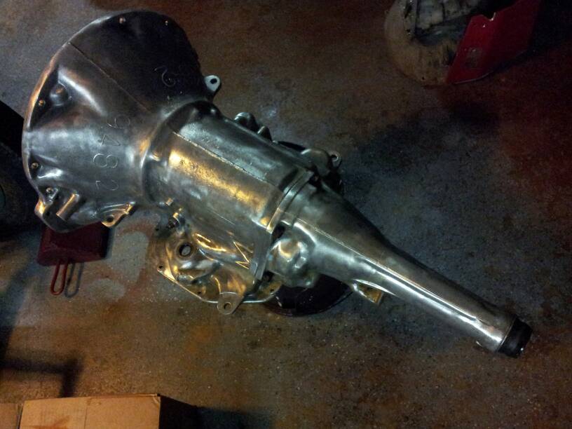

    Case clean & ready to be rebuilt....should I paint it or no?
    also adding a TransGo TF-3 kit..."cause real Hot Rods have stick shifts"
    ...............just kidding, don't want that ugly kick down linkage hanging around.
  2. 340HilbornDuster
    Joined: Nov 14, 2011
    Posts: 1,985
    340HilbornDuster
    New Clutches. Bands & Seals.
    "Stick Shift" Valve Body.
    I painted it....Just love that Hammered Color!!
    Next I'll "Hammer" the 340 ... Bolt'em together with a 2700 converter and Throw it in!

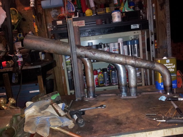

    Got the outer apipes tacked...
    Now I can take them off and do the middle tubes and finish TIG on the welding table.
    20160903_170256 (Small).jpg 20160903_170242 (Small).jpg 20160903_170304 (Small).jpg

    Bolted to the table...

    One Down....Still need to weld inside of flange on both when done... 20160913_121613 (Medium).jpg
    Leveled & Tacked the second one...B4 table jig..
    My first set of "Salt Flat Headers" (learned a lot for the next set!

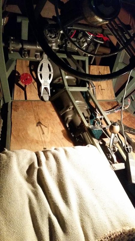

    "Speed King" Pedal:
    I wrote it off earlier, looked at it s'more, removed my old home made bracket,
    It's really tight...but I think it's gonna fit like a glove!
    Maybe snake in a bicycle brake wire...?
    Broom broom!
