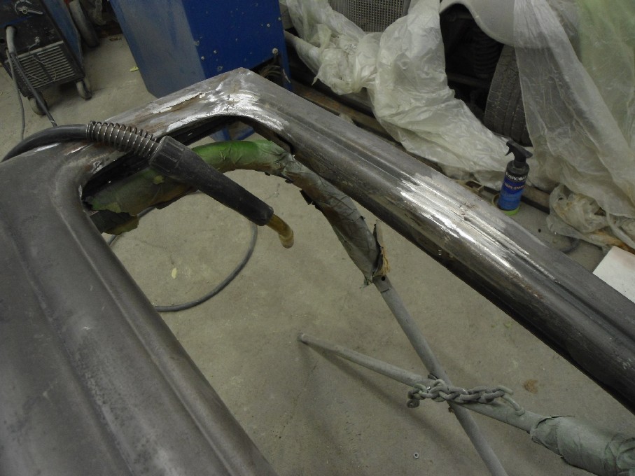

  4. Last night we checked another task off the "list". We finished welding above the passenger's door which turned into finishing up welding where we only tacked during the top chop. We also filled a pretty good sized hole where we had welded the bottom of the top to the top of the right quarter. Jimmy filled it with a series of small pieces doing all butt welds, no overlapping welds.
    Only stuff left to do on the list is: 34doorjambhole.jpg 34doorjambhole1.jpg
    #2...........finish welding around the decklid hole. And
    #5..........finish up hood sides.

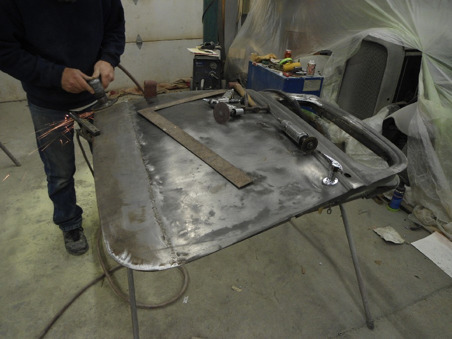

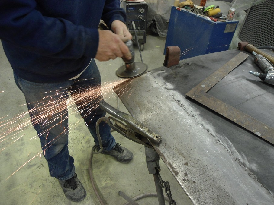

  12. Yeah, Tim.............I know. We're shrinking the high spots on the hood sides after welding the 34 chevy louvered piece into them and it takes forever! Run the shrinking disc over the high spots, hit it with cool air and feel..........repeat. Over and over! The lumpy areas slowly get flat but damn! It takes a long time and it's super noisy.
    We spent 3 hours on the left hood side Tuesday night and it's a lot better but there's still more to do. 34hoodsidejimmy.JPG 34hoodsideduring.JPG

  14. Grinding is just as much of an art as welding. Especially on sheet metal. Then when there's problems with welding on thin metal, or over streched corners, or poor fits in an area that has a lot of details the grinding skill needs to be far better or problems get worse and work is doubled. The precision of a surgeon with vibrating metal eater in you hands. It's not fun, its not glamorous, its not glorifying but you'd better be good at it.
    Nice job here rocky.
    That hood is awesome !!!
    Me and a friend working together made some shrinking disk discoveries. The light bulb moment if you will. Now he's never used a shrinking disk but is an excellent metal bumper. I've got a lot of time on the disk but not so much on the bumping. Working together and each learning from the other we discovered that bumping the metal into a smooth contour first then running the disk makes the panel flatter 10 times quicker that bumping alone or shrinking disk alone.
    Doning It seems counter productive but it really does the trick.
