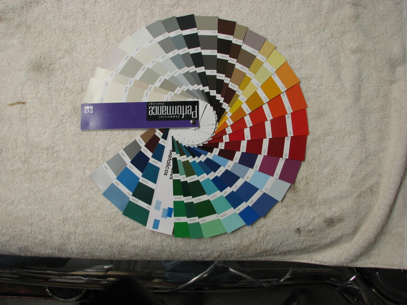

    Hey, you might want to check out PPGs Performance line of commercial paint. You should be able to get a gallon of any of their blues with hardener and get change from a $100 bill. It sprays well and is as durable as anything I've seen. It would not surprise me if Dupont and the other biggies have something similar as well.
