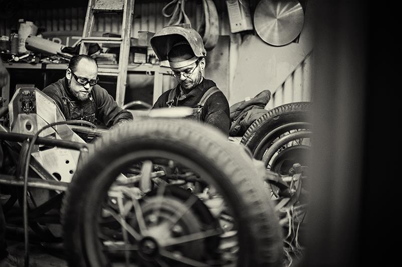

    A coupe things here ....
    -remember to do all your mocking-up and measuring while wearing a fire jacked (or two coats) and your helmet. The spacing between the top/ sides of the helmet is very important as well as the distance from the front of the helmet to the front of the cage (look in the book under Lateral Head Restraints)
    -is the bar that the top of the cage is resting on already welded in? i know it would be a lot of work, but if it is just tacked in place you may want to consider removing it and making the top of the cockpit tie directly into the center bars of the cage. (i hope that makes sense). the vertical bars are what's going to help of you go wrong-side-up and it is ideal if they are not split for a bar to go through. you would be better off with that horizontal bar being fish-mouthed around the vertical bars. it's not the end of the world either way and it's not something that would keep you from passing tech. just a suggestion.
    -lastly, keep your welding gaps in mind- especially with the fish mouths on the cage. you want them almost water-tight with a small bevel before you weld. if you're having to fill a gap, it's probably worth redoing.
    i don't mean to be a prick and i hope that helps! safety first!!!
  16. Alx
    Joined: Feb 10, 2012
    Posts: 28
    Alx
    from Belgium
    Yes, we checked and followed the rules of the Rules Book. We have oversized the distances to be on. and we have checked through this mock-up.
    No, this is the Mock-up, it is not yet sealed.
    We received the roll cage tubes to the next weekend.
    Yes you are right, but the roll cage on the photo is not finished
    There will be a tube between the middle horizontal tube and the horizontal tube which is installed the roll cage driver. Because in case of pressure, the horizontal tube where the roll cage driver, he would not survive.
    Yes, absolutely, there is actually very rough, we use the program "tubemitter" to have perfect fish mouth ( in french "Gueule de loup" "wolf mouth"). we avoid having large separation between of each item, for to have a maximum absorption of the metal.
    Absolutely not, on the contrary, I appreciate that kind of comment, at least we can perceive that something is a wrong build. Our goal is to run at Bonneville, then all advice is welcome.
