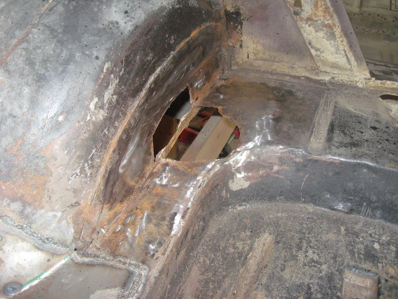

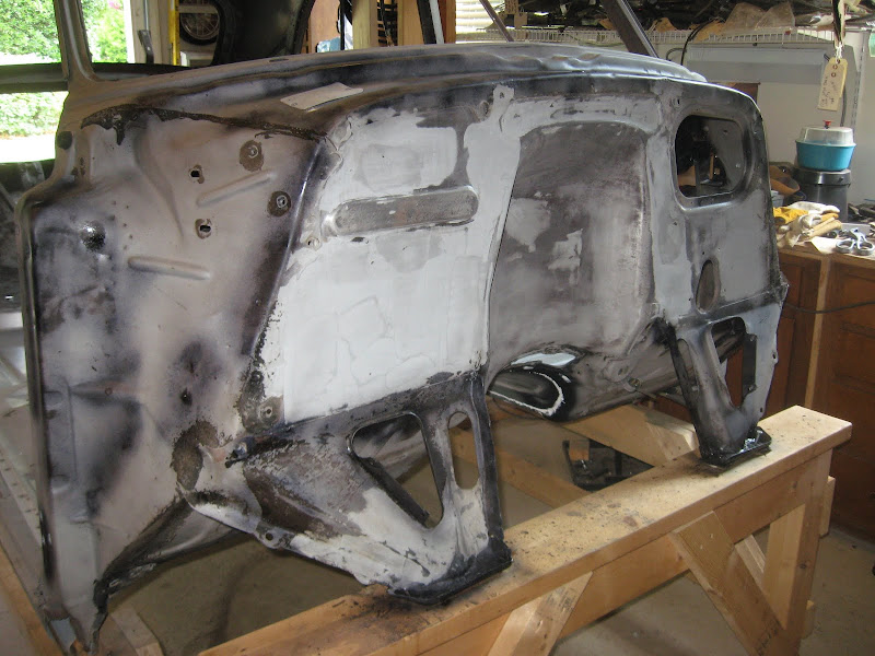

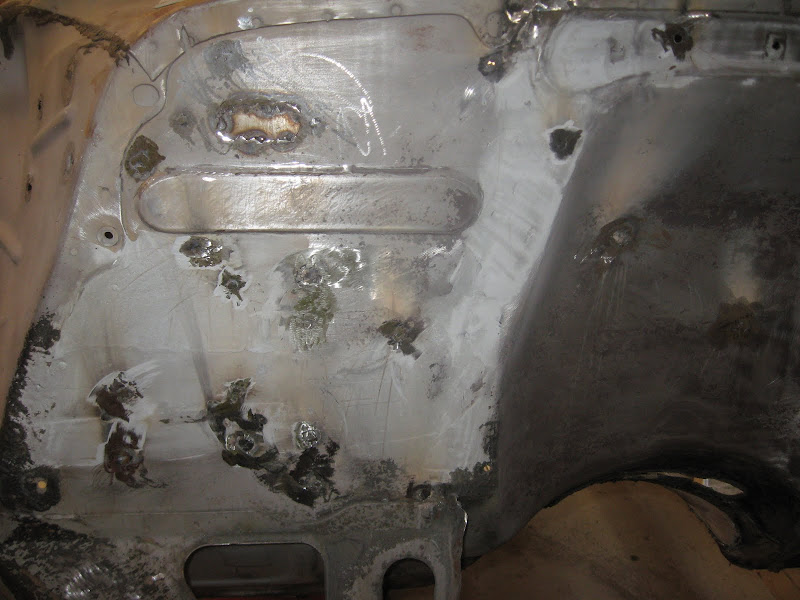

    (Edit) ditching the cowl vents. Decided to clean up all the holes, not sure what most of them are for anyway. Might be a better way, but I found just overlapping a larger piece on the other side (inside) of the cowl was easiest. Have no qualms about filler. I mean, we've got enough work to do as it is. :)
    Here's the "wrench" story. If I could not reach around to the other side of the cowl in order to hold the patch pc. tight, then I'd just screw something (like the wrench above) to the cowl to hold it tight. What's a few more small holes that I can weld closed?

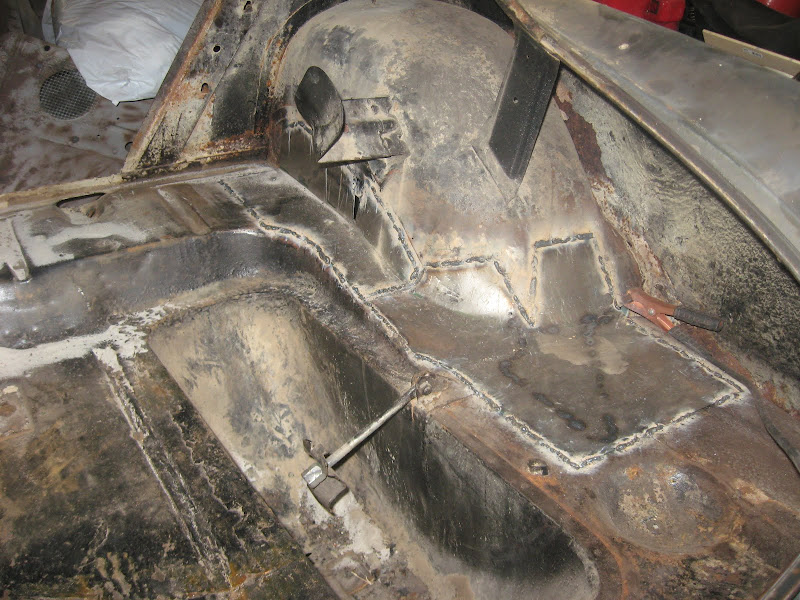

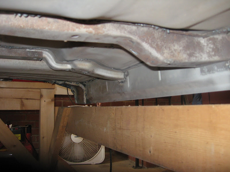

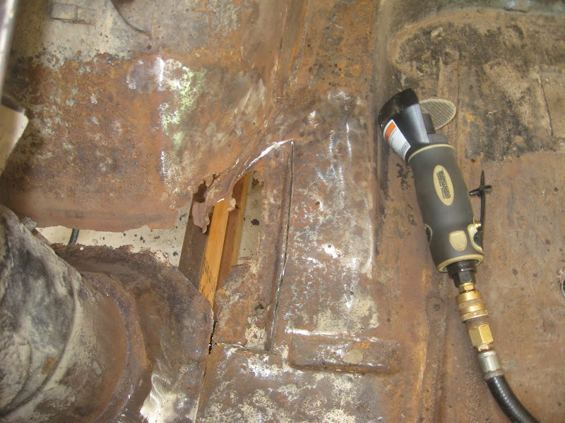

    Inside rt. rear tub, 60 years of road grime and rubber bits.

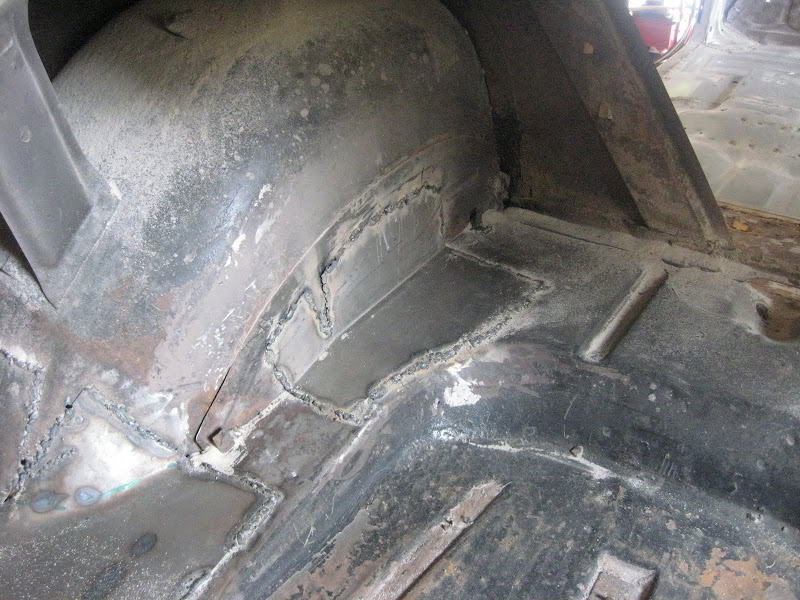

    Here you go, Johnny1290, the inside of rt. rear 1/4 at door.

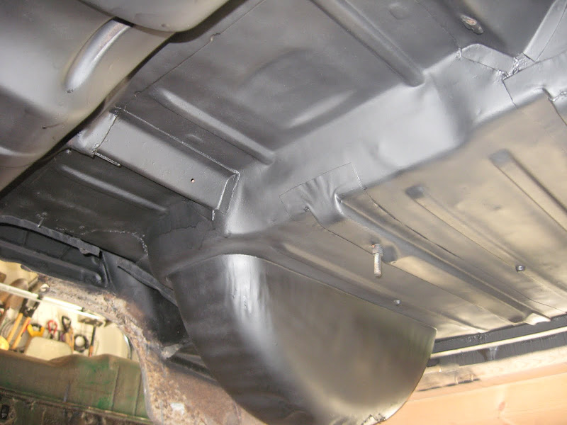

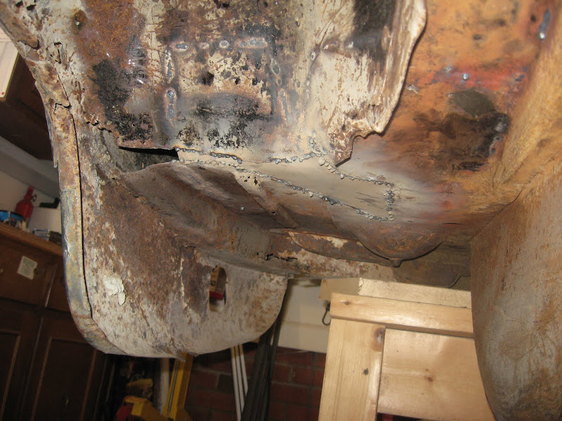

    Rt. rear trunk from underneath

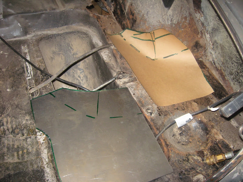

    Some more of my plebish fabrication skills :eek:

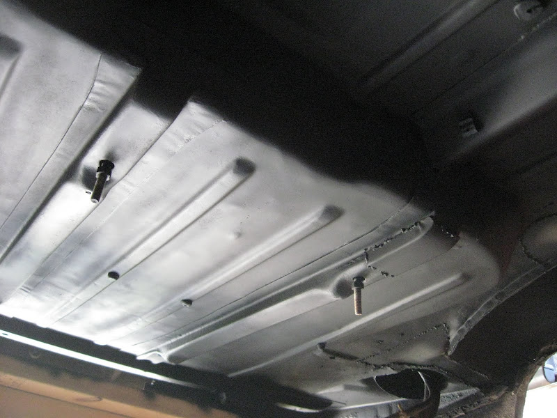

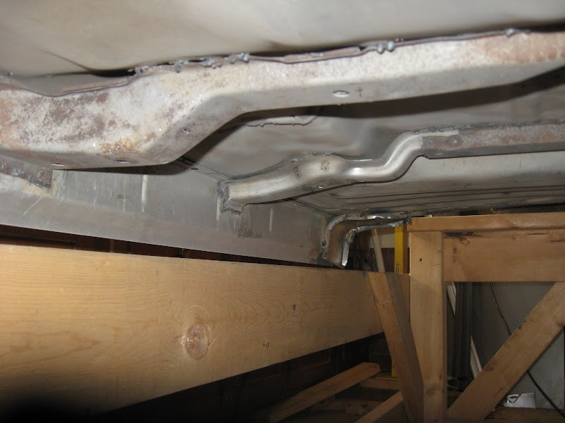

    Under trunk pan . . . cleaned up pretty good :)

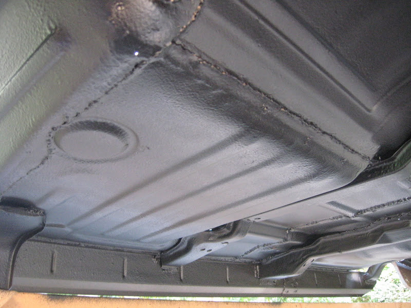

    With the floor pans 95% complete, it was back to sandblasting the body. Still have plenty to complete, doors, fenders, trunk lid, hood . . .:p
    And as you can see, I cheated on the roof. That's as far as this plebe is going on the damn roof. Will feather it out with sandpaper . . . and so what if it's not show quality. It's not a show car!! It's a driver, baby!!:D
    Oh, and did I say . . . sandblasting sucks!!
