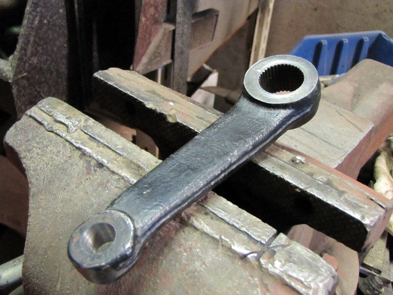

    Anyway,here is the victim and the OEM steering arm:
    I bought a tie rod end reamer from Speedway and reamed the Volvo arm to match with the Ford tie rod ends.I saw off the the Volvo factory "extension" piece,after the reaming job was done.It could been pretty hard to clamp it to vice without the extension piece.
    Here is the finished(i guess Volvo guys would say ruined:D ) steering arm:

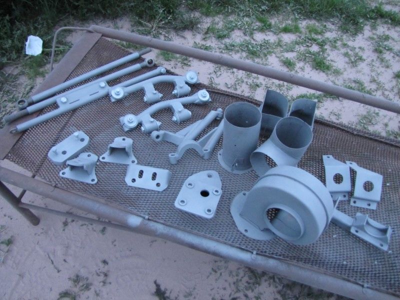

    I picked up my stuff from the powdercoater:
    I guess that wasnt the last batch for powdercoating.

    It was the 1-1/2" per foot,7 degree reamer.I paid 80$ of it and it worked nicely.

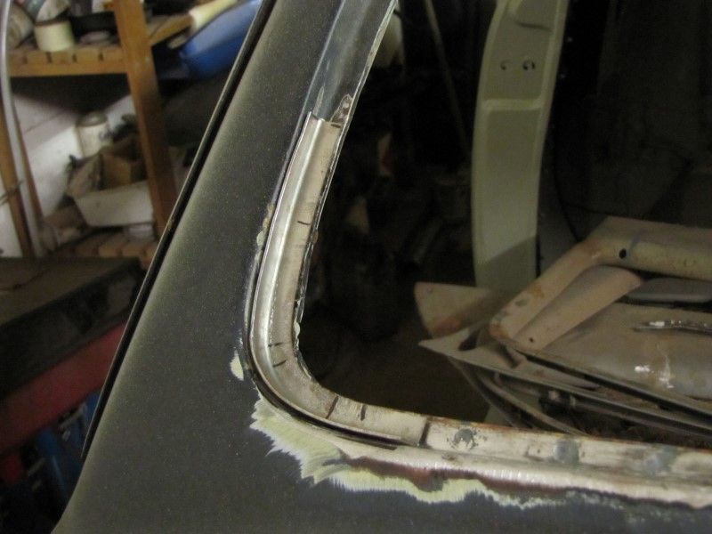

    Few pages ago i said the rust issues are over.Yep,me and my big mouth.
    I knew that there was some deep pitting on the windshield opening,i thought it was ok.
    Well,i was wrong.There was few pinholes too and its not going to be better,if i leave it alone..
    I made a patch to the opening,it needed a slight stretching with shrinker/stretcher because the windshield opening is curvy.
    Some testfitting:
    The crappy piece is cut off and the replacement piece is spotwelded with few tackwelds too:
    And the weldings and finishing are done:
    That was pretty easy job.I noticed that the passengers side windshield opening corner needs some attention,i guess thats a bit more challenging job to do..

    A small update,i got the window opening fixed.
    It wasnt so bad job to do than i thought.Made a patch with the shrinker/stretcher:
    Then cut the crappy piece off:
    And welded the patch:
    I dont say that the wrestling with pitted crap is over,but i sure hope so..
