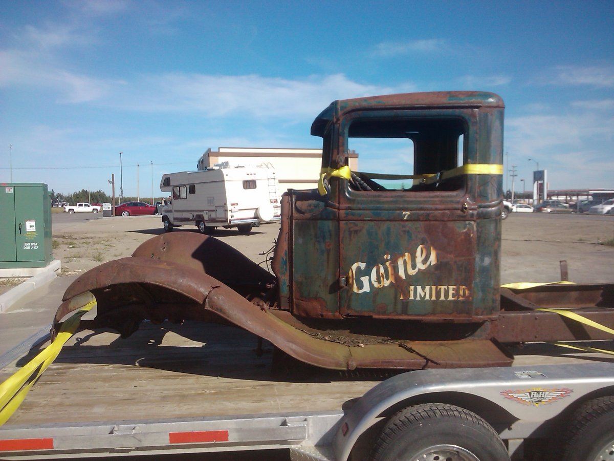

  1. 2012-08-26 16.53.23.jpg 2012, The meat truck
    I have always thought the 32-34 Ford trucks to be the best looking HotRod truck, and have always wanted one, but never found one in my range.
    One came up for sale about 3 hours north of where I live, and although it was a BB 1 1/2 ton, it was a '33, my favorite year. So a deal was done and brought it home. It was really rough, and missing lots, but I was real happy to finally get one. So, I got the body off the frame, and started gathering parts for it as a future build, since I was building a 39 GMC COE at the time.
    Gainers was a meat processing plant, this had been one of their fleet many years ago, so I called it the meat truck.
    So the parts hunt got under way, 34 frame, hood, grille, 40 banjo, 35 wires,rough box sides, 51 Mercury flathead, yeah, the parts pile was coming together.

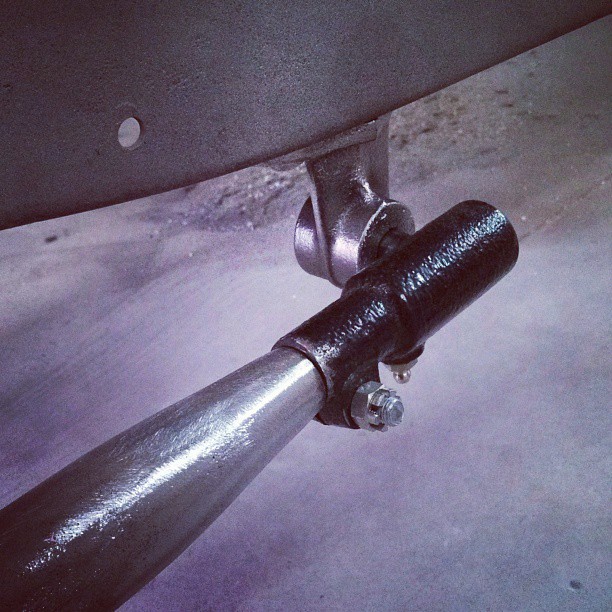

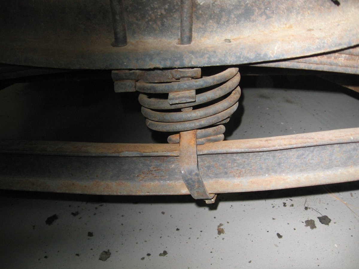

    This truck was a non running banger, and the frame was heavily rusted where the X meets the rails, it did come with another 33 rolling frame which was very nice.
    Brought it all home, and the tear down began.

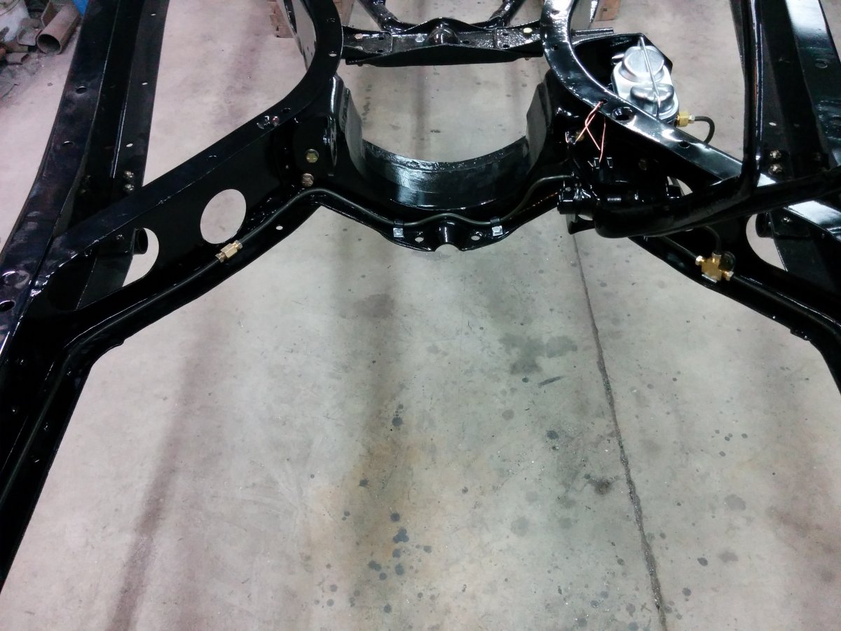

  6. Part 6 Once everything had been torn apart and the banger sold, the rest organized, the real fun began.
    A lot of sandblasting, yay!
    I knew I wouldn't be happy knowing there was rust between the frame rails and inner X, so all the rivets got drilled out and all the parts were seperated.
    Once all the sandblasting was done, the wheels got epoxy primed and painted with U Tech single stage black. I had to have Firestone dirt trackers, they kind of get the big and little look I wanted nailed down.
    Then the frame mock up began. I sent the axle to Greg Haynes to be dropped,
    Then I built motor mounts, split bone mounts, transmission mount, rear bones using 40 radius rods, rear torque arms also using 40 radius rods, brake master mount 11282660_1414047175587226_1357509122_n.jpg 11326627_1452655475046941_1047108321_n.jpg Screenshot_2015-04-04-09-52-00~2.jpg 11282792_455980594563537_771536443_n.jpg 11378558_949549965107541_913146244_n.jpg
    I'll let the pictures speak

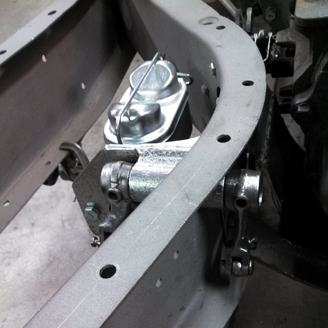

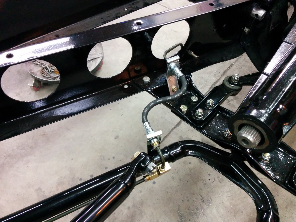

  7. 11380138_377931075746258_769501483_n.jpg Part 7 More pictures
    I used the '33 spindles and dropped the steering arms, used the stock perches
    and decided to leave the mech brake tab on.
    I didn't want to drill any additional holes in the frame, so everything I built
    had to work with that constraint. Also, most of the brake linkage was original 33 mech brake parts. I also rebuilt my pedal assembly with new shaft, bushings and brazing up wear areas. Did the full rebuild on the 33 steering box as well. 11381421_380400318831176_1890688734_n.jpg 11333417_106514959685582_1997702607_n.jpg 11326744_992790804066049_191090677_n.jpg 11243835_1841930959365533_1651951946_n.jpg 11324416_1614066375539406_858106356_n.jpg 11325860_370748489789669_351409733_n.jpg 1922022_215947255270325_1138654306_n.jpg 927573_293825290765508_1720675609_n.jpg 1741948_1497705190456284_1077720584_n.jpg 11358123_515560928592699_99019516_n.jpg 11313726_793473484107616_1500033342_n.jpg

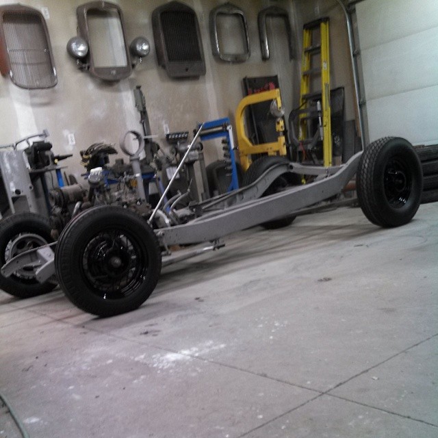

  8. IMG_20140509_144509.jpg IMG_20140423_202908.jpg Part 8 Whistling past the graveyard
    Now it's September 2013 and the truck mock up is very close to being done,
    the train of motivation is full steam and LSRU 2014 is a very realistic goal.
    Then life derailed me, I was diagnosed with stage 4 MCL cancer and given 16 months without treatment, and during testing for stem cell transplant, it was discovered that i've had a massive heart attack that was misdiagnosed as bronchitis.
    Projects and life in general got put on hold for 6 months while I went into chemo and figured out how things were going to pan out.
    The cancer went into remission and the heart is, for lack of a better term, fucked, but at this time, still being on chemo complicates what they can do about that.
    But hell, lets talk Hotrods, not health, they are way more fun!!!
    So I dove back into the project in late February 2014 and finished the mock up that remained, then blew it all apart and started epoxy and painting batches of parts.
    My friend Adam and I talked about flying to Austin for Round Up, but I couldn't cause I was in chemo,and wouldn't do that, The only way I would go to Austin is if there was an epic road trip in the rearview mirror.
    These are a couple pics of the end of mock up, I needed to do some shoehorning to get the stock 33 fan to run off the generator, and have the hood fit as it should. I wasn't going to alter sheet metal to have clearance for the engine/fan

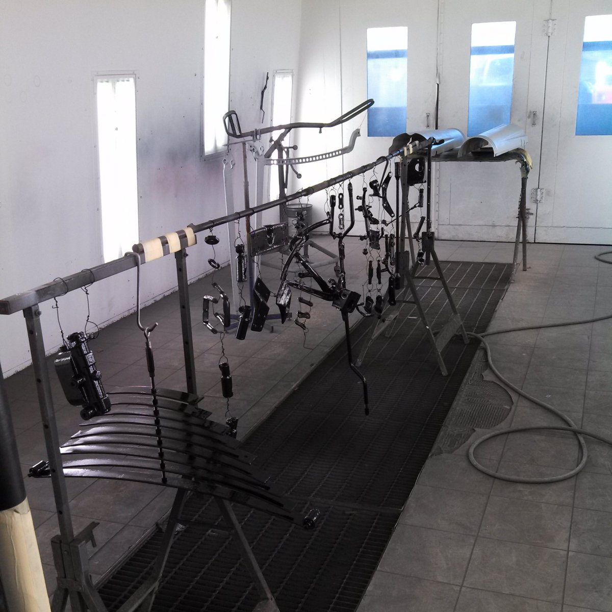

  9. IMG_20141129_134628.jpg IMG_20141108_105439.jpg IMG_20141109_213509_446.jpg Part 9 Pull the trigger
    I am in the restoration industry, and have been a painter for a lot of my career, did a stint as a paint rep for Sikkens, as such, I know a lot of shop owners and was able to use a friends booth on weekends. I typically do a lot of priming and blocking and priming and blocking on my customer projects, but the vision on this wasn't that, so, it was kind of hard to just blast, buzz down, ep and paint all this stuff, seeing things I felt should be surfaced.
    So I just pulled the trigger and made it all black.
    The batches of parts piled up, and every weekend another batch came home, being a single dad, why wouldn't I lay it all out in my house?
    I remember my daughter standing there, looking at it all and saying " are these parts going to be here much longer?" I replied, "define much longer?"

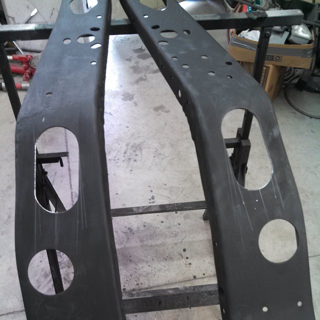

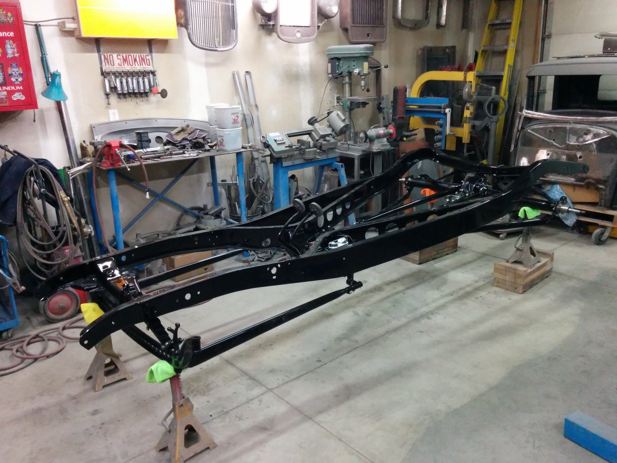

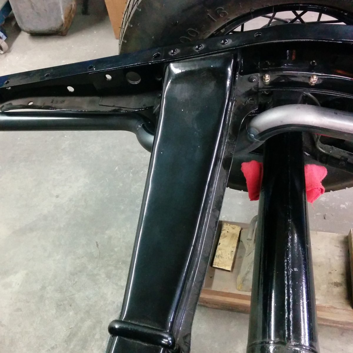

  10. 10755892_1501075723505812_1165238071_n.jpg 10809541_534971049939108_104942332_n.jpg 10809665_787227231338209_1534590177_n.jpg 1517024_284889005054443_1798775388_n.jpg 10895506_337467943127363_848291332_n.jpg Part 10 The frame
    As mentioned before, I totally separated all the frame parts and sandblasted everything. During mock up, I used bolts to hold it all together.
    I ordered a pile of nos rivets from Roy Nacewicz and geared up to put it all back together as Ford did. I laid out all the parts and brushed a liberal amount of epoxy primer on, then I brushed a bunch more on.
    I took a few chunks of the old frame and set about practice riveting.
    Within 8 rivets, I was getting the result I wanted.
    I Looked the parts over and knowing I was going to run the exhaust through the rails, I did a slight modification to the front of the X structure for clearance. I really didn't want to modify the frame, but I wanted the exhaust hanging below it even less.
    My friend Adam came over one night and we talked about how it was going to go riveting, and each persons role. We had a crazy system of doing it and we had about 25 rivets done in an hour and a half.
    I made this little rivet jack to go up in the rails to hold the rivet up while we formed the head. He would take a bolt out, and put a rivet in, I would place the jack or bucking plate in place, he would heat the rivet, I would grab the air hammer, 3 shots of heat and air hammer, on to the next one!
    Once the frame was all riveted, I epoxy primed all the areas affected by heat and surfaced the sides of the rails that you would see if it had fenders on it.
    I got frustrated with the logistics of taking it to a booth to paint, so I ended up hanging a ghetto booth in my garage and painting it in there.

  20. Thanks everyone!
    I built the bone mounts out of the original '33 mech brake cross shaft pivot mount,
    Don't know if designed is the right word as much as just saw them in something else.

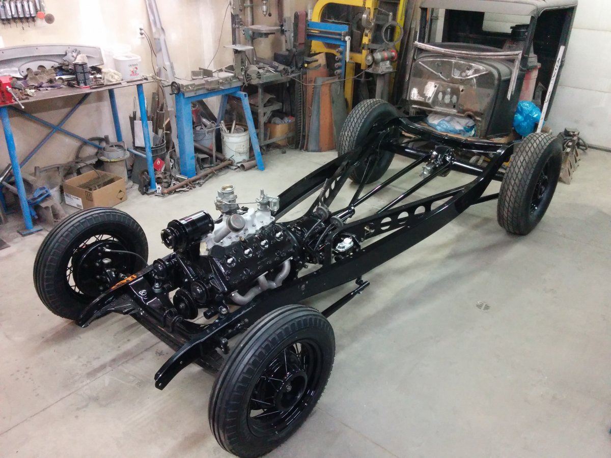

  28. Part 11 Just put it all back together. Drill bits and cotter pins
    When I bought my 51 Merc flathead, I fired it up on a stand, it ran really nice, had good oil pressure, compression test showed well. All I did to it was re gasket it, including head gaskets. Checked to make sure it was 4" stroke, yup! My father had some old Fords and the gasket set I used was new unopened that he had bought in the 70's. That was cool.
    10597281_1516399608589933_710267275_n.jpg 11005034_835648396501174_578526358_n.jpg IMG_20150222_225117.jpg IMG_20150324_174053.jpg IMG_20150317_112921.jpg IMG_20150312_211900.jpg
    I cleaned up the engine, scraped what little bit of carbon it had, found an engine rebuilder tag on it, it's been bored .030. Bought rebuild kits for the water pumps, and installed them. Painted it and the transmission black.
    The 40 banjo was at my differential guys place getting reassembled with all new bearings and seals.
    It is a 3:78, he was amazed how nice all the gears inside were, I was pretty happy about that too.
    So all the parts were black and ready to go.
    The vision for this build was to use all fine thread fasteners and castle nuts with cotter pins.
    A lot of drill bits and cotter pins were used, and I can say, i'm pretty much over the cotter pin thing right now. Some things I made a jig to drill the bolts, others just got clamped in the vice and drilled.
    Bit by bit, bolts got tightened and cotter pins bent over and it started to come together.
