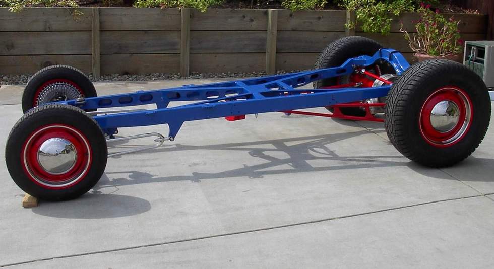

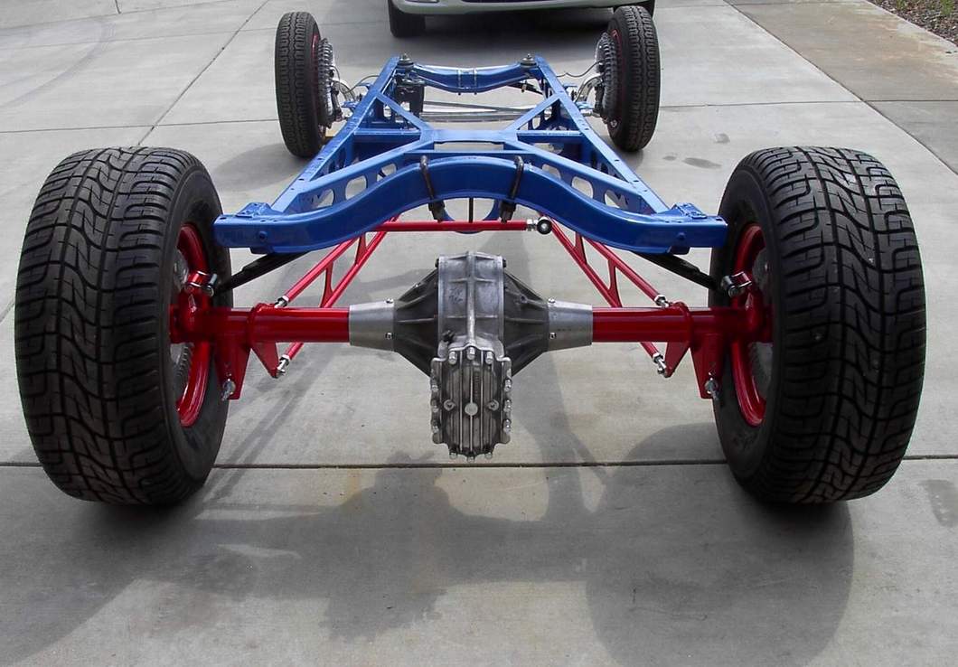

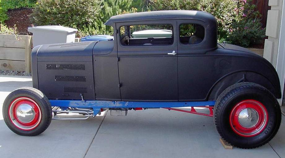

    Here are two pictures, one showing the Coupe unloaded (in black primer) and one with a loaded chassis (bare metal with a yellow strip on the door), I don't have to worry about notching the frame because my crossmember is 3" further up than stock.
    Let me know how I can help.
