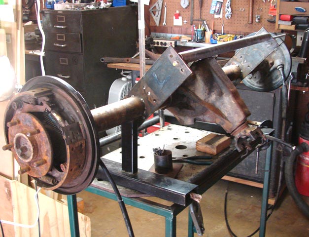

    Remind me never again to predict how long something is going to take.... Axle half skip-stitched after five days
    Interesting moment this morning. I had the TIG cables looped around my shoulders, leaning in on the first weld of the day, when the cooling-water-tube burst. Doused in five seconds, and nearly fell off the stool, arc and all!

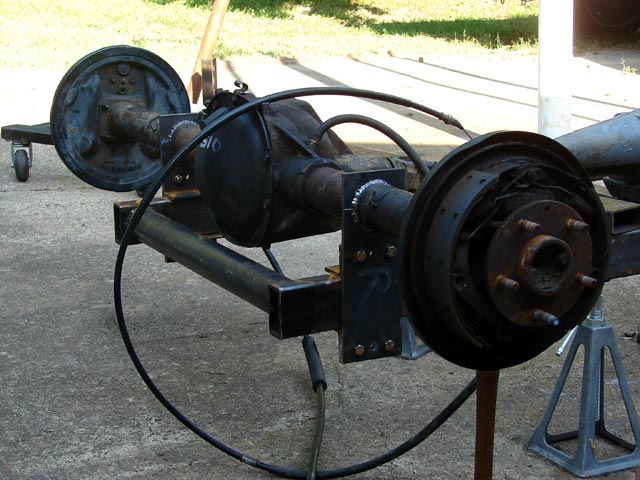

    The rear axle is in place. Welds are not as go-rilla as they appear in photos..... honest

    Looks nice & strong. Many of the west coast guys are at Eagle Field so you might not get too many comments this weekend.
    I'm glad you didn't vaporize yourself.

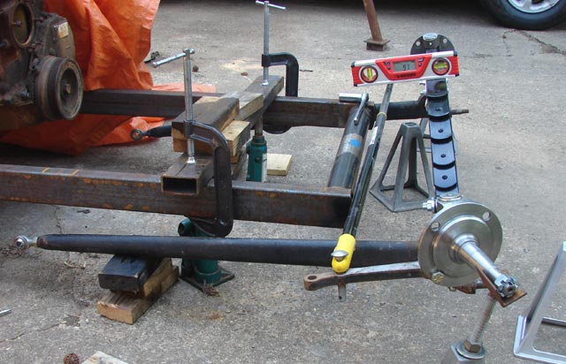

    Mock-up for wishbone anchor location. Does NHRA have any unwritten rules regarding suspension points falling below the rim line? Other than on and off the trailer, will three inch ground clearance work? I know I can pie-cut the wishbones, but won't unless I have to!
  15. bobw
    Joined: Mar 24, 2006
    Posts: 2,376
    bobw
    From my 2008 Rule Book: 3" of ground clearance from front of car to 12" behind the centerline of the front axle. 2" of clearance for the remainder of the car. Wheelie bars can be lower.

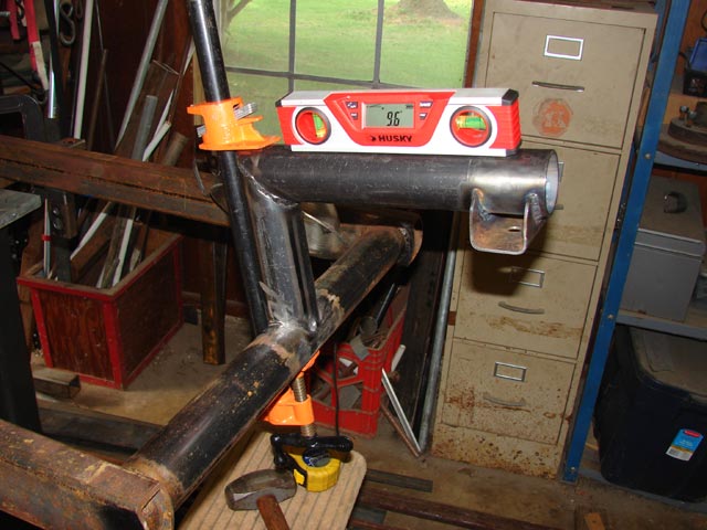

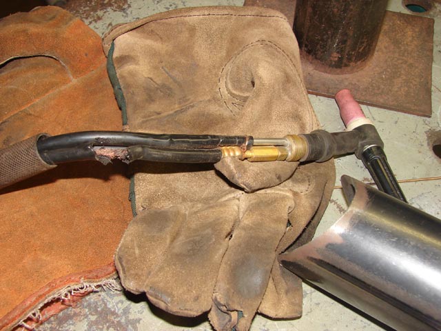

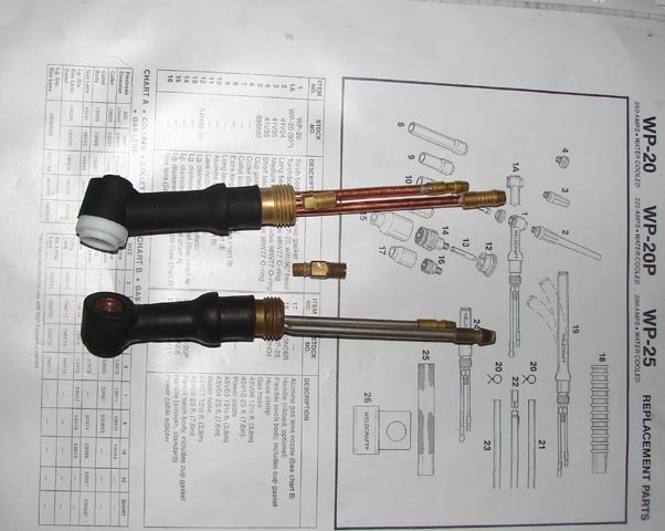

    Part one of Frankenbracket fabrication. Part one because burning in mitered-beveled-butt-weld in 1/4" pipe was a bit more heat than power lead insulation could handle!

  19. P-Dog
    Joined: Mar 12, 2009
    Posts: 43
    P-Dog
    You don't have a water cooled torch?
    I don't have any trouble with my water cooled set up all the way to 300AMPS.
    The Inquiring P-Dog.....

    Third DodgeBrother
    The Spirit of the Bug = rectangular tube and Home Depot water pipe!
    I'll have a new cooling tube (see post 61) and power lead installed this afternoon, in time for the two hour welding season tomorrow morning.

    Never,never,never ask your wife to hold the hex on the torch body while you tighten a new power lead in place. New torch bodies cost $49. Don't ask me how I know.

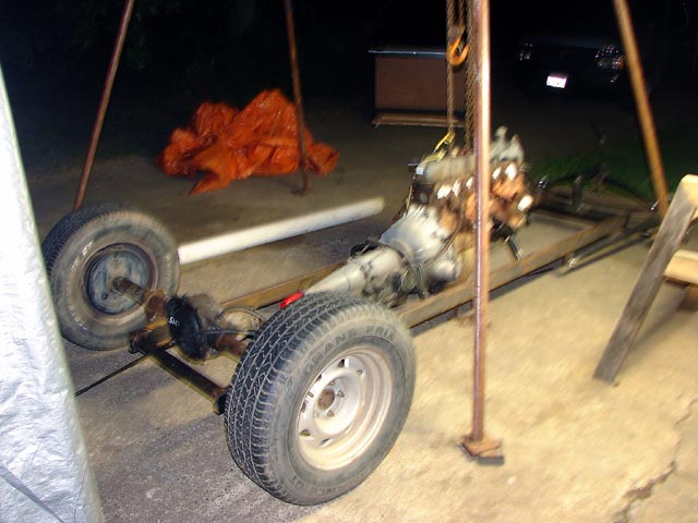

    Need to finish weld the spring hanger baseplate, replace motor and rear axle, get the whole mess out of the way, and in the shed, so I can get the teardrop out and on the road. All before eight tomorrow morning!
    Wish me luck!

    Tulsa.... We have a roller.... kinda, sorta

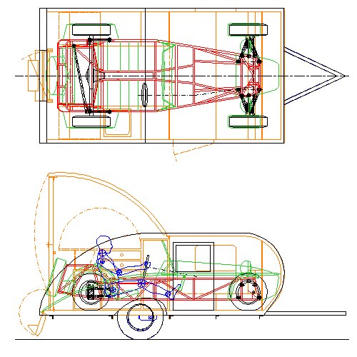

    Old 28
    One of my other projects is a Lotus Seven clone: Have this in mind for transport...
