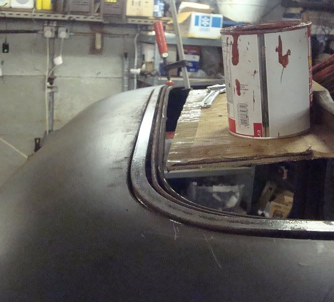

    Here's the roof opening with the wooden bows still intact. These are worth keeping because you tack the headlining to them.
    I wanted to make a template to show the curvature of the roof. I had a brainwave -
    That's it - use a piece of ply with screws screwed through until they just touch the metal surface, or the wooden bows. This worked really well, because each screw is finely adjustable, plus it was cheap and quick to make.
    I took it to the local scrappy (Mick Merrill for anyone local) and tried it on various bonnets. Why bonnets, I hear you say, and not roofs?? Well, two reasons, if a bonnet will do it, it's easily removed and transported, plus the cars are stacked two high so the lower roofs are inaccessible and the upper level too high. Bonnets are easy.
    So around I went, trying this and that, and there were only a few with an area big enough, without flutes or ridges, and only really one, that came close to the profile as dictated by my super accurate template.

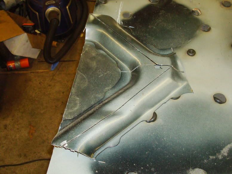

    I cut through the outer skin and chopped out the inner panels. I had to carefully trim the inner panels so I could break the gluey blobs holding inner and outer together.
    A few pics:

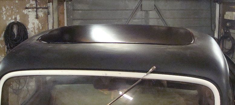

    But here is a parting shot with the new lid resting in place.
    I don't think I could have got a better profile if I had wheeled one up from scratch.

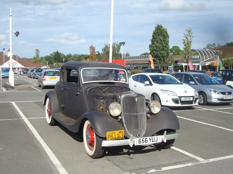

    I waited what seemed like an eternity for today, and was so pleased to at last be able to drive it. So pleased, I didn't even snatch a video.
    All I got was a couple of crappy pics in Tesco's car park.
    But that's the whole point, they were taken in Tesco's car park. Not in my back garden. And that makes a big difference!

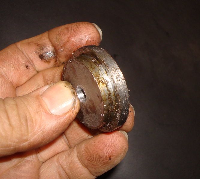

    And using a Y-block pulley in the vice I proceeded to bend it to suit the shape of the roof opening.
    Keep going, all the way around. It'n not as easy as the pics suggest, lots of tweaking and rebending.

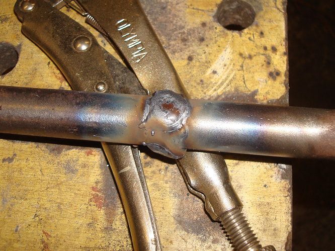

    I had to weld three pieces together.

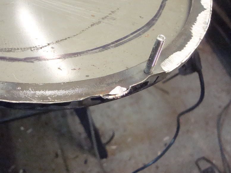

    The outer frame was then drilled in 20 places and the holes transferred to the tack strip and drilled through.
    I then countersunk the holes, tapped them and after turning the heads down a bit, inserted 20 10-32 UNF screws into the holes.
    I secured each one in place with weld and then ground the welds flat.

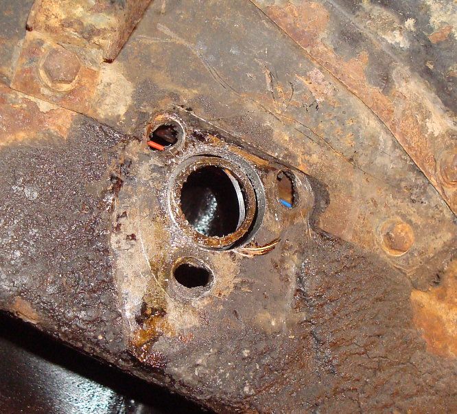

    To even get the box in place you have to enlarge the hole in the frame. Only the 1-1/8" shaft sticks through on the 33, so to get the casing and oil seal through needs a bigger hole.
    Here's the original hole.
