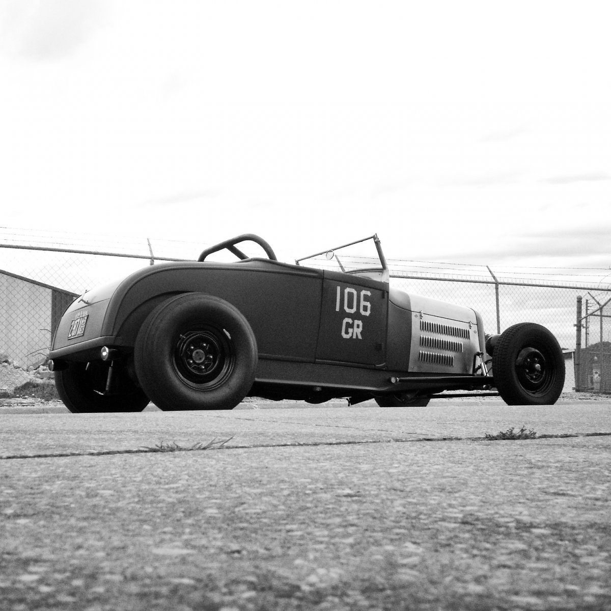

    It's been nearly a year since I updated this thread, so I figured it's about time!
    I haven't put nearly as many miles on the roadster this year, as in the past few (partially torn apart). Last winter I decided to start gathering parts to put a top on the car. With the Hallock windshield, it would've been very hard to make a top look good, so I also decided to change to a chopped and leaned back Model A windshield. Well, that also lead to changing the dash!
    The Hallock now lives on a very cool flathead powered traditional RPU in England.
    I ended up with a 4" chop and leaned back approx. 16 degrees from stock. I started with 2" chopped stanchions, so not real sure if they were stock 'lean'.
    The dash is a '32 style dash.
    I designed the gauge panel and had my friend TJ @junkboys machine it out of aluminum plate.
    Eric at Pinkee's Rod Shop was kind enough to send me the dash rail and stanchion mount pieces that were cut off his roadster project.
    It took quite a bit of work to make everything fit together, but I'm very happy with the results.
    A few photos ----
    (will take some better ones soon to add, including side profile)
    (above photo by Tom Davison)
