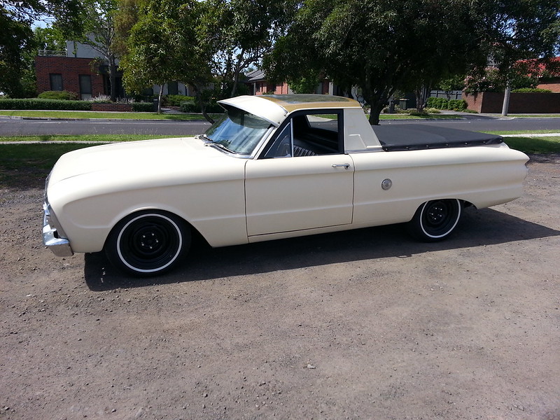

    So, I bought this to keep my 65 sedan company :
    Its a 1964 XM Ford Falcon ute. (or is that Ranchero?!)
    Actually been looking for ages to find a half decent early Falcon ute. It ended up being the least rusty one I could find in my search over the last 10 months. Its actually really straight, the tray is in really great shape, no dents and it looks quite good from 10 feet away Lol.
    Sp, it has bit of a custom look but I have toned it down a little since buying it and tried to make it a bit more hot rod. The metal gold flake is quite in your face but its kind of cool. I think I might paint the B pillar sides the same cream body color though but keep the roof as it is. Im not sure about the pin striping, its cool but a bit busy looking? The gold flake inlay on the seats is rather bright in the sun but they are one of those things the more you look at the more used to it you become. Gives it a bit of character I suppose!
    It has a 69 221 pre cross flow engine, Borg Warner 35 3 speed auto with T bar floor shifter, headers, twin exhaust, later model falcon radiator with twin electric fans, stock drum brakes and stock diff. Interior has Mercury Comet metal chrome dash surround and I have swapped my steering wheel over to make it a bit more roomy in the cabin, as I am quite tall and these things are not renowned for there interior space.
    It drives pretty good, better than I thought it would! ha-ha. I need to do a few more little things but for now its a good useable ute to have some fun in, plus it was already registered, That was actually the selling point as made it easy to get in my name, so pretty happy with that :)

    Cheers! Yeah, I actually painted the a and b pillars the same cream body color today, looks much better. Just got to paint the visor now and it will be sorted.

    Looks much better I think now, although need to do the door frames next.

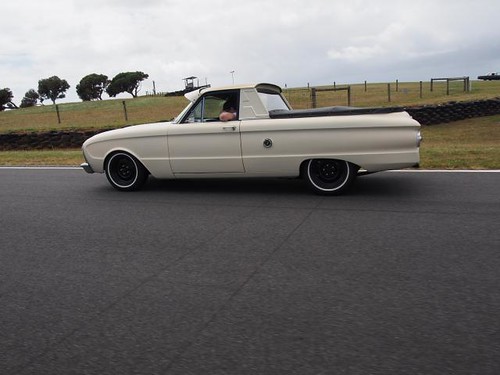

    Took the ute to the Kustom Nats at Phillip Island here in Australia recently, was a good trip, no problems the whole journey there and back.
    Cruised down with my mate in his 63 Galaxie wagon. That thing is huge!
    Was a great event, lots of cool cars were there at the racetrack. They actually let us out for a cruise, although most were taking it pretty easy apart from the gassers giving it bit of a squirt on the main straights haha.

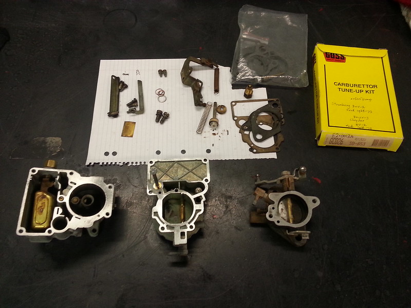

    Anyway, the carb was leaking a bit of fuel. I pulled it apart, gave it a big clean out and fitted a new kit through it. Seem's to be a bit better idling now as well when its hot, although the idle jet is pretty worn on the needle itself but it will do for now. At least its stopped dripping precious fuel onto the exhaust.

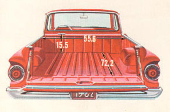

    In regard to your bed question, US Falcon Ranchero beds are completely different. Our Ranchero is a 2 door wagon with the roof chopped off aft of the 'B' pillar and a bulkhead added, that's it. A large steel panel is screwed in over the rear seat and floor pan section to make a flat bed making in stock form a useless cavity.
    Looks like Ford AU had utility in mind by starting with a 4 door body, moving the gas tank forward of the rear axle, and designing a new floor pan to give not only a longer bed but also lower resulting in deeper bed sides.
    Some drawings from Ford and a picture to show ours: BedDimensionsSide.jpg
