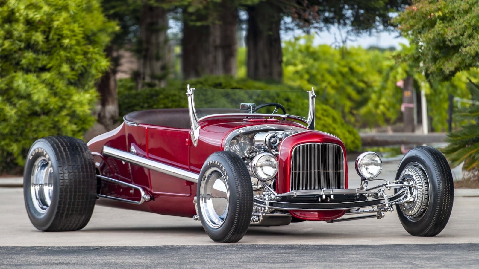

    This is a thread to document the joys and challenges of building my early T roadster.
    I've wanted an early T roadster ever since I saw Eric Anderson's original build thread on here.

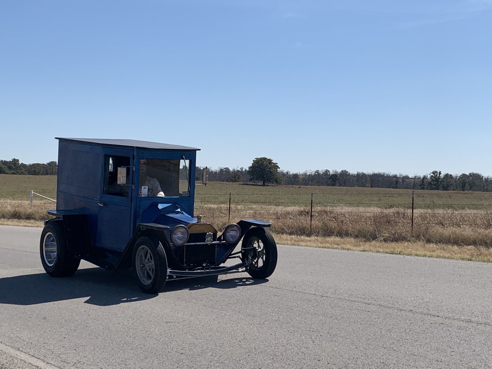

  14. Tim
    Joined: Mar 2, 2001
    Posts: 17,220
    Tim
    from KCMO
    Joey likes cramped spaces he’ll be ok.
    his blue car shown is so small that when he drives he can use both sides arm rests at the same time. TINY little car 2C7F9313-6350-4E84-B368-4F3B1680AA19.jpeg
    Vic Walter, Jet96, winduptoy and 2 others like this.
