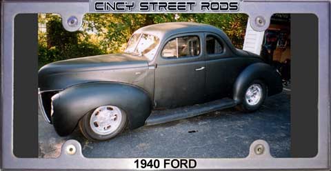

    WOW this is so cool.... because that car was my dads car!!!! I can tell by the roof that looks like a roof caved it on it (because it did) and the wheel tubs in the back. We had a house fire Oct 2007 and lost almost everything ( including that '40). That car was one of my dads favorites. It was flat back with beautiful halibrands on it, finished interior (matte black plether), 383sbc w/4speed. I am so happy to see it being worked on!!!
    Pm me if you want some more info on it. I included the best pic i could find of it when we had it.

    Yeah, this is your dad's old car. I'm sorry for the loss you suffered in the fire. I had never seen the car before the fire. It looks like it was a nice ride.
    I don't know how many hands it's passed through since the fire, I got it from Chris at BAR Customs and he got it from Oney. Chris is building a gasser and found a complete roller at an auction so he wanted to sell this one. Chris kept the burnt doors and hood and I got the ones off the car he bought so it's only rust on those. I think Oney kept the rolling chassis.
    I'd had my eye on it since Chris got it wanting to see how the repairs would turn out, but he never really got started. I always wanted to try to see if I could do it. Now Ive got my chance. If you ever want to stop by and see it you're welcome. PM me for directions.
