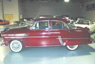

    Went pictures surfing... I think this is basically what my '54 Hudson "Jetliner" looked like when new. The guy that helped build it said he kept the continental kit from it back in the day (doubt he still has any of the parts):
