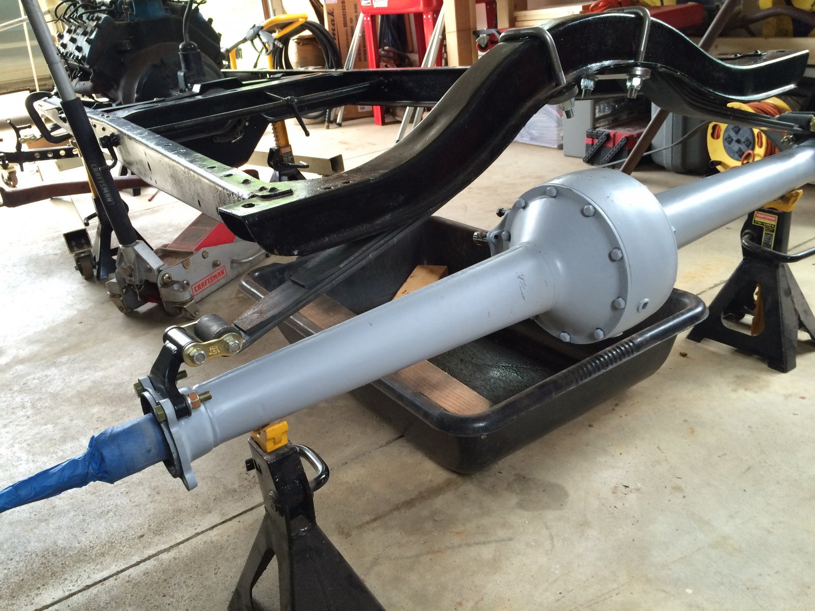

    Maybe someone will have better pictures and answers for you, but this will get you started. The model a frame under my 27 has a T spring in back, so you can sort of judge from these pictures how much it drops it down. A lot depends on how many leaves you keep, I eliminated some of them to soften the ride.

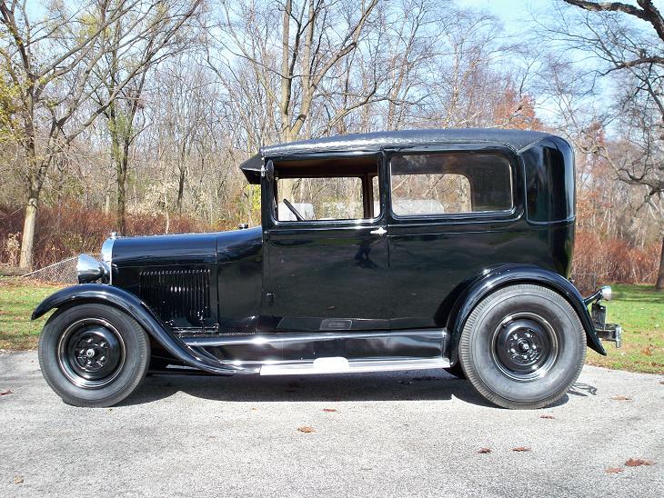

    PO Russ put a T spring on my car with leaves 3 and 5 removed. With a 7.50 x 16 tire hard to go lower. Rides really good for a model A Ive been told. Beats me, its my first.

    Nice stance! Has the frame been z'd in the rear ?

    It is a brand new model t type spring, not original one. I can see your point on the sagging height variation if original.

    Nice stance on the two black A's shown above. You guys must have smooth roads because it appears to be limited suspension travel ?
