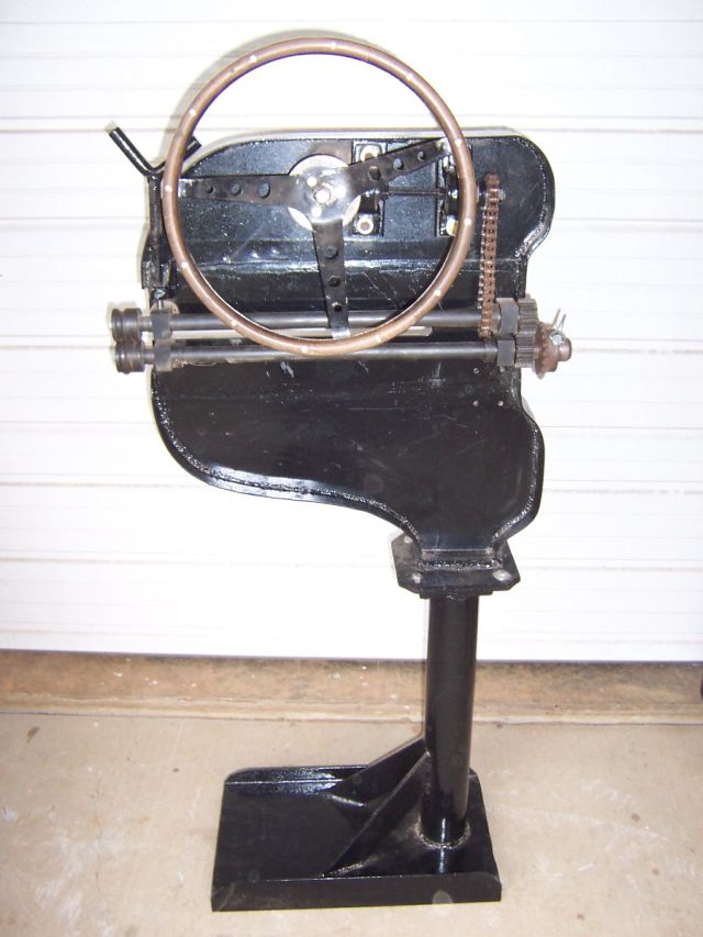

  19. Here is my try at a Bead Roller. I got a HF roller for free and had a lot of Mobile home 12" I-Beam so I used what I had. I tried the crank & steering wheel on the back side and didn't like the awkward feel so I put a chain drive off a 90 degree gear drive so the wheel is close and above the panel. The back side has a gear reduction motor that drives the gear on the end with a hitch pin which I pull to free wheel the motor when hand operated. total cost $20 plus lots of my labor.

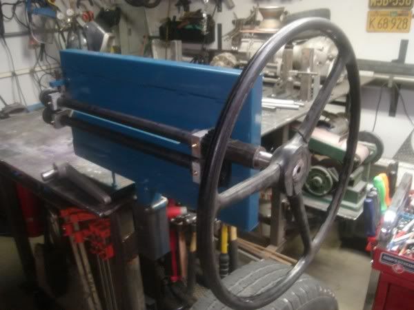

  22. C4 Metal Werks
    Joined: Mar 29, 2007
    Posts: 380
    C4 Metal Werks
    My wife got me a bead roller for Fathers day and I finally had a chance to take it out of the box and fidle with it.
    Made receiver socket on the side of my welding table as well.
    I'll finish the wheel this weekend.
    Some folks had asked for more pictures of a previous post
    http://s159.photobucket.com/albums/t121/bmweuro/Workshop/

  24. C4 Metal Werks
    Posts: 380
    C4 Metal Werks
    Finished it today
    Can use it with the steering wheel or handle
