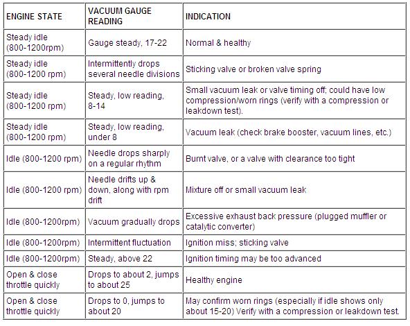

  6. Here's a chart with typical readings and possible causes of incorrect readings
  7. tommy
    Posts: 14,757
    tommy
    This is a manifold vacuum chart. This is always an argument but I've always used manifold vacuum for a vacuum advance. You don' get high vacuum readings shown in this chart using a ported vacuum port designed for smog motors.

  10. Yeah...I know that but as I said on my previous post it looks like his manifold at a steady 10 pounds is low.That's why I posted the chart.
