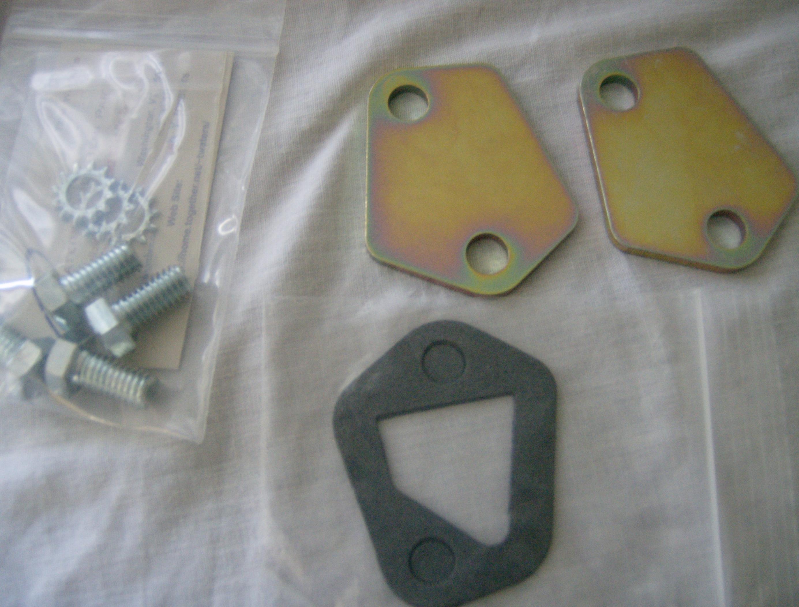

    I think I just spent a bunch of money on the wrong heads!!!
    So I bought a 354 project that somebody else gave up on, It came with a lot of Hot heads parts: timing cover, oil filter adapter and water crossover.
    I know I checked the casting#'s (block) and found it was a car engine.
    My intention is to make this a supercharged engine and had a great machine shop do everything to the block, balance the crank, used forged pistons, h-beam rods, roller cam etc, etc.
    I had not purchased the Intake manifold yet cause I've been trying to decide on the hot heads or wieand. Most likley going with wieand due to height, and this is not for a race application where every single horse is critical.
    After asembling the engine put the water crossover/ t-stat housing on the heads, but what do I do to seal up the ports in the rear of the heads? and also the machine shop just told me there are coolant ports in the heads that clearly take coolant to and from the intake manifold.!!
    The info I can find says Chrysler Hemi intakes are all dry. Similar to b/rb motors which I have built before. And it appears to be that way in the pictures.
    Did I get: truck, industrial or marine or Desoto heads? Maybe I only checked the block casting #'s(it's been a year) but I swear I checked heads too.
    Did I waste my $ on: new valves, seats, springs machining etc.??
    What do I have? what do I need? Now I'm wondering if I've even got the right head gaskets, and can use a supercharger intake. Ofcourse I went with a lower compression ratio as I planned on supercharging all along and I even have a 6-71 I already purchased so changing plans is going to waste a ton of $.
    Hemi Guru's please help!!!

    Pictures of your heads as well as the casting #s will get everybody going in the direction of helping you. Try the hemi index and post your question in the heads section.
    Later manifolds are dry, earlier manifolds are not.

    All of the heads have openings to the intake surface, the front ones lead to passages on the wet intakes & are sealed off in the rear, & sealed off front & rear on dry intakes. Block off plates for the 4rear end openings are available from Hot Heads & OEM ones show up on EBay. As was said, get to reading the Hemi Tech Index.

    Is this what you are looking for? If so, email me. Despite the misconception, there are others of us who sell early hemi parts.

    As to BrandApart's issues with the heads, you only need the intake gasket to seal the rail against the blower manifold since you want neither exhaust gas or water to pass so it really doesn't matter which head you have to start with.
    And yeah, some pics would be helpful.

    If you can't afford to buy the block-off plates :confused: then you can easily make them if you have some basic tooling.

    To Brand Apart. Email me and I will send you out a set of end plates, if those are what you need. Pay it forward here on the H.A.M.B.
    Tom
