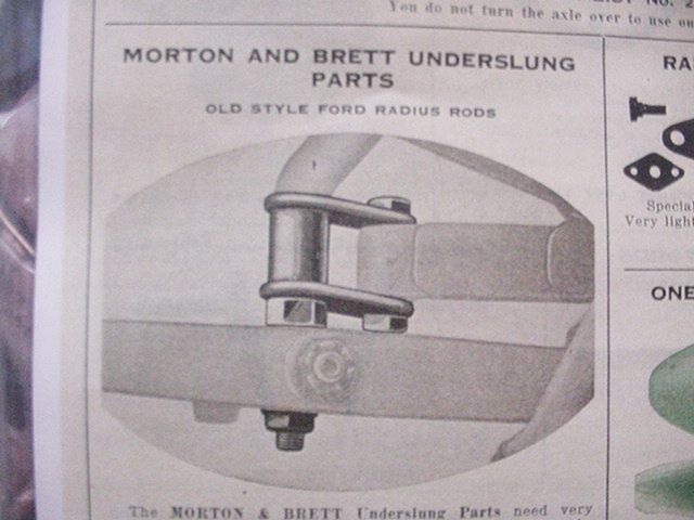

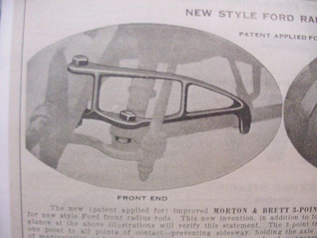

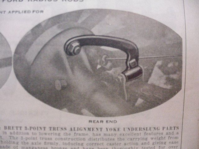

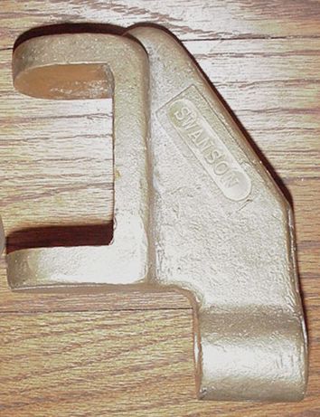

    This will become a great thread! Here are some Morton & Brett underslung brackets. If fiveohnicj2932 is planning on making more of those rear brackets I wouldn't mind having a set.

  25. Curious...what does everyone think of the 'laurel brackets' sold by antique T auto parts?

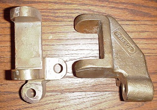

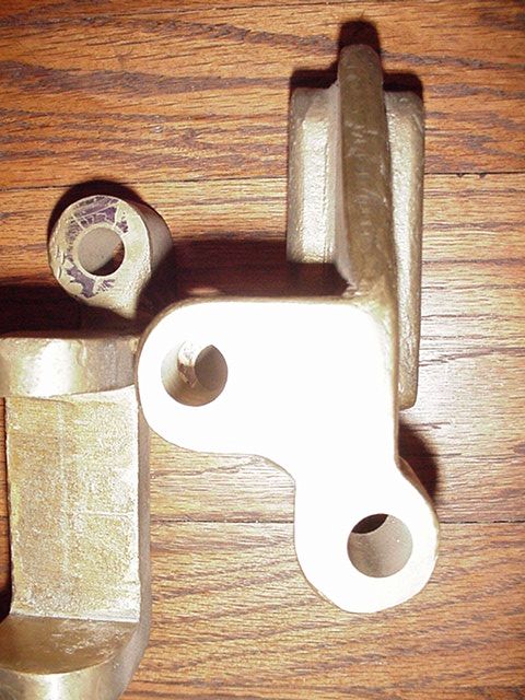

    I had an original pair of ROOF brackets that were well worn years ago. i bondoed the holes and had new ones cast in manganize bronze like the originals. still need to bore the hole to attach them to the axle. You need to use the early wishbone to make these work.. Did they offer these stamped LAUREL as well?:)

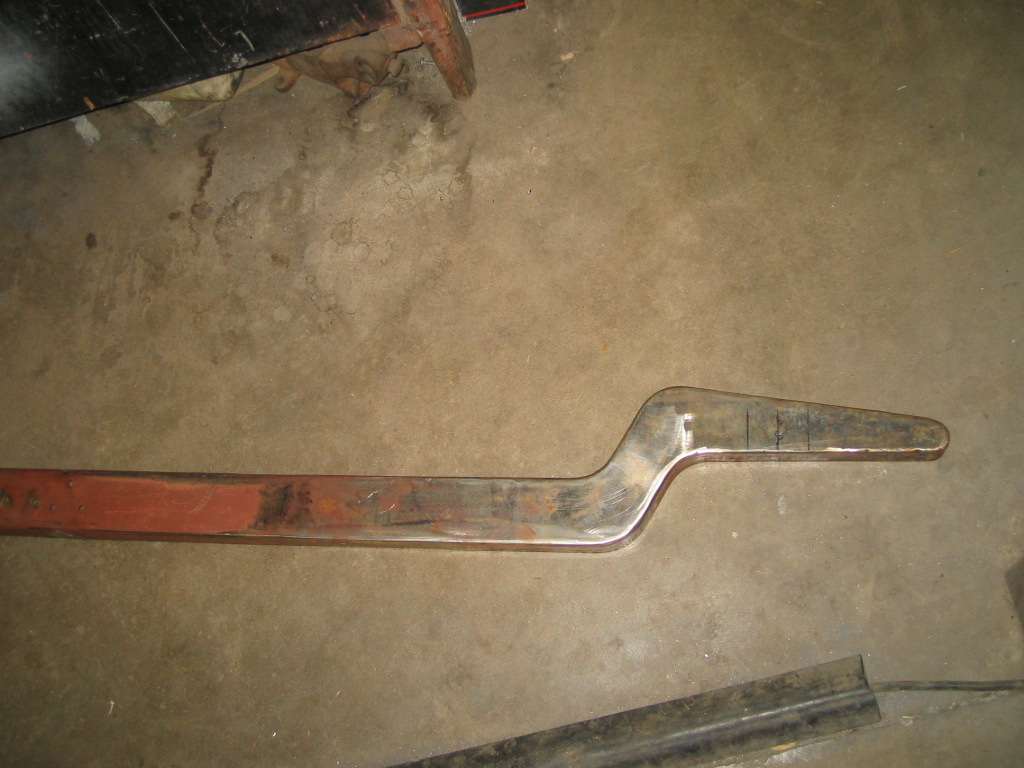

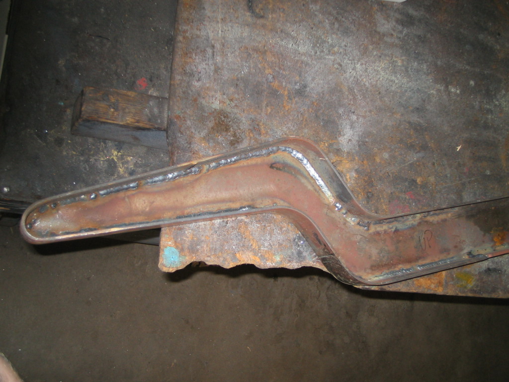

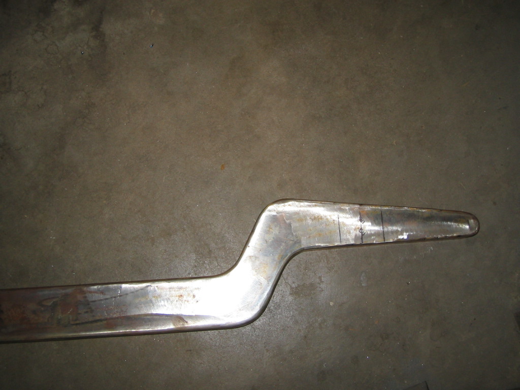

    Hey guys! I promised yesterday that I would post some pictures of the speedster chassis I'm working on. Here are the kick ups at the rear of the fame that I built up and grafted in. I haven't ground or finished the inside of the rails yet, so forgive things looking a bit rough.
    I didn't do a whole photo layout on the various steps of doing this, so I can't show every thing. But basically, I had Elpolacko here on the H.A.M.B. use his cnc plasma machine to cut out a pair of kickup plates that I designed. I then cut a section of 1/8"X 1 1/2" flat bar down to 1 3/8"and bent up the lips for the frame. I welded the whole perimeter on the inside first, let it cool, and flipped it over and filled the resultant "V" shape on the out side with a good hot weld. Ground the kick up to replicate the stock shape of the T rail. I then made my cuts on the stock rail and spliced in the new kick. I over lapped the upper and lower rails by six inches in either direction to help with strength. I will finish this with a small boxing plate inside the rail that spans the cut lines. I will be making the front cross member for this using this same technique this week, and I will take a bit of time and photograph the process if any body is interested.
