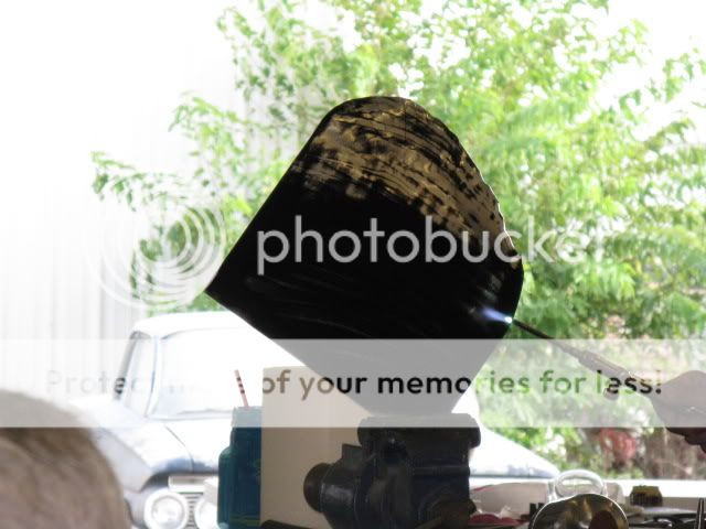

    Annealing aluminum. Use the soot from acetylene only as a guide coat, then slowly burn it off with a light feather flame (preferably on a fire brick table to speed the process)

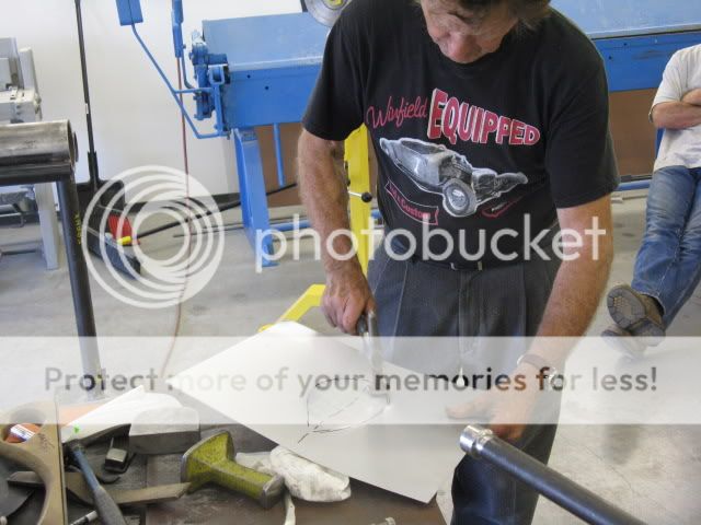

    Chopping a Truck Cab -
    Here are some diagram's from the Gene Winfield class, he is very much against the adding to the middle method, he says to cut the top of a neon, other car out, whatever has enough crown to it. you can make a cardboard template of your roof so you can find the closest curve profile out in the scrap yard.
    use that so you can hammer gas weld around the perimeter, less metal work and less chance of oil canning. he uses a tucking tool to pinch the corner down for the correct radius, rather than the multiple relief cut method.
    It works like a metal shrinker.
