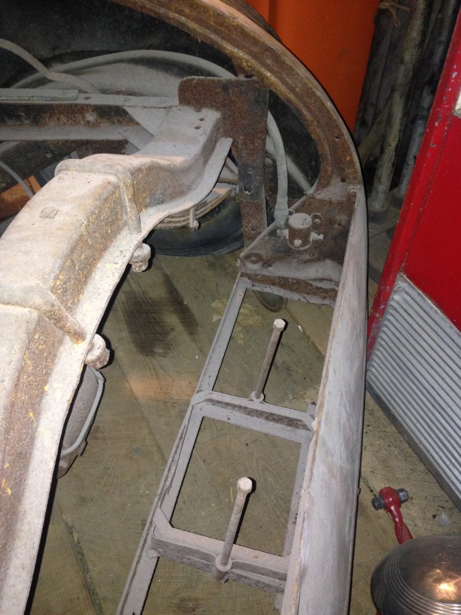

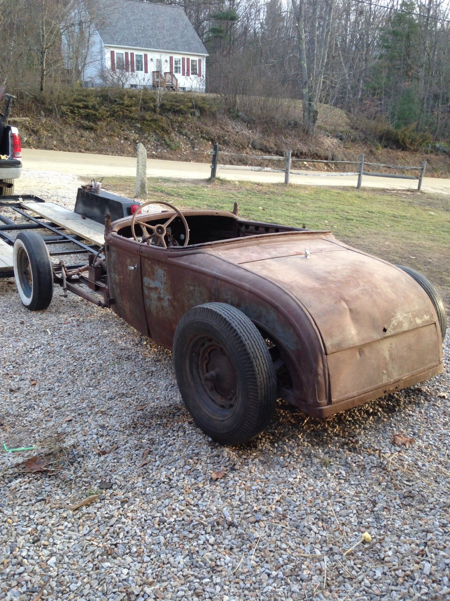

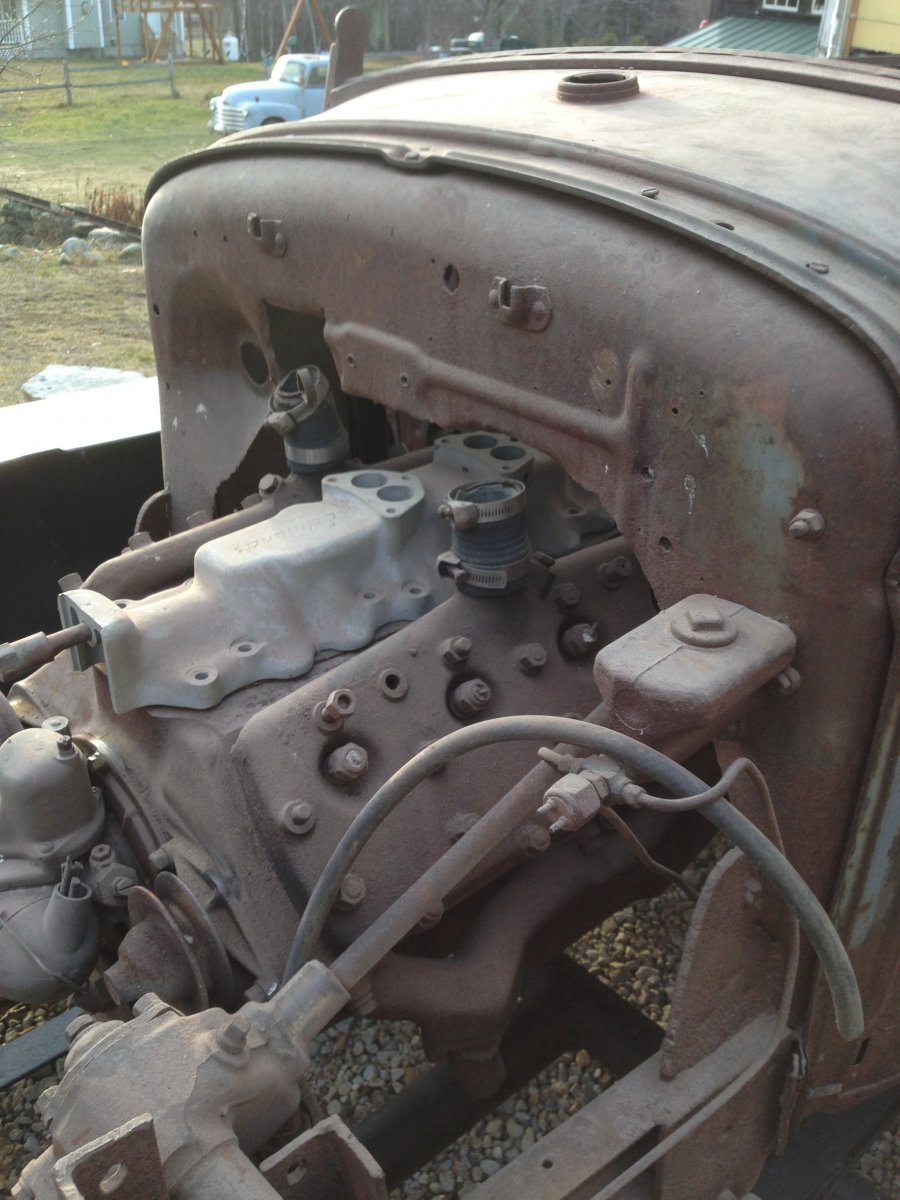

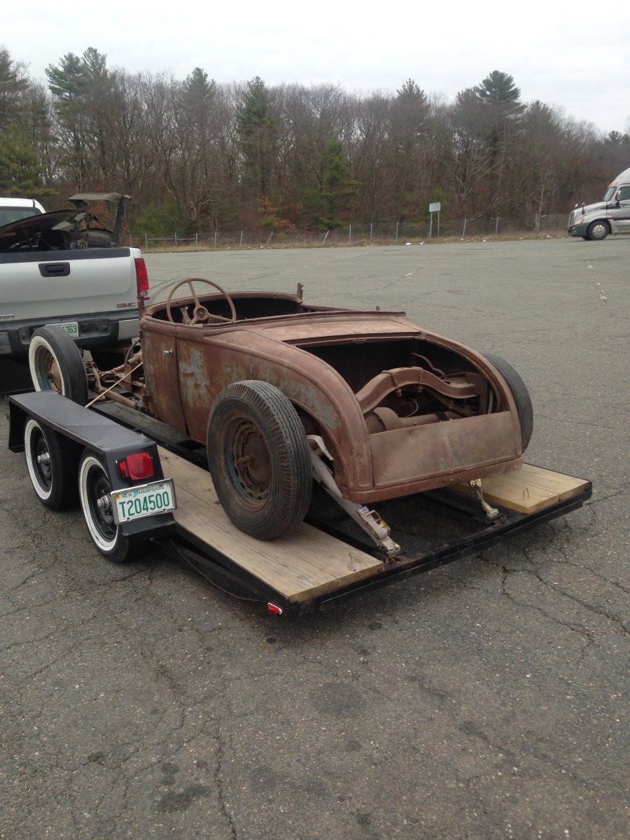

    Posting for a friend. He just purchased this one of a kind roadster and it trying to find any history on it.
    Here is what he wrote.
    30/31 roadster Said to have been built in NY in 55/56....inside out z'd Model A frame, adjustable height, suicide front end with a filled, dropped axle, reversed front spindles, heavy engine setback, 39 trans, heavy channel, partial belly pan under body, Edmunds custom 2/2 with one carb ahead and one behind the firewall, 39 juice brakes and an inverted Model A rear crossmember as a trans mount and a rear section of another Model A frame welded to the top of the inside out frame... To mount the rear axle, z'ing it even more!

  4. Killer find! Can't say that I've seen an inside out frame before. Any pictures of the rear Z?

    I like the Dadgum Reversed frame rails!
    (looks to be a late '31) and a Dee-Luxe by the cowl side light holes

  11. I'd probably stop just short of calling it a Drag race Land speed car being there is no sign of any saftey equipment at all. That might have been the Dream of it's future but I doubt it ever got there. In fact it looks like many other stalled out Dreams that never got finished. I doubt seriously it has ever turned a tire in it's current stage of Dream. I'll give ya that's a Way Kool score and a grate project. Keep us posted on what happens from here forward. Best of Luck to ya.

  19. I have seen a lot of scary stuff at early 60's Bonneville meets. The "adjustable' spring perches are the way it was done back then on lakes cars. But, I guarantee you, this car has never turned a wheel under power. It is someone's un finished dream.

    Thing is... I think it was wrecked... It took the nose and radiator, twisted the rail, broke the axle, bent the wishbone and the brake line bracket all on the same side... Yes there is pads for the fuel tank... The lines are still run, there is radiator mounts, the battery box is in the trunk and still wired to the starter with welding cable, there is a starter solonoid that is still wired... There is holes where the gas pedal was mounted... This thing was driven in some capacity...
    Oh and all the brakes are hooked up and run in copper lines

    Dean, like any Yankee, doubtful, in that the extinguisher mount, the trans cover plate, the 'custom' seat covers, and the two flaps(?) on the front edge of the driver's cushion, all suggest she drove. "No sense in time wasted!" ;)

    image.jpeg More from the current owner, Eli.
    Here is some more detailed pics.... Non runner you say...fuel lines wired starter solonoid, brakes, fuel tank straps and pads and a damaged right front. Axle, wishbone, and frame rail! Missing radiator and nose suggests accident... It may not have been driven very long... But I am pretty sure it was more than just someone's dream!
