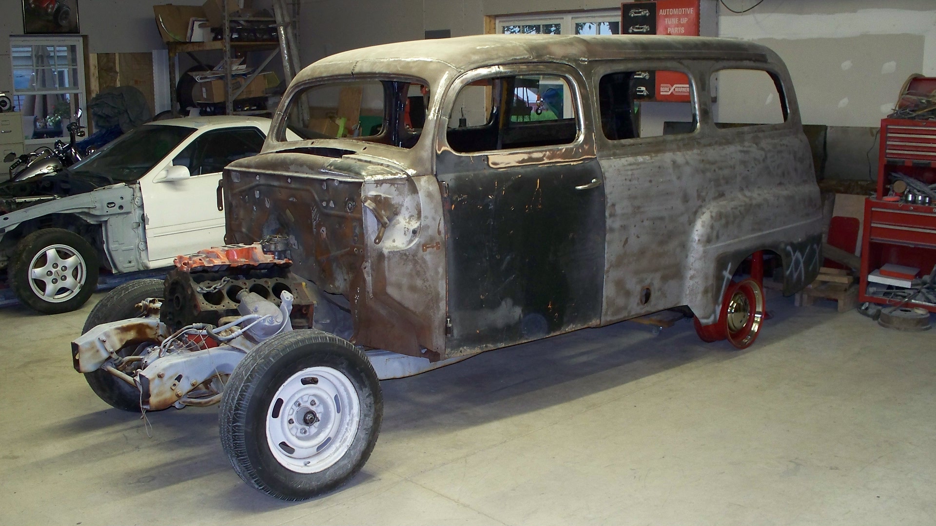

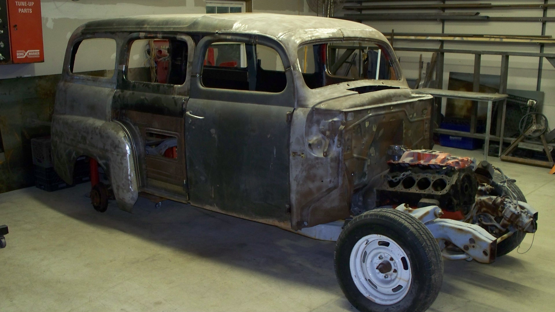

    Have you ever had a crazy idea and actually tried to make it come to life. This is one of those.

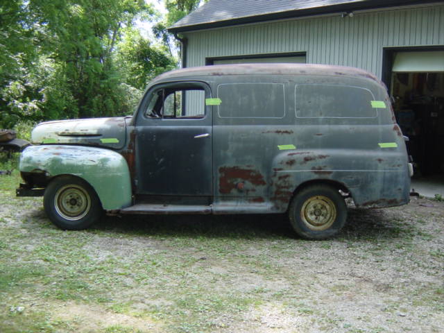

    Ford never made a suburban style truck until the 70's or 80's. I'm trying to make a suburban ( Expedition ) out of a 48 Ford panel truck. The first pic is the truck I started with....not the cherry by any means.
    The idea was to build a truck that could really be used. It's for my wifes uncle and they plan on using it almost daily. There's an extra door added to the passenger side to make getting in and out of the back seat easy.
    It took 6 doors not counting the ones already on the truck to make it work. I used the door tops to make the window openings. Trying to make it look like Ford would have.
    The roof is a 57 Ford station wagon roof. It helped get rid of the high crown the panel truck had. It looks chopped a good bit but it's only chopped 2 inches.

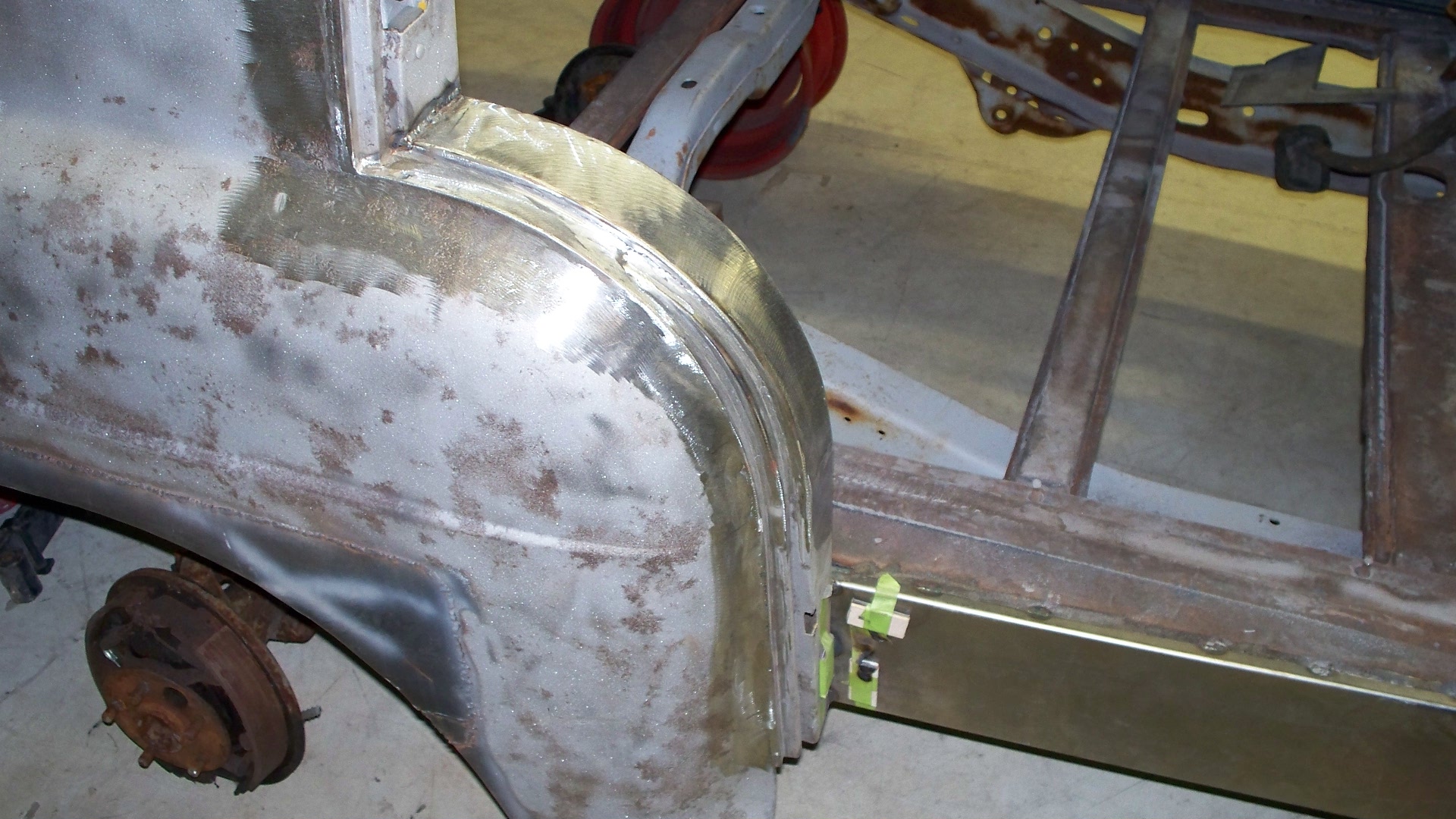

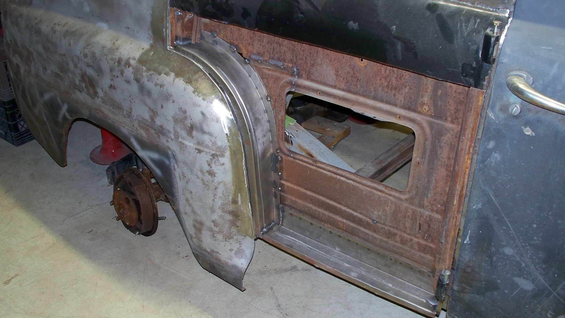

    Here's some pics of the extra door and the new jamb for it. I still have to skin it. It's a lot easier to make the guts with the skin out of the way.

    Ralfs...the roof is partly 57 Ford station wagon. It took 2 times to get it right. I was hoping the curve front to back would work....didn't!
    I had to roll 1x2 tubing to the correct curve and gut the wagon roof so I could recurve it to match the body.
