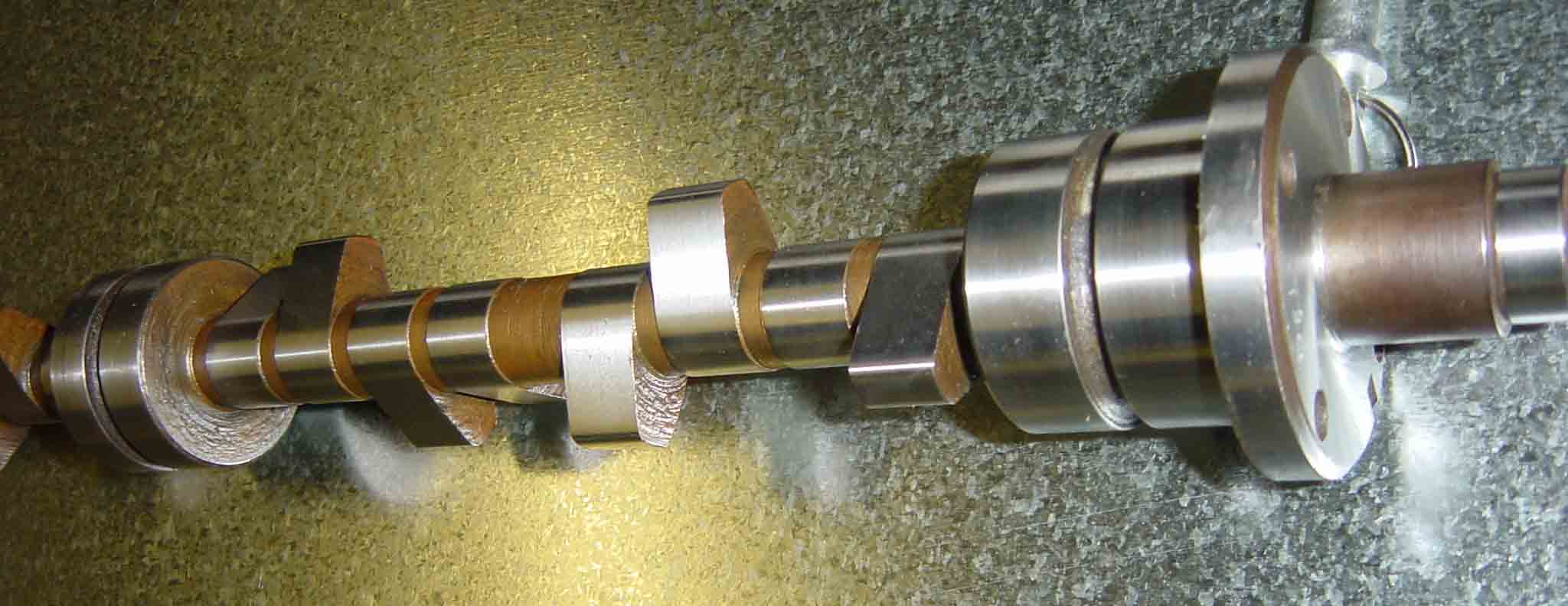

    Hi Gang: Just wanted to share a fun Ed Isky story with you.
    The story is about a cool dude (Ed) a flathead obsessed kid (me) and a couple cool cams -- one is the legendary Isky 404-A, radius lifter cam, the other is one that was a special "Ed" project . . . a big-brother to the 404-A, which is the 505-A. Here is the scoop . . .
    How the Isky 505-A Cam to Be:
    I used to hang around Isky's shop in the early 80's -- was always working on new flathead cams, and Ed, his sons and T. Willy used to put up with my stupid questions, my cam charts, ideas, etc.. Ed and I used to talk flatheads all the time. I even managed to get him to build me a couple custom roller cams -- as long as I made the billets, he'd grind them (and he did).
    Anyway, one day he tells me that he actually made a "505-A" radius lifter cam -- that had a .505 lift. I asked him how the hell he did that (given the base cirlce of a flathead and the bearing size) . . .
    So Ed says, "I made a 8620 steel billet that had larger bearing sizes -- so I could take the bearings completely out of the block and run it directly against the cast iron. Heck, people have done that for years with Model A's, no big deal not having bearings. It has a huge lift and a huge duration. "
    So I ask Ed . . . did you ever run it? Who did you make it for?
    Ed says "I made it for a racer named Jazzy Nelson . . . he ran it at the dirt tracks and it really ran.".
    So I asked Ed . . . did you only make 1? He said "I only finished one, but I made two others that were done to the first grind, but not completed. They'd already been heat treated and needed the last finish grind." (about the last .030 or so).
    So I say . . . what did you do with these other two?
    Ed says "I lost em! They're somewhere in this dang manufacturing plant - haven't seen them for 20 years . . ."
    So . . . everytime I'm walking through his plant - I start looking for flathead cams - stuck someplace where you wouldn't see them easily. If you've ever been to Isky's . . . there are piles of stuff everyplace even in his car.
    So . . . one day a year or so later . . . Ed and I are walking through the plant and I spy the ends of two flathead cams, sticking out of some dark hole, crap stacked on top of them for years. I go and grab one and said . . . hey Ed, I think I found the 505s! He grunts and says, not a chance. So I lift one up, dust it off and see that it was billet and Ed says "I can't believe it . . you've found my 505's!".
    Just as he said, they needed the last finish grind - so you couldn't run them. So I ask Ed . . . "Hey Ed, can you finish grind these?". He said "Nope . . . don't have a small enough cam grinder to handle that profile and flank pattern." I was a bit bummed, but he says hey "Here, I'll give you one, since you found them . . . I'll keep the other".
    So . . . I had this unfinished 505-A all these years and recently I was talking to another flathead cam grinder friend, and he got all excited when I told him about this cam. He said "I'll finish it for you . . . if I can have it for a few days to checkout/record the pattern" . . . the deal was done . . . and 35 years later, this cam is finally finished.
    I mapped the cam profiles on both the 505 and the 404 for comparison - here are the general specs:
    Isky 505-A:
    Lift: .515
    Duration @ .050 = 250
    Lifter = radius
    Isky 404-A:
    Lift: .420
    Duration @ .050 = 218
    Lifter = radius
    Here are pictures of the cams - as well as the "jig" I made years ago to map profiles and compare one cam to another (via graphs I make).
    Hope you enjoy them:

    a) The roller cams that I built were .420 and .440 lift and I believe about 270 duration at .050. I have the specs at home -- will checkout the profile maps, etc.. There is lots to know about roller cams -- especially the profiles and advance issues with flatheads versus overheads. I've done quite a bit of graphcs and research along this line - I believe that there are good ways to make flathead rollers . . . and bad ways. Crower is the only guy that I know that will make lifters -- probably in the $500 - 700 range for a set.
    b) Other cam grinder: I'll check with him - to see if he is up for it.
    You can't grind the cam on a stock core - you'd need an 8620 billet core and about the only guy that has these for sale (unless you know how to make them on a lathe) is Joe Panic at Rotophase. At least he used to . . .
    Also, you then need to have a set of keyed radius lifters -- which Isky hasn't made in many years. When I had the 505 finished, he made me a set of radius lifters - out of Henry's originals (which is how I believe others made them). I believe the lifters cost me about $500 . . . and I was damn glad to have them.
    If you want to chat and have a particular application you're pondering, let me know and we can always chat on the phone.

    I just found a better picture I have of the 505-A (before I covered the damn thing in lube) -- this really shows off the radical profile.
    Acceleration Ramps:
    One of the things that is interesting is that when you design cams and determine the "rise" of the ramps, you have to be concerned with the acceleration of the ramps and how many thousands the profile moves the tappet - per degree of cam rotation. Back when Isky made his radical flathead cams, about the max you could rise the profile (per degree of cam rotation) was .010 - this occurs midway on the ramp. The 404-A has a max value that is exactly .010. T. Willy (good friend who worked the counter at Isky's) told me that anything over about .010 to .011 was a big problem - as the dynamics became fubared, float started, etc.. The valve springs just weren't good enough in the 50's and early 60's to take acceleration ramps faster than this.
    So . . . the fun thing about the 505-A is that is has a max acceleration value of .013 - which means that it was almost impossible to keep the valves from floating back in the day - without terrible spring pressure and probably bending the cam as a result. (One of the reasons that dual springs on high-lift flathead cast cams is a bad idea). Remember, there are only 3 bearings - ever wonder why it is hard to set the valve clearance on a big race flathead cam - it's because the damn cam in bending!
    Given today's valve springs and very light valve materials - like Titanium valves, we can probably keep the lifter tracking on the cam . . . and make the dang thing work. This is what intrigues me . . . I just want to see how it runs.
    This cam will never idle below 1200 RPM, but it should have a sound that is unique for flatheads. I have to create a "special" engine to run this -- one that will do it justice. I'm thinking about building a big stroker motor, with Baron heads and pop-up pistons, 4-71 and other fun. I need to finish a couple other engines first - and find a dyno, but I just have to hear this cam run!
    I'll update you guys on some other fun cam stories . . . and I may create a software program that compares profiles/graphs - you guys would like to view the data. Fun stuff . . . I'll keep you posted.
    Here is a picture that really shows the profile - imagine trying to keep a lifter tracking on that . . . at 6500 RPM! Yikes!
    Enjoy . . . I'll post more in the coming weeks about cams and other such fun.

  29. from the picture it almost seems like the cam has an inverse curvature on the face (but it could be the lighting) yet from what you have said about the cam, with its lift and compartively low rpm operation, that type of profile would allow Isky to get a great deal more lift out of the cam with lessening the tendancy of the cam to throw the lifter over the nose.
    thanks for the great story!
