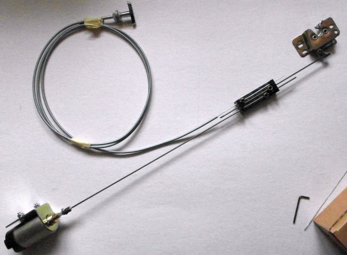

    Thanks guys appreciate your interest. The trunk latch is original 50 Ford while the operator is all custom made. solenoid via several web sources, manual operator via most automotive stores (universal push-pull sometimes sold as manual hood release cables) push rods custom made from stainless rod stock and plastic (bridge) is some weird type of strong yet slippery stuff available at most material supply houses as U channel (only need an inch of this). The plastic bridge piece will 'lay' in a section of 1½" aluminum U channel so that there are no possibilities of getting 'snagged' in the trunk carpet/liner or other stuff as it moves back and forth to operate the latch.
    Regards, Bob

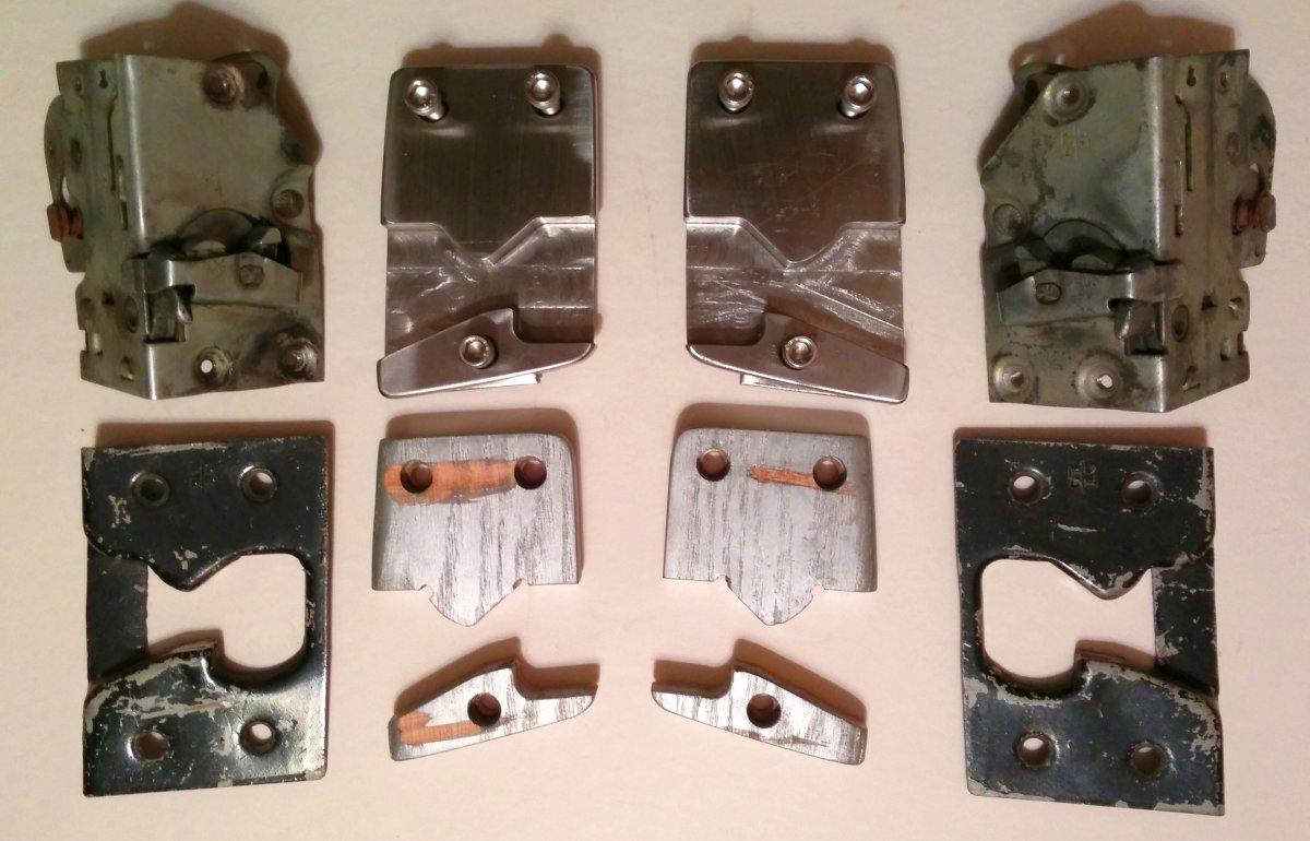

    Larry (Alex Machine - Loves Park, IL) has finished creating the new latch plates and I picked them up yesterday for trial fitting. Currently have the doors blocked open to drill the flexible conduit holes to match up with the pillar holes that were in the 50 doors, for speaker and popper wires. Thought I would show the progress on the door latch plates. I had previously posted a couple of shots in the test fitting of the prototype latches but will show the progression completely below for any of you that are facing the same dilemma (whether to cut and fit the 49/50 latch into the 50/49 door or adapt the latch plates).
    We did this in two steps. First prototype latch plate had essential surfaces only
    Second prototype was full bodied concept intended for metal final parts
    second prototype showed us that we needed to thin down the final about 1/8 inch and slightly change the ramp 'drift angle' to match the angle of the latch 'tang' which rides up on it. The metal parts are ready for fit/operation checks and if all is well there, they will be cleaned up and either black oxidized or chromed.
    Above picture shows original latch plates, prototype 2 segments, door latch assemblies, and new custom latch plates ready for test installation. Best regards to all. Bob Bertolasi
