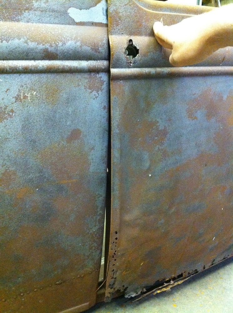

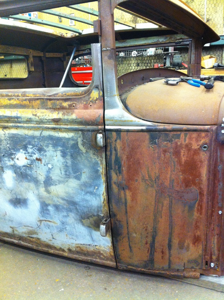

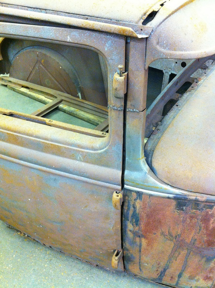

    I started by trying to get it square before anything else.
    I swapped a better door, massaged the hinges (they were tweaked), and aligned and braced the body once I got the doors and body lining up...

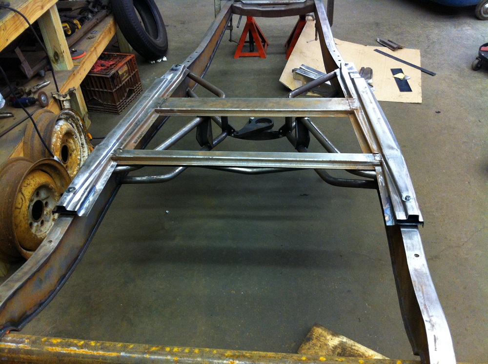

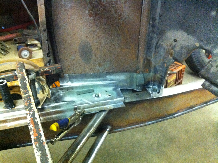

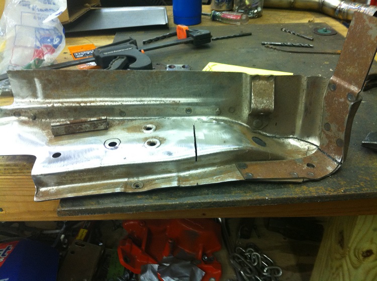

    I decided to fit the subrails to the frame first. So, I cut off the back of the subrails to clear the 32 kickup. Then after lots of measuring, I located the front of the floor (this is really critical, because this determines everything...including how the rear tire will sit in the wheel well!)
    I boxed the underside of the subrails around all mounting points.

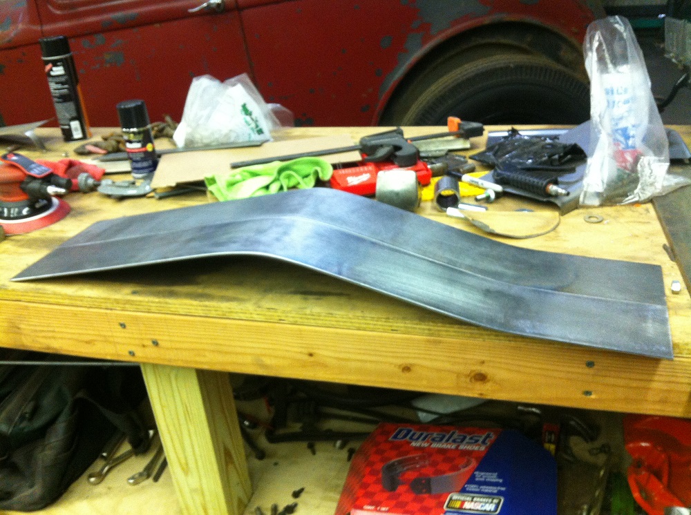

    I then shaped some cold rolled flat stock to the rear kick up...

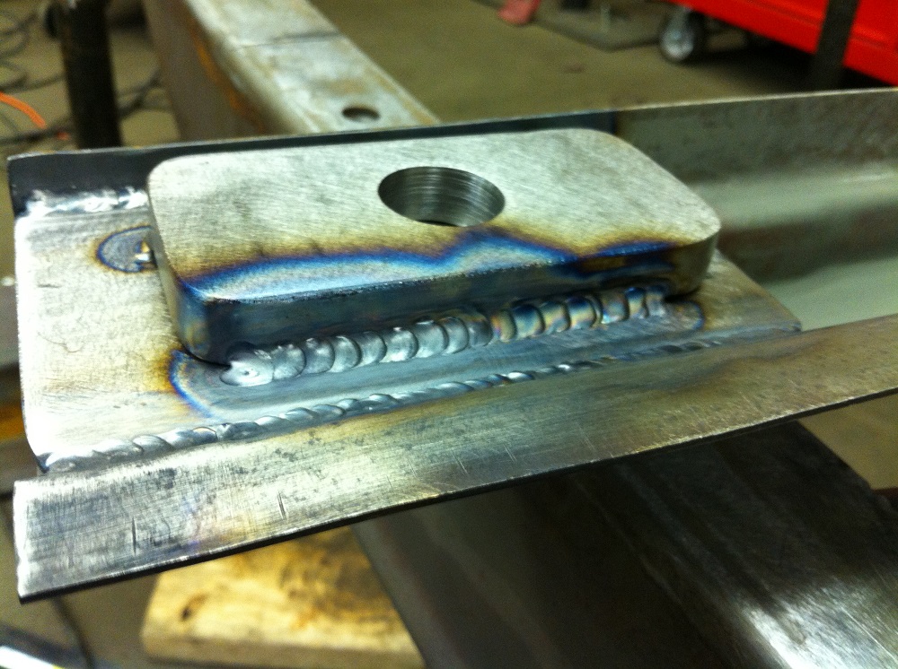

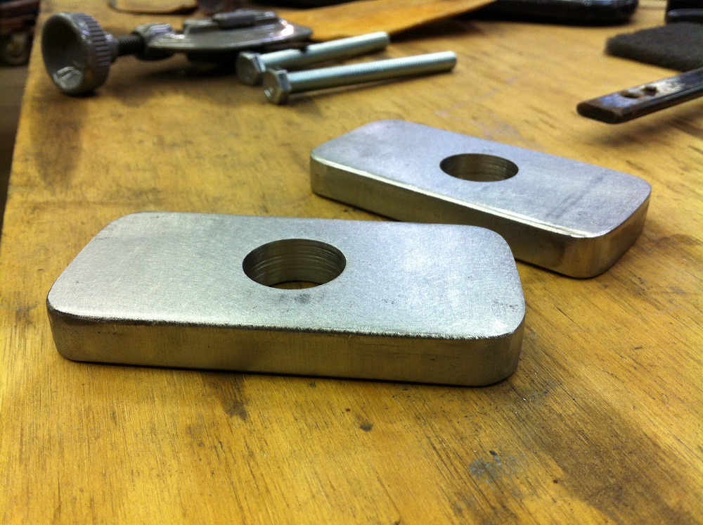

    made some mounting pads on the underside of the new subrails.. 17.jpg 18.jpg 19.jpg

    Next was to start blending the transition between the factory and new subrail pieces...
    I started by widening a factory crosspiece...
    Here it is after widening and fitting...
    Then welded...and a sleeve added for the mounting bolt to pass through...

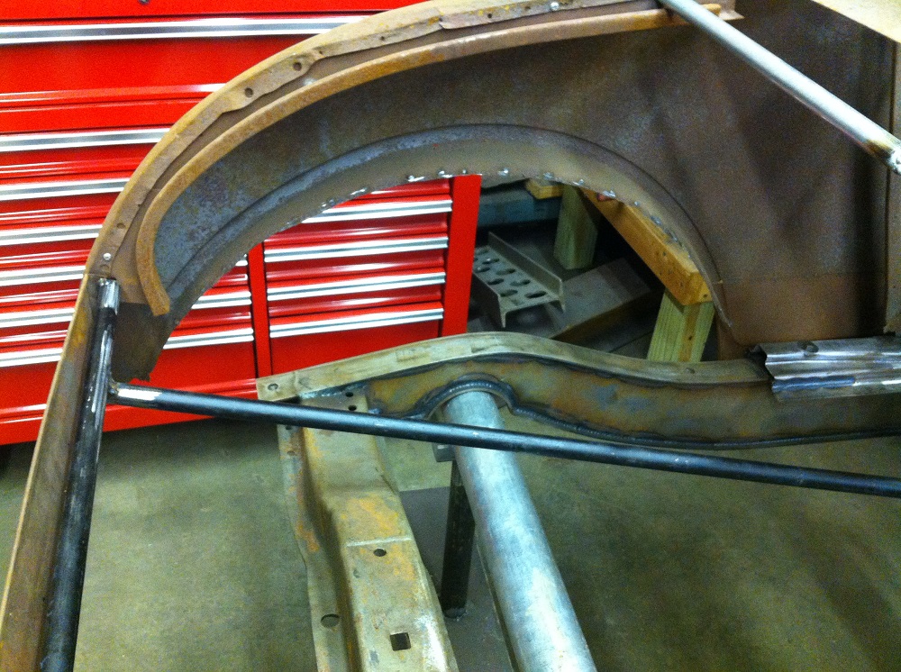

    the wheel wells were next... and were challenging with little/thin metal to work with...
    I'm really happy with the way it all flows from this view...
