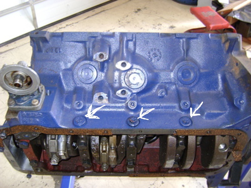

    If it a 1963 block it will be a cross bolted block like the 427 block. Just above the pan rail you will see 3 bolt with I think are 11/16 heads. These bolt hold the number 2, 3 and 4 main caps.
    Picture of a cross bolt block

    Good info for guys looking at FE's, one of the hardest motors to ID from the outside! If it doesn't have those 3 obvious (and much sot after) bolts along the bottom on each side its a crap shoot for the most part. Nobody ever mentions the 360 truck motors which were the "390" 4.05 bore with the "352" 3.50 stroke. You can ID these quickly by a "half-moon" cut in the crank flange.
    Look for this when buying a FE, although I thought they were decent motors myself....

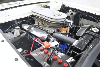

    Here's one

    Well, for all the naysayers, maybe it's a small-block, "I think" etc., and my personal favorite those who can't read in the original post "406 crate motor"- I was just looking thru one of my old Hot Rod's- February '64 in fact, BTW the same issue with the first "drag test" of the Fairlane Thunderbolt- on page 4 is the monthly Vic Hubbard ad, and one of the featured specials is:
    "FORD 406 ENGINES
    New! Tri-Power aluminum intake manifold (3 carbs) and Holley carbs.
    Complete (less starter and generator). Limited supply. (FOB Hayward)
    ....................................................................................ONLY $650.00
    For boats.....................................................................ONLY $625.00"
    Guess that qualifies as a "crate engine", even though those weren't cool buzzwords back then :p
    Installation of the 406 engine did not stop with the introduction of the 427 in mid-'63, and there are quite a few 63-1/2 "fastbacks" out there with 406's, like this original one-
    http://www.youtube.com/watch?v=7KByCp9dK5o&feature=related
    Although the postings that claimed 1-1/2 years because it was no longer installed when the 427 came out were incorrect, technically the 1-1/2 year timeframe is correct, as the 406 (and the 500XL model of the Galaxie- my hardtop is both a G-code 406-6V and an XL with manual steering and brakes, 80K miles and original black paint) came out mid-year '62, just like the "fastback" body and 427 in mid-'63- neither the 406 engine nor the XL model are covered in the '62 Shop Manual as they weren't in production yet, and there was a "supplement" for the new 406 engine
    The holes in the side of the block that get some excited are just there for the factory machining fixtures to hold the block when it was machined, and there were also holes in the FT blocks that were just an oil drainback hole for the truck air compressors- have nothing to do with cross-bolts.
    The "shortie" cast headers came on hi-po 390's from '60 and 406's, '63-'64 427's (and probably a few 406's, as the original casting numbers were "C2's") got the long ones, with '65-'67 Gals getting a different "long" set for the new chassis
    And there was at least one '65 'Bird with a factory 427 engine, saw it myself in '74. My roommate's dad was a district service engineer for Lincoln-Mercury working out of the center in Richmond, and kept telling us about this red "Engineering" 427 'Bird they had that was supposed to get scrapped, but one of the execs ended up with it, and lived around Yountville. I was working up there in town, and heard it coming before I saw it, solids and very strong but half-loud exhaust, bright red and had the 427 flag emblems on the front fenders where the '62 Galaxies had them, behind the wheels. A guy in his '50's with horn-rim glasses was driving, saw me staring at it, grinned, and nailed it from the stop sign- lit out pretty good, and sounded soooo sweet :)
    Roomie's dad brought him home a nice toy to play with in '71, a 429SCJ Cougar XR7 ragtop, white with white leather interior- he hauled one of the gals in the St. Helena Homecoming Parade in it
