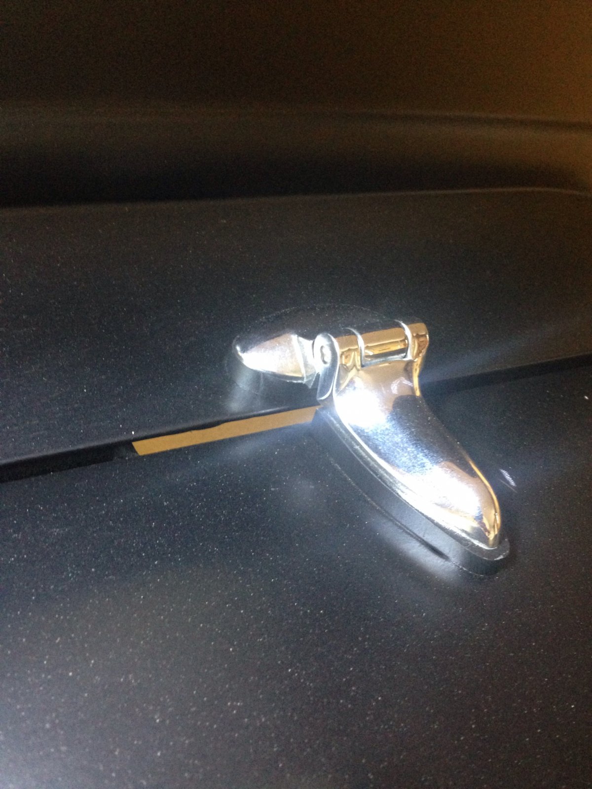

  8. mr.chevrolet
    Joined: Jul 19, 2006
    Posts: 8,875
    mr.chevrolet
    when I got my coupe these were on it. hope you can make them out. yes, I'm keeping them.

    I used some kinda early 60's british car trunk lid hinges
      315.1 KB
      385
  12. Cobra use British car I think tr3 as well wich i have tried
  13. Mg has more curve than tr3 did you pull the studies and grind them flat? That's how I ruined my tr3 hinges cause I thought it would work
