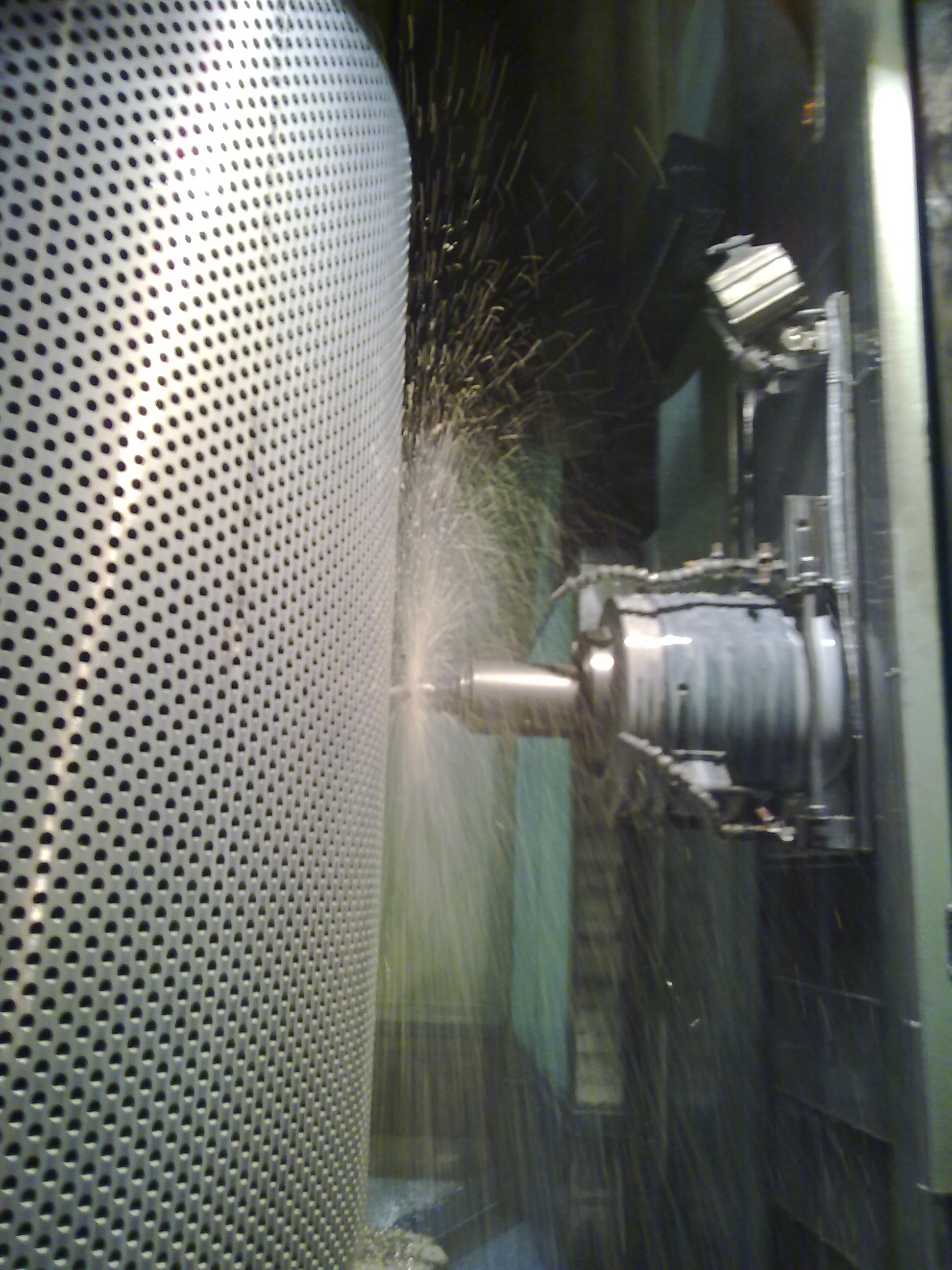

  9. I use drills mainly in CNC mills and the Bridgeport. The CNC mills use water-soluble coolant, I'll use the same with a brush on the Bridgeport, that also has a flood coolant set up on it.
    I've been using the above formula for years, cut the resulting RPM in 1/2 for reamer use.
    If a hole has to be accurate I give it a pilot hole first and step it up if I have to. Almost anything over a 1/4" gets a pilot hole as well. Really extends the larger drill life and doesn't add that much to a program.
    Bob
