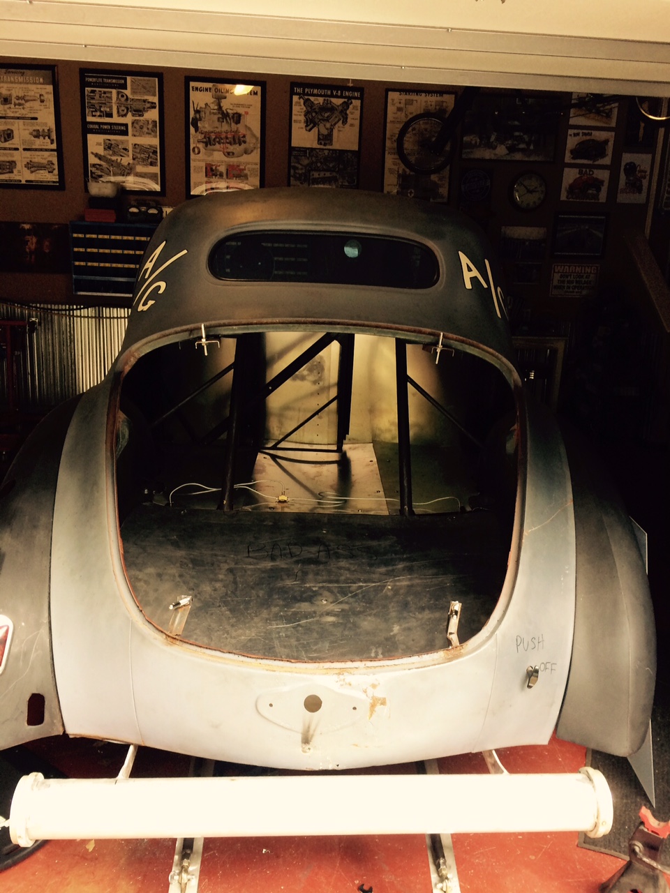

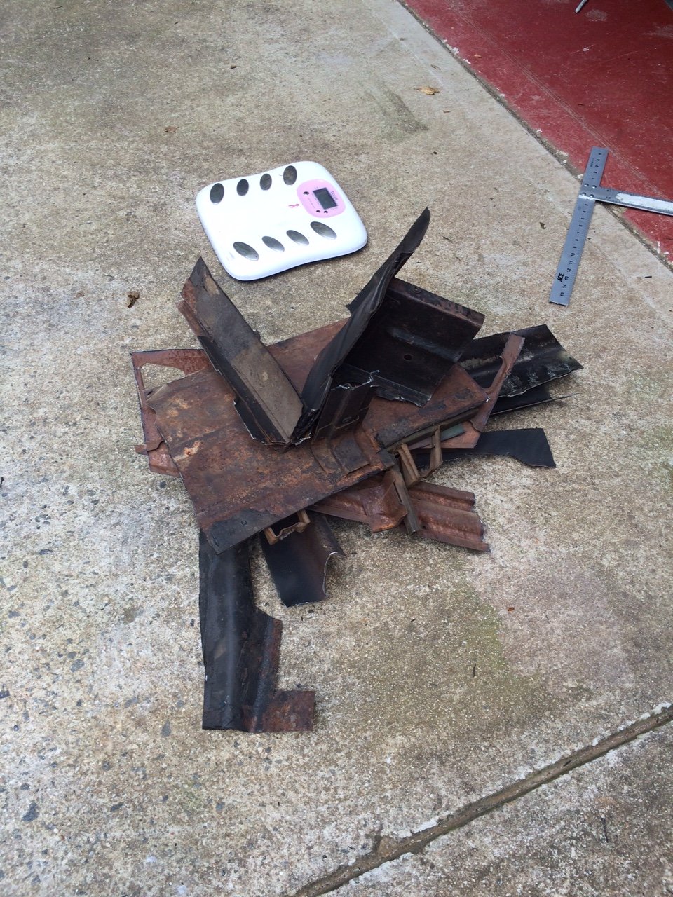

    Cut the remainder of the floor out that wasn't doing anything anyway. 23 pounds :rolleyes: think the easy weight cutting is all done :confused:
    Kim is out of town so ... her scissors are mine .
    The aluminum bumper is 7 pounds ! :D
    But this was like 5 pounds :confused: it will help on the top end maybe

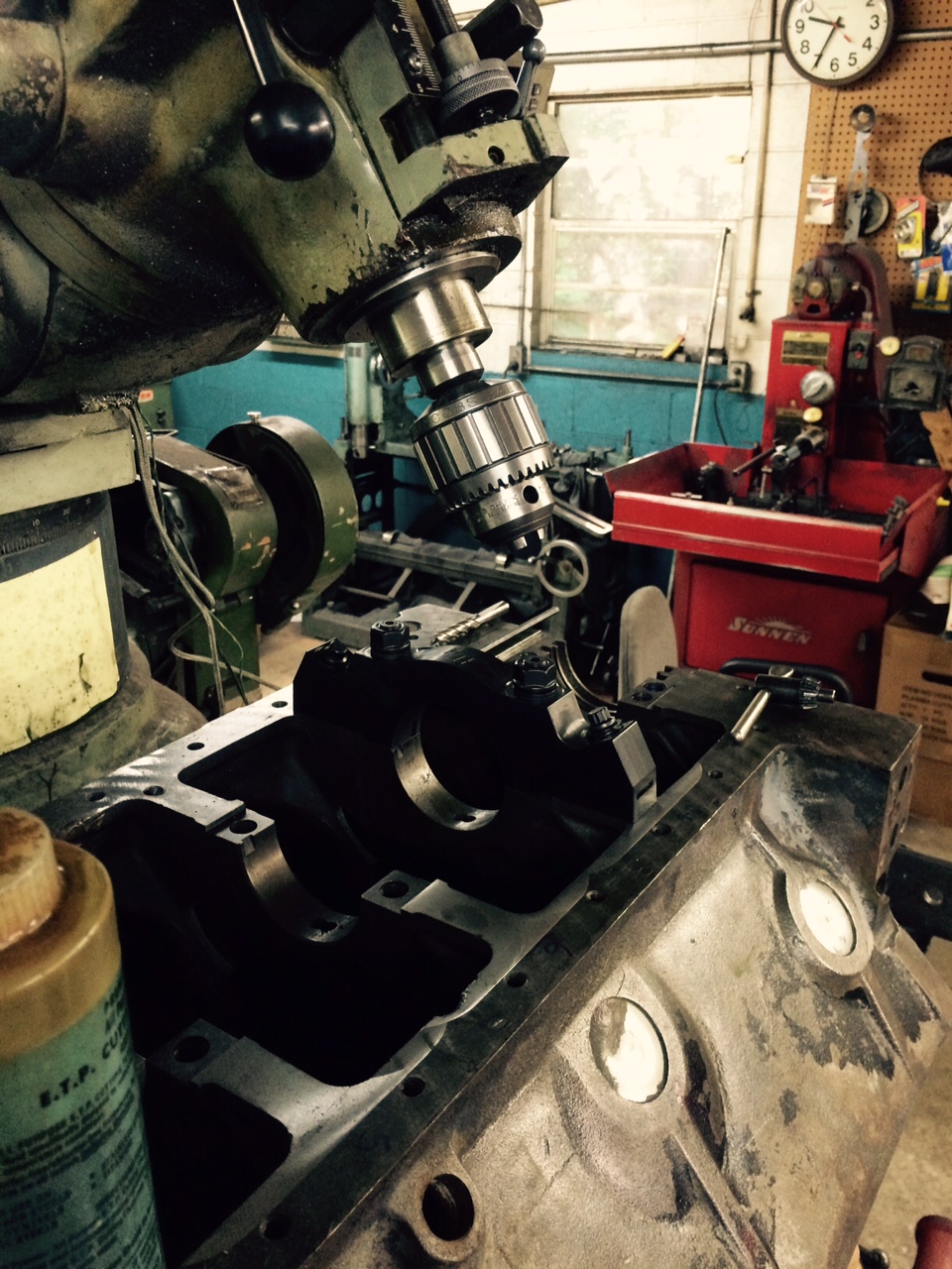

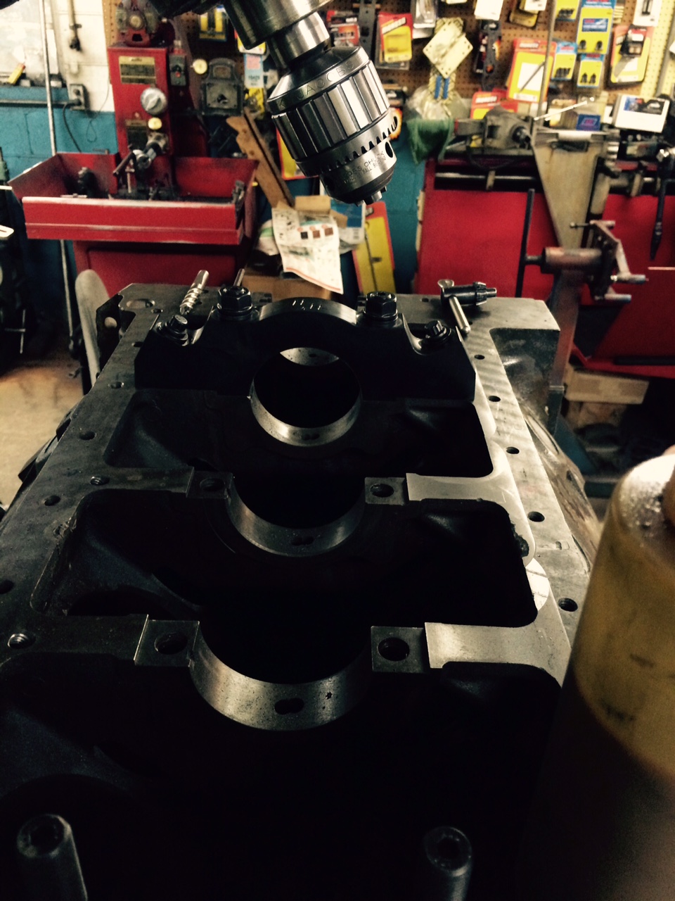

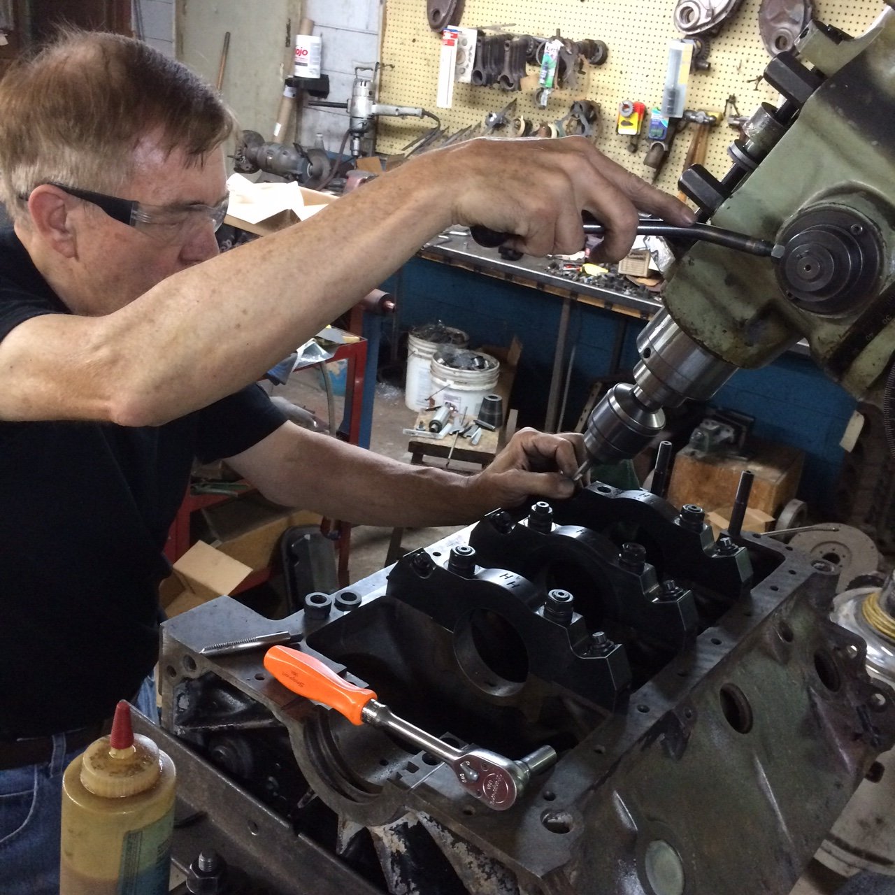

    Went to see Johhny Thomas today - he was adapting the 4 bolt steel caps to the 392 Hemi block. This is the block that will have the 5/8 stroker crank. He was showing me all the steps he had to go through to get these mounted. This is a ton of work. He wondered if everyone put this much effort into mounting these things correctly. Because there is a lot of room to get sloppy or lazy doing this - he was not going to go that route. Said it wasn't cheap though :p hey man its a hemi its never cheap.

    I can see that there's room for sloppiness on that main cap change, are they aftermarket steel billet or off some other engine, or what?
  18. Those caps are Hot Heads steel billet. Milodon makes a set also but Bob has all 5 caps. I don't think Milodon makes all 5, just the centers. As often as I miss gears, figured it best to make it as strong as possible ;)

    Would the block then need to be align bored now? Or would it need align boring anyway with aftermarket caps that haven't been on the block yet anyway? Also does he believe in using torque plates when boring the cylinders?
  21. Yeah I dropped it off for quieter mufflers to be installed and I think they are using it as advertising . I better have it back tomorrow to load for Shady Side :eek: I'll tackle a lot of stuff but mufflers are not really one of them.
    Yeah he is align boring and honing the mains and cursing some :confused: . He loves torque plates - got any for a 392? This discussion always ends the same - "Ask so and so for his plates" "He loaned them out" What now? So far none of my hemi's have had plates.
    GAOldsman likes this.
  22. Sorry, no torque plates for a 392, but with them is the way to go if possible.
