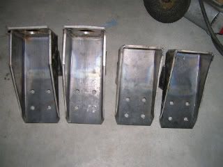

    I've been working on the running board and bed mounts. The r/b mounts are 1x2 channel and the bed mounts are 3" tubing cut on a bias.

    This rocks, and all of you guys should go there to check out his bracket design/blueprint/diagram!
