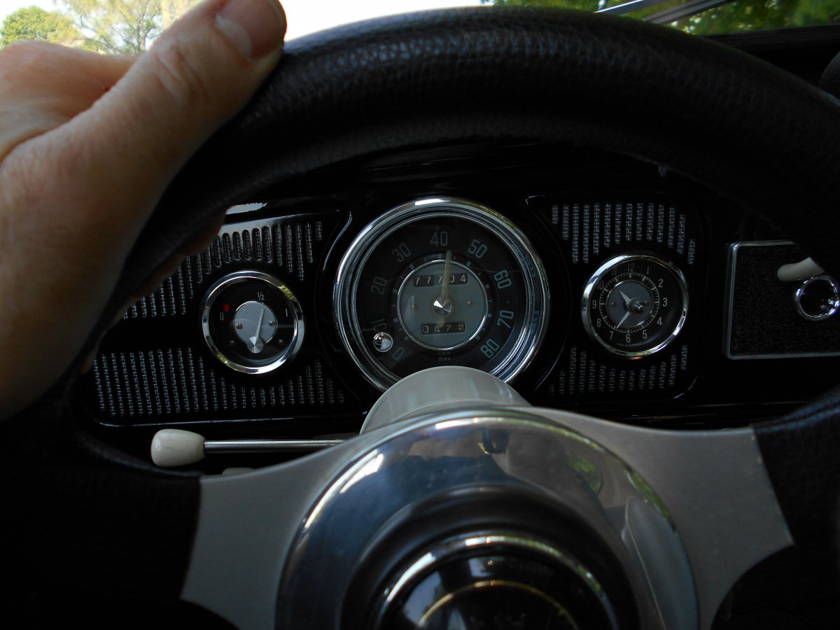

    Wow, that's quite a gauge collection! This thread reminds me of the old Motometer accessory gauges for the early VW's; they command a pretty big price these days that was well beyond my reach, so I made my own. I took a pair of VDO gauges from a late-sixties SAAB and machined a pair of center pieces to match the speedometer out of stainless steel with a painted insert to cover the SAAB label. For a more finished installation, I also TIG welded the grilles and laid out the gauge hole. Keep us posted with your installation; I'd love to see how you did it. DSCN0006.JPG
