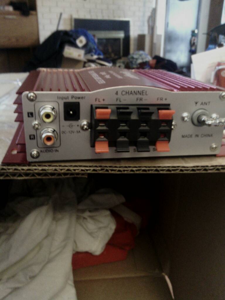

    So I got this little guy on eBay for 15 bucks it's an FM USB AUX all in one stereo I didn't want to pay 300 bucks for the hidden audio ... Because I'm a poor white boy... so I thought this little gadget was pretty cool works real good too! It has an amp built into it so that's nice and its four channels by 40 watts 4x40 watts

    Yeah they're all over Ebay Kentiger...or Kinter ( those are the brand names) some of them are only two channel but this particular one is a 4 channel it even comes with a cool little IR remote! And my pocket knife is just a regular size pocket knife I'm putting this in the glove box of my 62 Newport

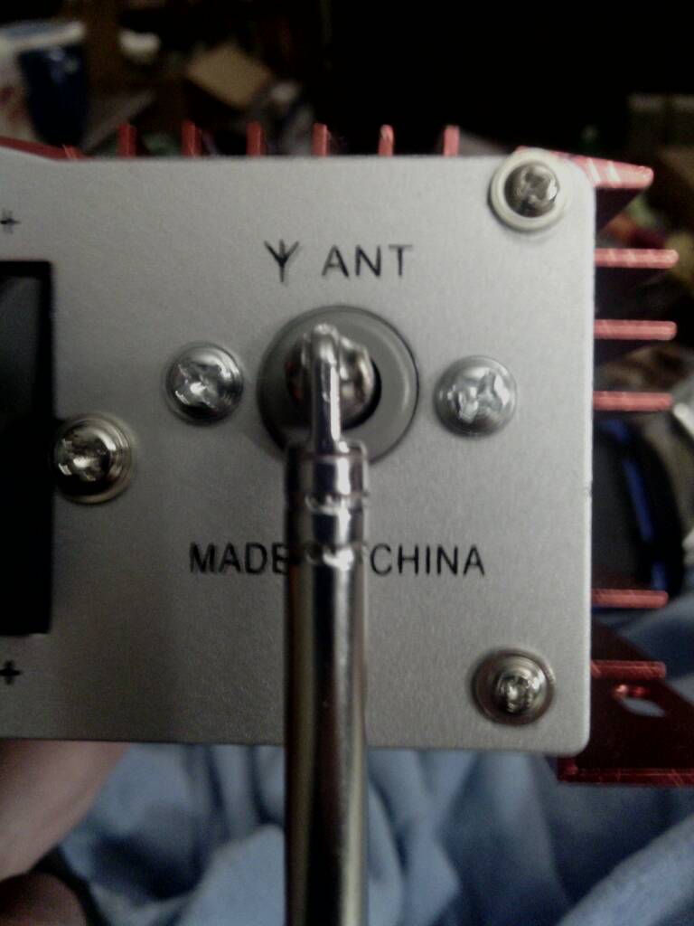

    Okay here's a little picture tutorial of how to do it.... So the first thing you do is remove the four Phillips screws on the bottom of the unit second find the long white wire that goes to the antenna (photo 2).. Unsolder said white wire then remove the 2 screws on the back where the antenna is then attach the Motorola connector(photo 3) PS you will need nuts to attach the connector to the radio... Then solder the wire to the solder tab / hole on the Motorola plug the Motorola plugs are available through American radio supply.com and they are 95 cents each

    I haven't done mine yet but I'll post a photo of it when it's done..... Here is a photo of the circuit board the long single white wire is the antenna wire
