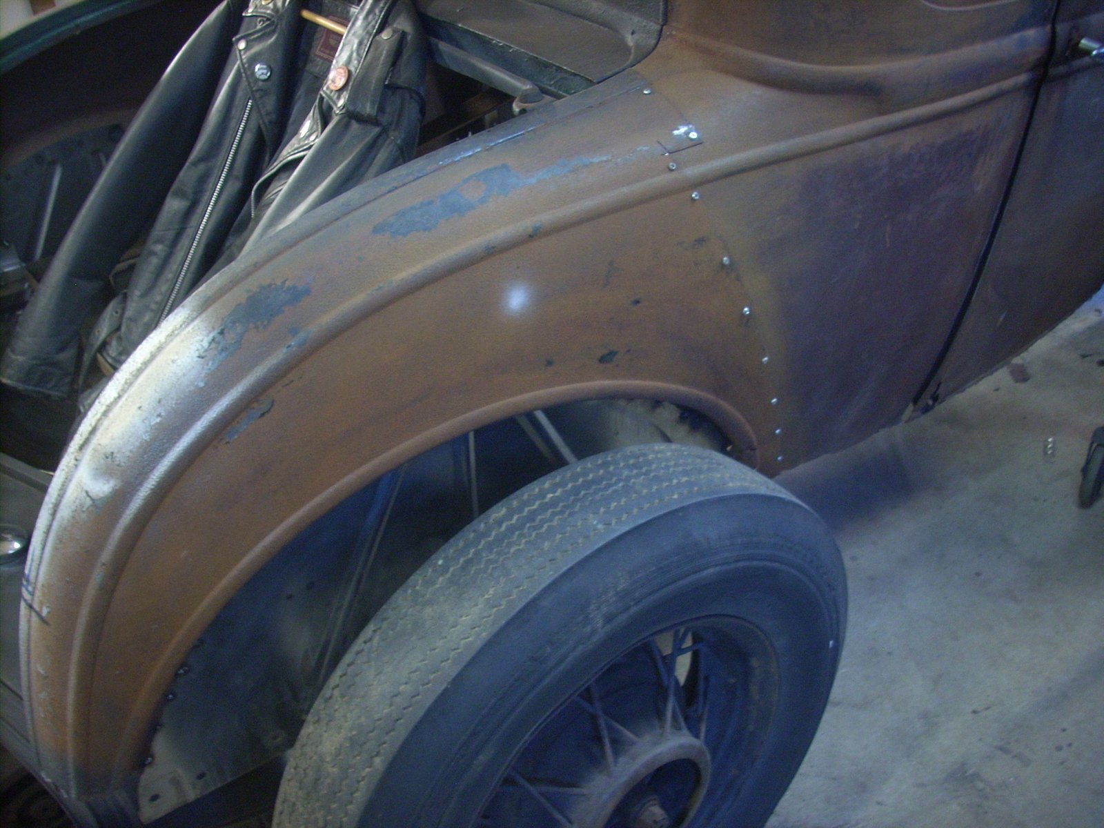

  6. mike bowling
    Joined: Jan 1, 2013
    Posts: 3,560
    mike bowling
    This is a rear 1/4 panel I "repaired". DSCN1842.JPG Cut the piece going in big , overlap it , fasten the overlap with self tapping sheet metal screws ( 7/16 framing screws) . Then with an angle grinder with a thin kerf disc, follow the outside cut in between the screws. Tack weld it , and work the seam as you tack every 2-3". When it's all stitched together, take the screws out and weld up the holes. I'm no body man, but it came out pretty nice ( sorry no pics of the finished product- sold the car). Good luck with it whatever your approach.

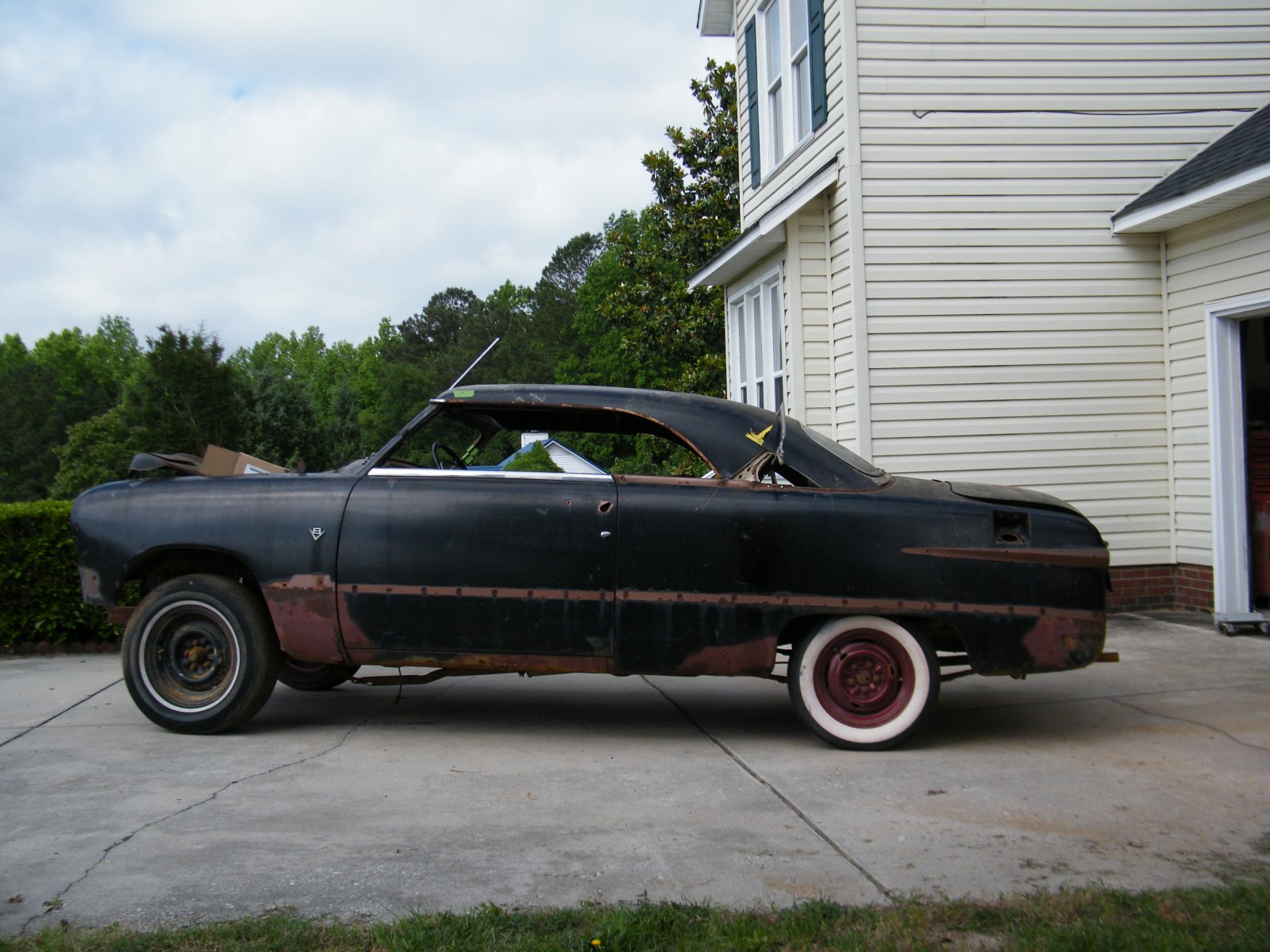

  9. sideswipe
    Joined: Sep 27, 2012
    Posts: 198
    sideswipe
