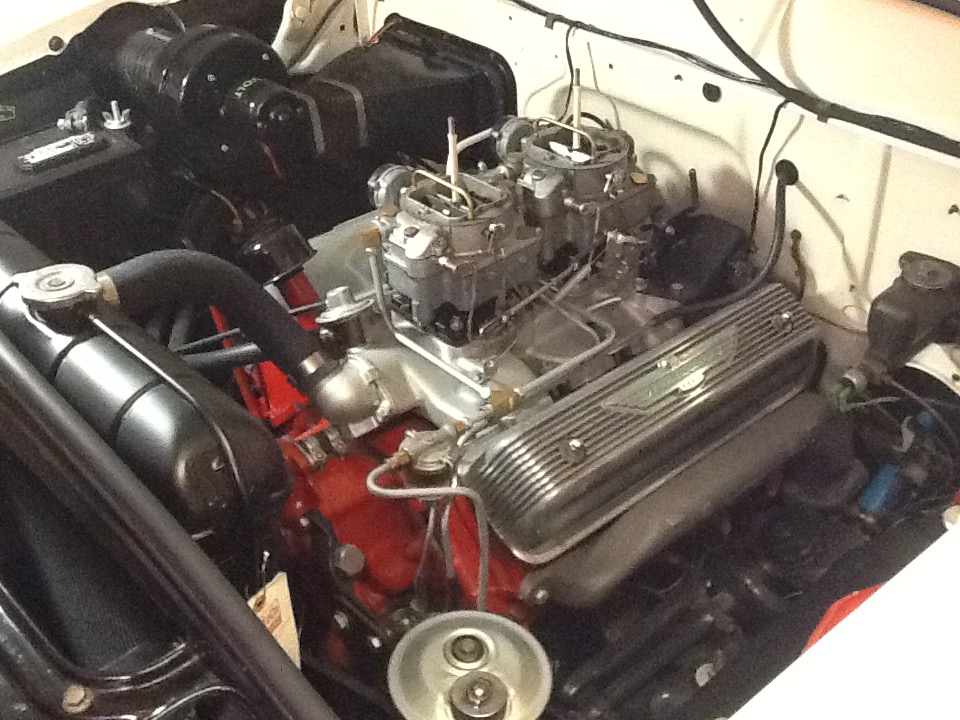

    These 2 have matching numbers. I courious as to why WCFB's were built with both aluminum and cast iron bases. These are aluminum painted black. Then I ran a single 1953 Cadillac ( iron base) on the stock y-block intake it was necessary to restrict the exhaust gas fron under the carb and run an insulator. I assume this was because the original Holley 4000 had the fuel bowl high up and the WCFB's were near the manifold. The fuel did boil. image.jpeg These both have 3/8" insulators.
    dana barlow likes this.

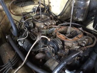

    I need some advice here guys, I have a WCFB on my 53 Olds, its been rebuilt by the PO but when I got the car it was flooding so I opted to do my own rebuild, I got a kit from www.carburetor-parts.com I replaced everything even the check ball and retainer which hadn't been replaced in the previous rebuild.
    The issue I am having involves two springs, both are missing from the carb and both are not included in the rebuild kit, but both these springs are listed in the exploded diagram supplied with the kit and also listed in the shop manual....they are the pump return spring and the vacuum piston spring. I spoke with the guy at Mikes Carbs and although knowledgeable he was a little vague, he said if it was running without them then it should be OK.
    I need to know one way or another, should they be in there or not? in the bag of bits that came with the car was the old parts from the previous rebuild plus one spring which is the missing pump spring...did the PO forget to put it in? or was he told not bother as it wasn't needed? and just to confuse me even more the third pic below taken from the shop manual shows the pump without the return spring underneath it (see pictures) IMG_20160212_142512.jpg IMG_20160212_142623.jpg IMG_20160212_152049.jpg
